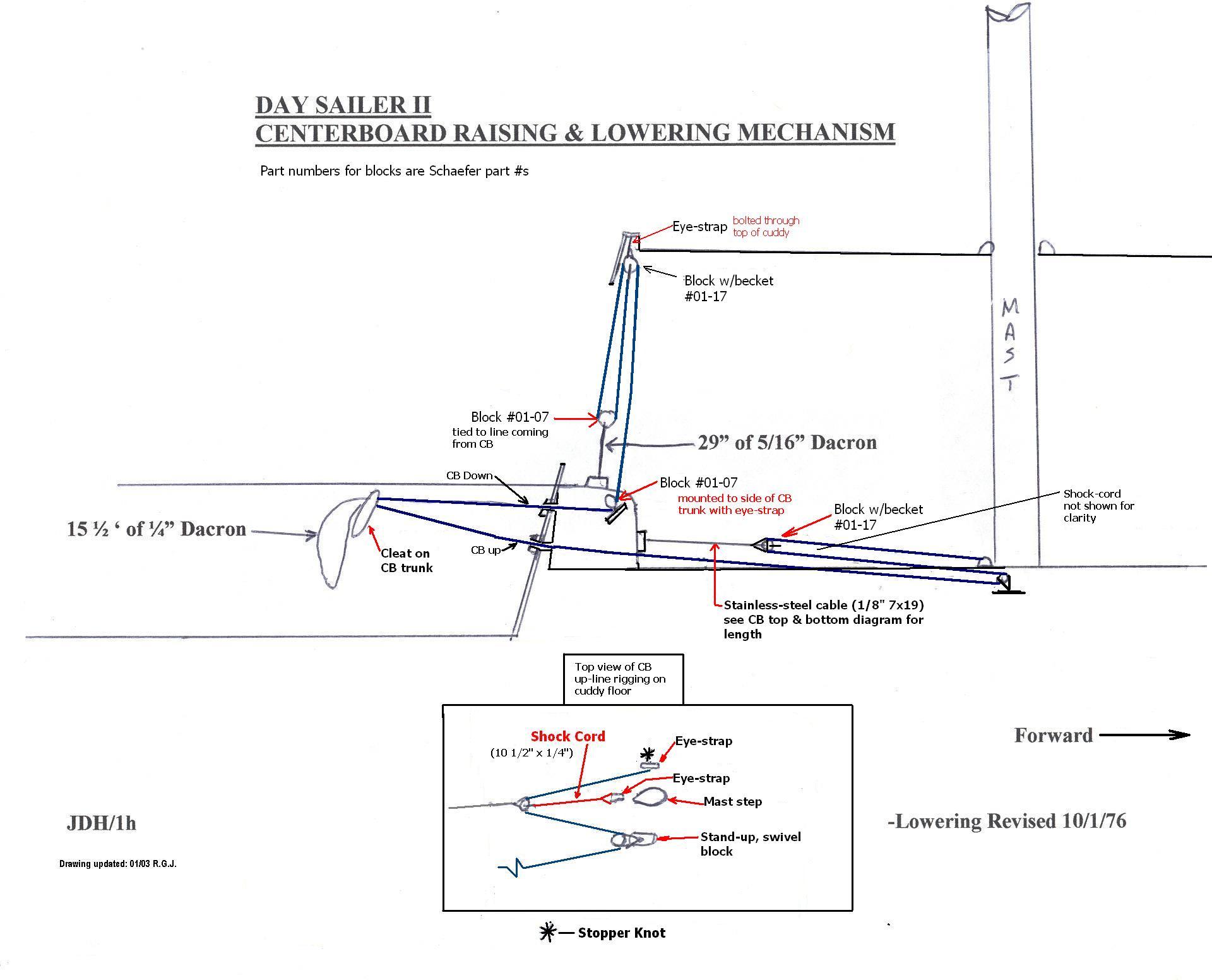

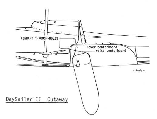

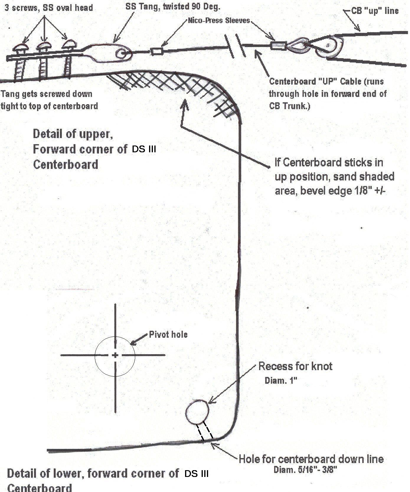

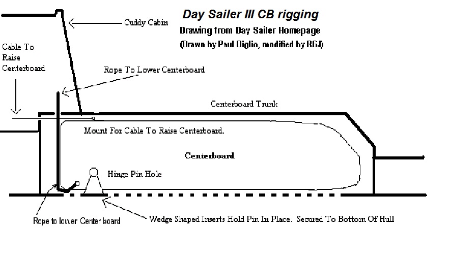

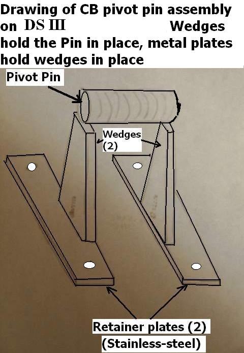

Diagrams of Day Sailer II and III Centerboard operation. The two versions used basically the same setup, on 1980-85 DS II and all DS III the CB pivot pin is accessed from outside the boat, there are two stainless-steel plates located one on each side of the CB slot, near forward end that hold in a pair of wedges that hold the pin in place. Let me know if you need more info, I have created Expanded Manuals for both the DS II and III.
