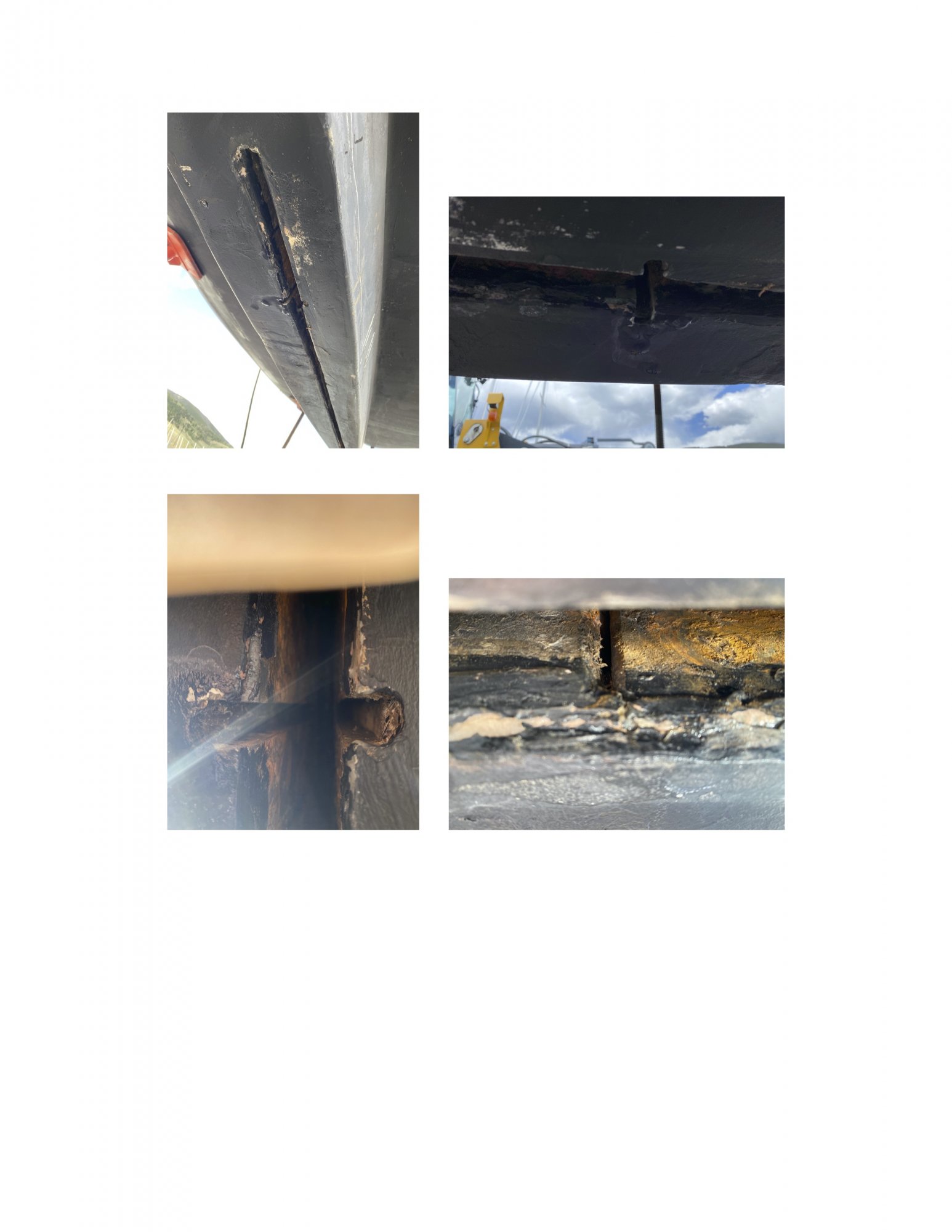

Finally got the S24 up on stands and am able to view the keel bottom. First off, the posted pics and description of how to remove the centerboard are different than mine. There is no slot in the centerboard nor a pin in the keel. Instead, on mine the pin is part of the centerboard and there is a U-slot in the lead keel to slide the centerboard up, over and down into its final resting place. I append a figure and a couple of pics in case someone else out there has a similar situation.

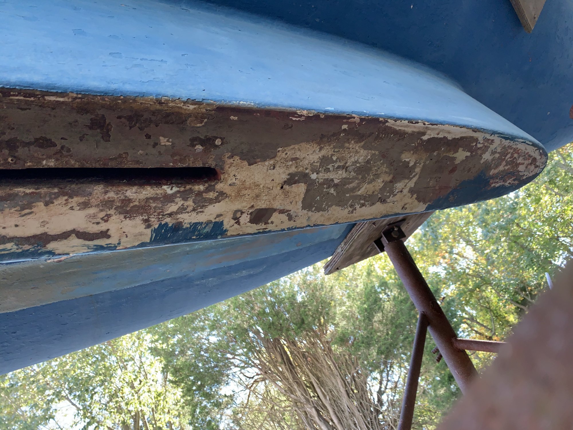

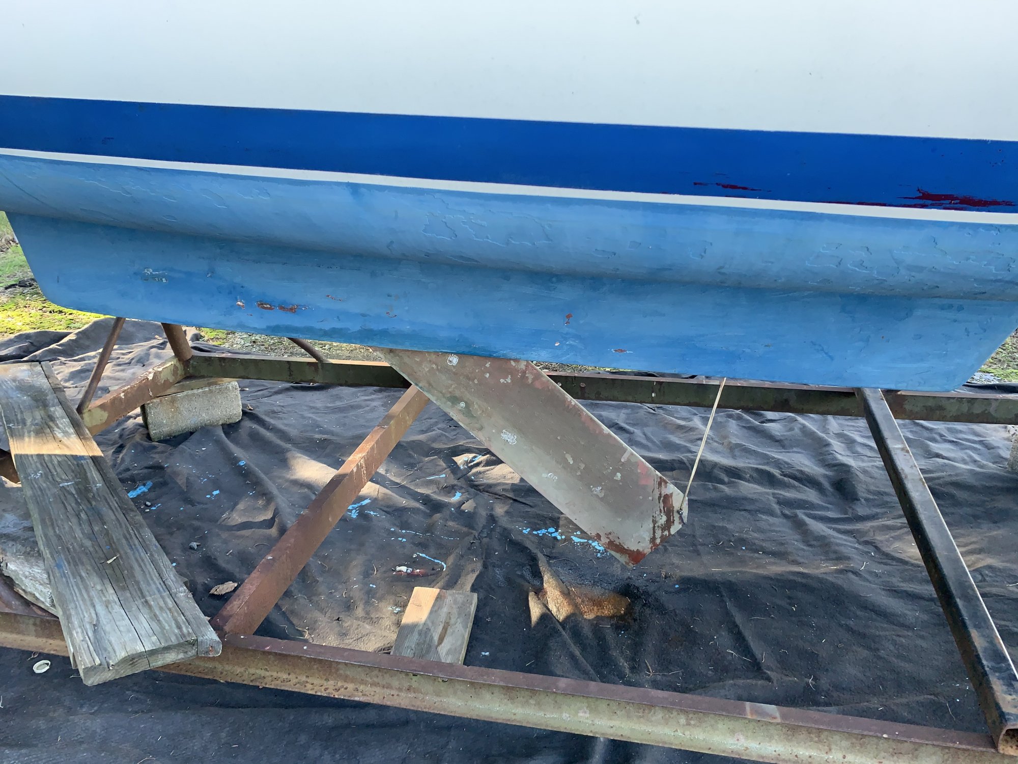

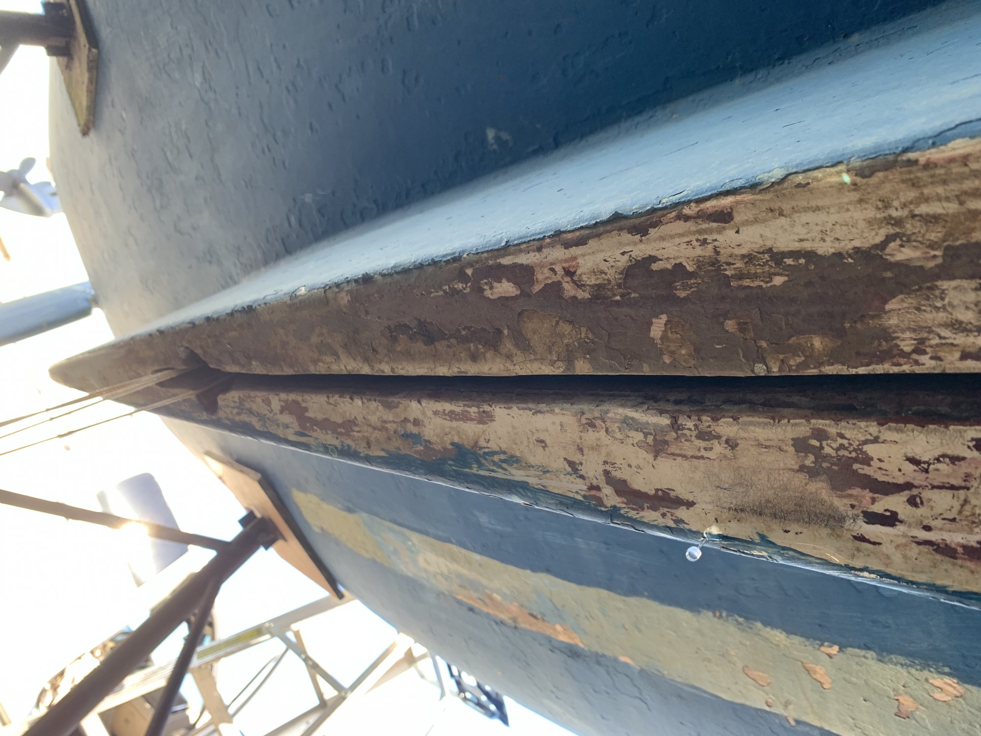

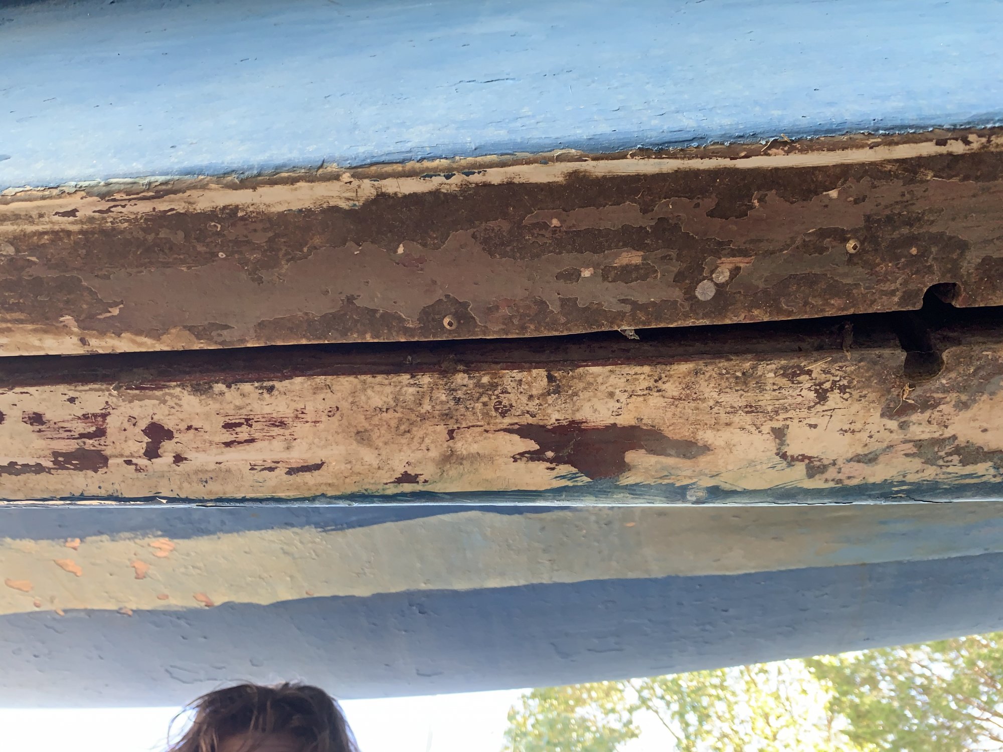

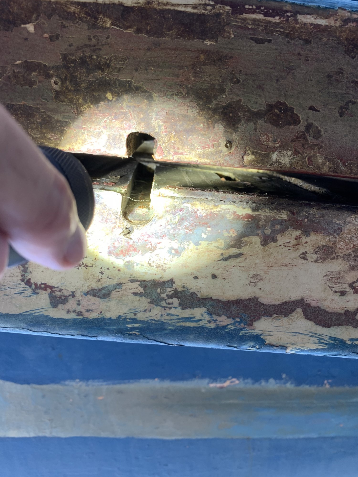

I filled the bilge with water and saw it coming out of the keel bottom at the starboard side keel slot. Looks like the glass (fairing compound?) has separated from the lead keel and is flowing at the separation at that point. I append a couple of pics of the keel and close ups of the leaking spot as well. Does not appear to be any water leaking from further up in the centerboard trunk. I am now waiting for the marina "glass guy" to take a look and get me a bid to fix this and/or tell me how to do it. If anyone has any suggestions, I am all ears!
Image of keel, full length. You can see the water exiting the starboard slot:

I finally got to your update post, through that last link you posted. My boat (S22) was put up on the cradle a couple days ago, and I finally got down to her today. Slightly different location but otherwise appears to be an identical failure mechanism with water weeping out of the small
Gap between the lead and the fiberglass bottom of the keel. It appears that they cut part of the glass centerboard slot out and put in lead blocks, can’t fathom why they would do that, seems an obvious failure point. I have a question in with the designer/manufacturer to see if I can get any more insight I to the design intent. My initial thought is to dry everything out entirely, flush with some acetone to clean, then run some tape along the edges of the trunk and flood the interior of the keel with a gallon or so of epoxy, hoping it will seep out and be captured by the tape. I’d like to retain whatever pointing ability the centerboard provides! Did you and the glass expert discuss anything like that?
