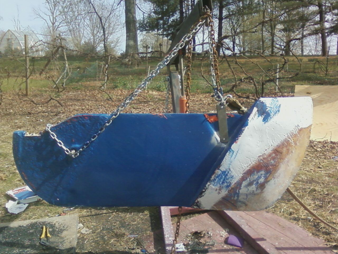

I am restoring a 1969 Macgregor venture. Am at a loss as to how to attach the winch cable to the centerboard. Is there a designated piece of hardware (The boat came with a funky, rusted bolt through the hole)?
13,052
You could bolt a short tang ...like the one on this Balboa keel.... but a long-ish shackle wide enough to bridge the width of the keel would also work

Thanks for the quick response. Very helpful
