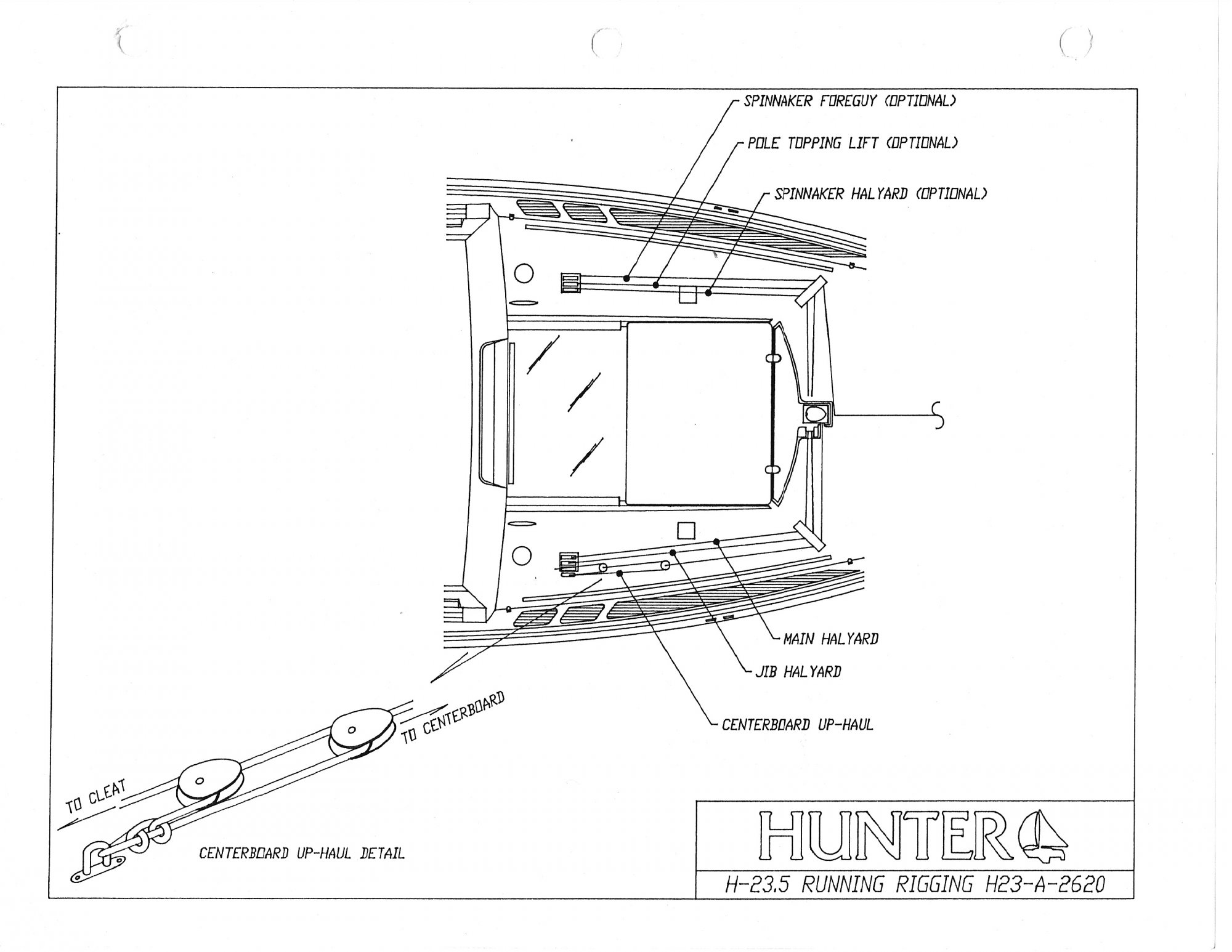

Centerboard add on
10,524
-na -NA Anywhere USA
If you hear a klunking sound with the centerboard hitting both up and down then the line is set appropriately. With the centerboard in the down position, the line that exits from the mast goes through a two or three turning block, tie the first turning block as close as you can where the line exits from that turning block
