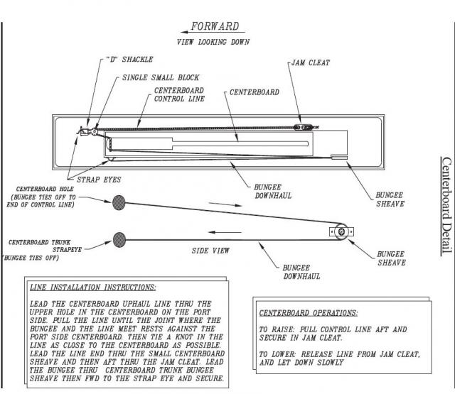

I have attached the page from my H15 owners manual about the centreboard. I don't know if it is the same as yours but it should be close.
