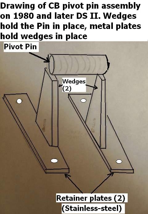

I wanted to update a give the info that I found out about my problem. There is a brass plate that was glassed in place when the boat was built. It was than drilled and tapped to hold two stainless steel plates which support the wedges and the center board sets on top of the wedges. I got this info from the the Day Sailer Association website. I emailed them. When they are striped it was suggested to drill and tap to the next size bigger.

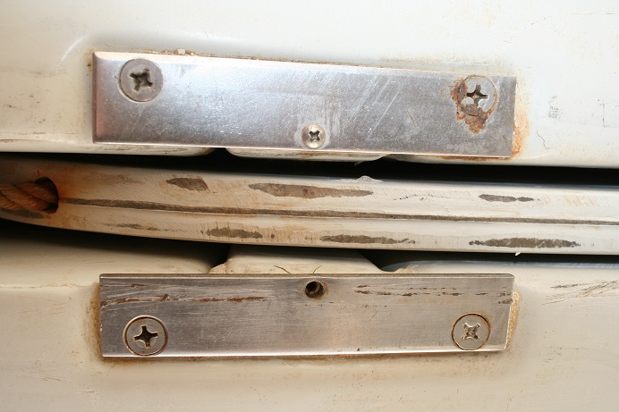

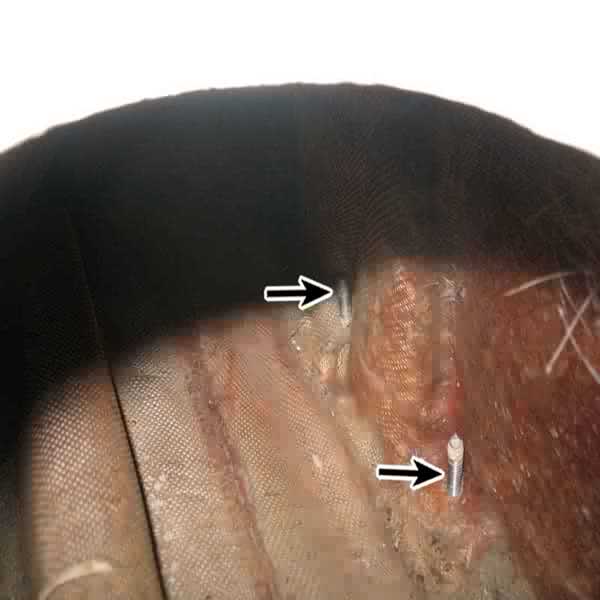

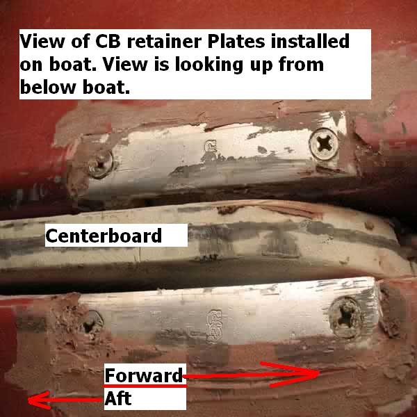

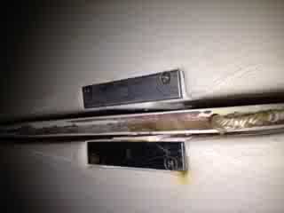

My DS II was built before the change to this centerboard pivot pin setup, but here are a few pictures that I got from another DS II owner for my Expanded Manual.(maybe I found them here or on the DSA web page)
