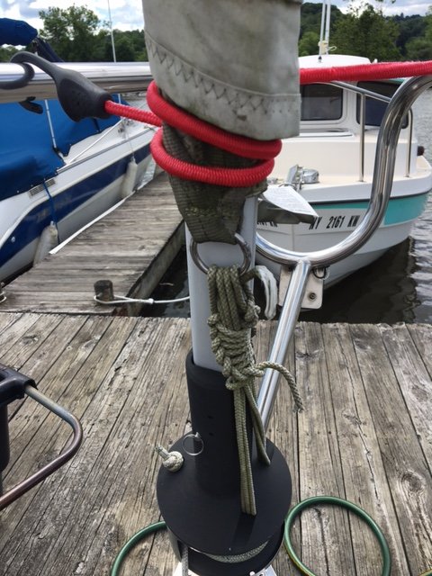

I am in process of renovating my Hunter 25.5. I would like to take down the jib off the roller but it is not clear to me how to do it. As far as I can tell the jib halyard is not attached to the jib and I see these complicated knots attaching the sail by the PO. I don't think I could ever duplicate this and seems overly complicated. I have never done this sort of thing before.

Have you read the manual?
It will explain the use of a messenger line tied to the halyard's end if you don't drop the mast for this operation.
Those "complicated" knots appear to be at the tack.

That's a CDI indeed. Get the manual and familiarize yourself with it. @justsomeguy is absolutely right, with one more bit of data; that's likely the storage place for the messenger line.

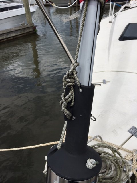

Manual for the CDI FF2 is posted under the Hunter 26/260 downloads under boat information as of two weeks ago. Please review that and if you have any questions after reviewing that, get back with us. However, there is an internal jib halyard within the furler groove. First untie the down haul line on the furling drum. You will need to untie the internal halyard line on the furling drum and add a messenger line to it so when the sail comes down you will be able to pull it back up.

Thank-you. I have read the manual and wasn't completely clear to me which why I posted here. I have no familiarity with this except for the manual and what I see in front of me, and it seems there is an opportunity to screw this up if not done properly the first time.
The first picture as someone pointed out is just excess line tied off at the luff - "complicated" by PO but can be done more simply. The second picture is the halyard line tied off. Taking it down, it seems I need to attach a messenger line to it, so as not to lose it and be able to replace the jib. I am taking it down for repair and to add a protective covering.

Unfurl the sail, tie a good knot (secure and easily untied) between the messenger and the halyard, untie the tack and haul down on the sail's luff.

Update:
All done - sail in the box - ready for repair, cleaning and adding sunbrella to it. Everything went pretty well - I did run out of messenger line and had to add another line but the guy in the boat next mine held the line for me why I got additional line.
