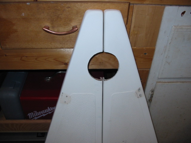

I cut my anchor locker doors last night
After talking to the people at CDI, I went ahead and cut my doors last night. They said that when the H23 came out they went down to the Hunter factory to work on the feasibility of installing their furlers in the locker. They said that the top of the spindle or bottom of the luff is 1&5/8 inches in diameter, so a hole of just two inches would work. That sounded a little too tight so I went with a circle of 3 inches just to be sure. Now this weekend I'm going to fiberglass a new lip on the doors to give it the strengh I lost cutting the old lip of the original rectangular opening off.

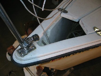

Picture of another set of modified doors
Here's a set of anchor locker doors that have been modified to put the furler in the anchor locker. These have the same shape as the wooden doors on Mac's boat. Looks to me like they went too far, not crazy about having a big gapping hole on the bow. The workmanship is nice the way they reglassed a lip back on from the cut off piece.

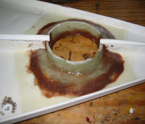

Pictures of new lips glassed on
Fabricated the new lips and glassed them on this weekend. This added an unbelievable amount of strength to the anchor locker doors, even more than stock. Still needs to be sanded and maybe a little more filling here and there, then final sand and paint.
