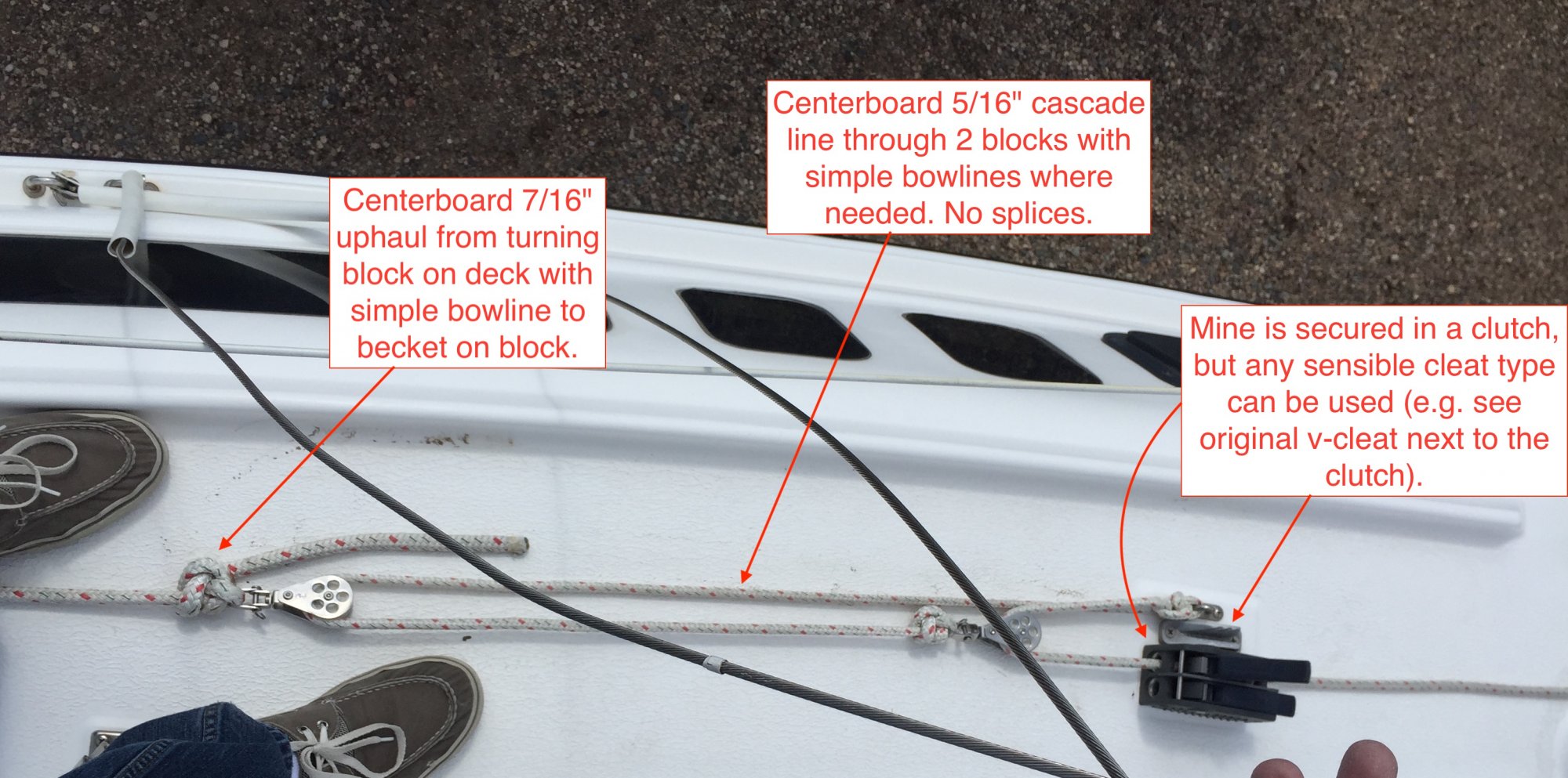

The manual says 7/16" for the line that attaches to the CB but will 1/2" work just as well or will it be a problem. A 1/16th fatter seems like it would maybe have a longer life.
