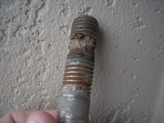

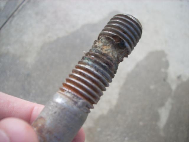

In the 26/H260 (and possibly 23.5/240) there is one 3/4" SS bolt that holds the bracket in the CB well. After my near miss on the bow rail/forestay bolt failure I figured no way would lightening strike twice on such a critical fastener but yes. When I pulled the CB during a new session of bottom paint and general money pit refurb delight the CB bolt came out nearly 30% gone!
I know it's buried in sealant and may have suffered from oxygen deprivation but if that's the case on a boat that's only 6yrs old, how is everyone else doing on even older 26/260's? It's a big stainless steel bolt that was clearly on its way out. Hope you're lucky too.
Lucky again, Mike
PS If I didn't know better I'd say it could have been a lightening strike that exited through here when the first owner had it. That thing is seriously pitted and there seemed to be some similar pitting on the bracket sides too.

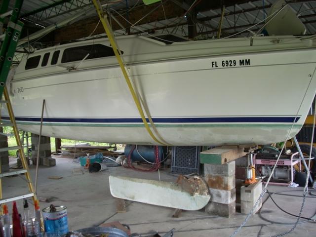

Nice rig!
Forget about the bolt, I love your rig for working on the boat! Must have some serious roof joists to support the initial lift, huh?

That one SS C/B bolt holds the whole C/B and its hardware in the boat so I'm glad to have the opportunity to catch it before a major issue happened. So the shop project pays off. Can you sense Kellis muted glee while I find yet another project out in the shop;). Trash cans be damned, there's a giant beam to be welded somewhere woman....
I tend to get carried away with big steel projects......well just about any project really. There was a pile of 50' long 22" I-beams, 6"x25' steel columns and misc bar joists on my property so I spent two years, pretty much solo, welding and cutting and cutting and welding until the beast was born. You could drop a tank on my shop roof and it would be fine. My little hollow sailboat isn't hurting anything in this structure.
Big pneumatic jacks and Texas sized tools make the job a lot easier but it's still a little tricky. Actually I jack the whole trailer and boat up near the ceiling, block and strap the boat to the beams, then lower and remove the trailer.

The more I think about it I'm almost sure it was lightening strike damage to the CB bolt.

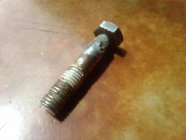

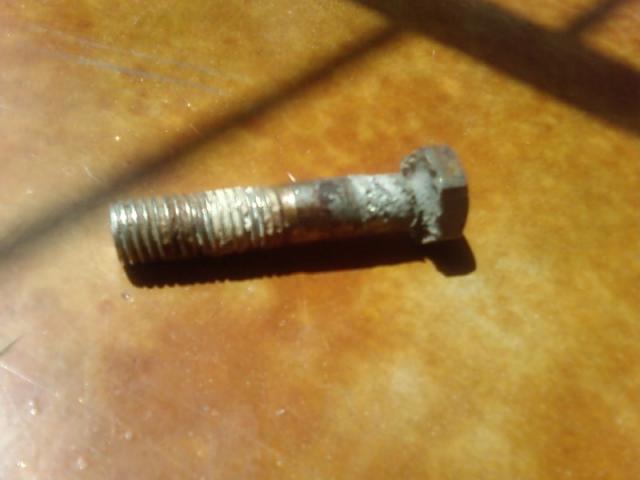

Looks pretty much like the oxygen deprivation corrosion (crevice corrosion) , Mike.. It would be in a close clearance fit that has stagnant water in it. Attached is a shot of a rudder pintle bolt from a buddy’s boat. Glad we found it.. Same problem, leaking sealant around the bolt, underwater. That rough pitted gray surface is a giveaway. Lightning arcs (most of the time) leave little well rounded nubs from the melting that happens.. Seal the new one well where the corrosion is on this one, and ya won’t have a problem.

Lightening is pretty ferocious stuff and there doesn't seem to be any other damage so I believe you're right. Rust never sleeps, eh? I don't think the damaged part was encased in sealant but was certainly submerged in a small area way up in the CB well where the water would be stagnate for days/weeks.
