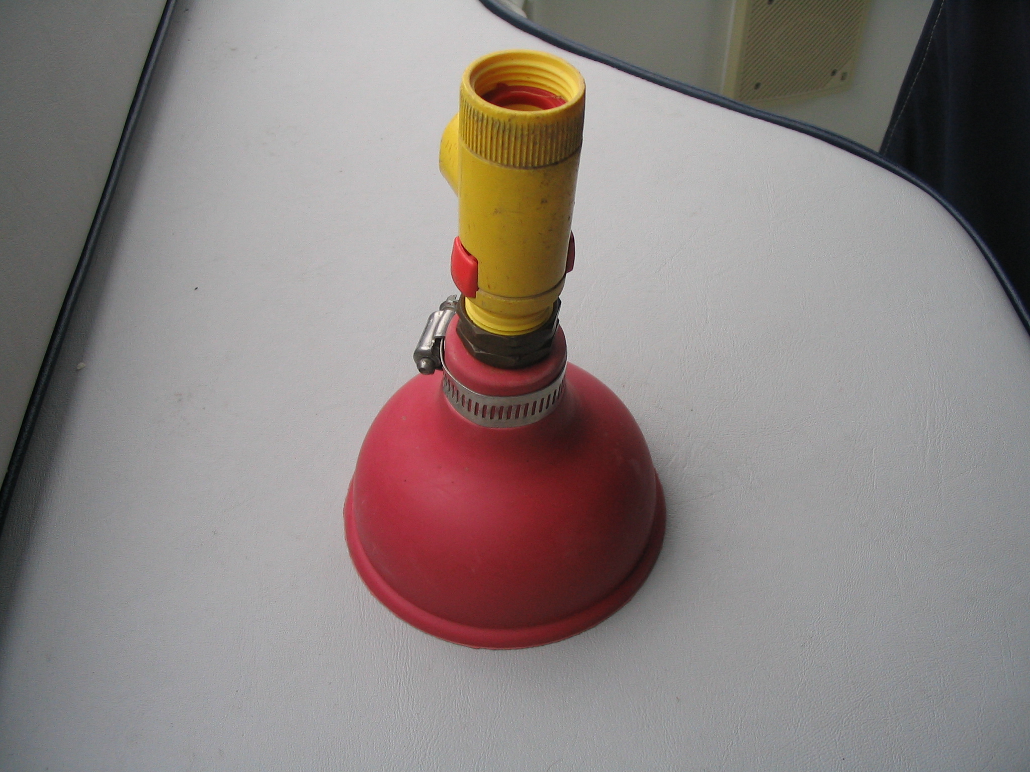

Peggy probably did not mean to put the nozzle on/in the vent thruhull, as that is probably the same nozzle you use to fill the water tanks and such. I carry a 3-foot hose extension with no fitting on the end that I put nto the thruhull.
Rick D
Jun 14, 2008
7,186
Good point. This is what I made to go over the vent cap.

Actually Ron, I did mean put the nozzle up against the thru-hull...'cuz I always removed the nozzle from my dock water hose when I filled my water tank so I could stick the end of the hose into the deckfill instead of standing there holding it. I thought everybody either does that or has a separate dedicated hose to fill the water tank.
The nozzle, unlike Rick's gizmo or the end of a hose, puts water into the thru-hull and down the vent line under enough pressure to wash out whatever is in it. However, anything that floats y'all's boats is fine as long as it works.

Hey Rick, nice tool that you fabricated. Very similar to the one I made as a way to make sure the tank vent remains clear after each pump out. My last step is to run city water through the vent scupper using that tool while running the pump out system until clear water appears through the pump out hose.
I have followed this procedure since 2002 and the system has remained trouble free ever since. Plus, everything on our boat that is sanitation related is original including the Jabsco heads. Thank you Peggie Hall.
