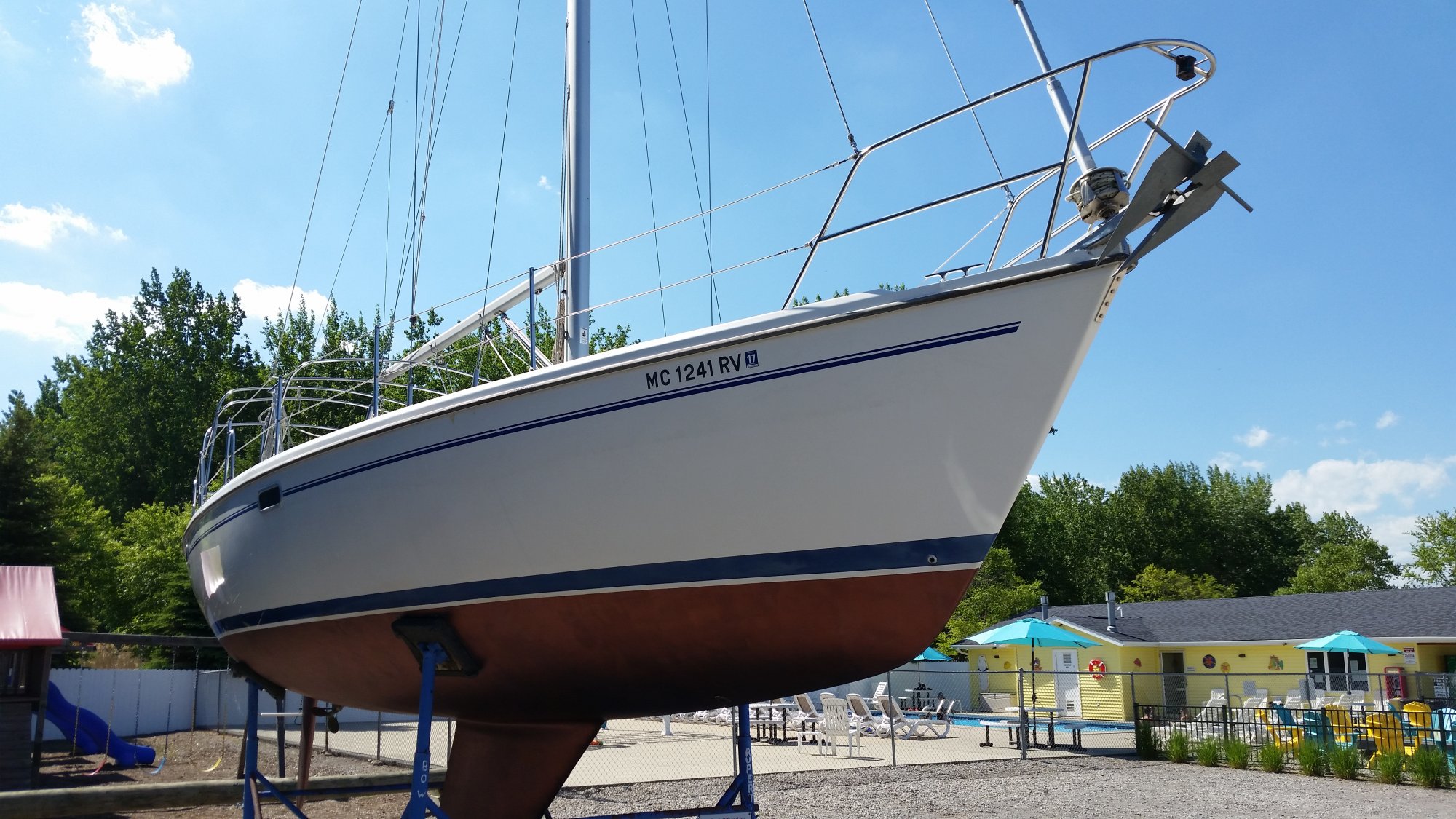

It doesn't care - it's designed to hold its entire weight on the keel. Here's a Catalina 36 calmly sitting on her fin keel. Four pads on the sides just hold it upright, and have no real upward weight bearing. Thousands of C36's, and a variety of other keel boats, pass months of winter in the north this way (with a snow cover on, of course), and it does not hurt them at all. I know it may look odd with nine tons pressing on a 6 x 20 inch spot, but that's how it is meant to be. If you're not fully grounded, a bunch of the weight is taken by flotation, and the healing when aground is natural. These things are stronger than you know.

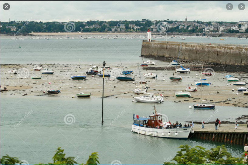

I would say no one here has sailed much in Normandy.... There they have like 15 meter tides. Boats there lie on the bottom at low tide all the time. For sure bilge keels are quite popular there, but I'm seen hundreds of regular keel boats lying on their sides at low tide - no water to be even seen.
Mud bottom on the Chesapeake where you are keeping your boat, I wouldn't worry about it at all.

Normal in Normandy....
I used to have friends sailing there that were liveaboards. They built legs that they would put on the gunnels of their sailboat so it would stay upright at low tide...
