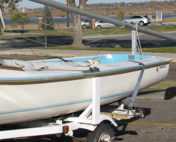

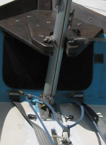

I dont know the official way.. however, on my Coranado 15 (dont know the year), both slots in the mast base fit on pins - ie, two slots are resting on two pins. It sort of looks like the mast base may be adjustable back and forth - but I always just set it as above.
Attached are the best pictures I could find. Once pinned, three stays holds the mast up fine
It is easy to step the mast by yourself with this boat - one of the things I like about it. In one of the pictures, you can see a little custom crutch off the transom and this helps me get the mast base set (holds the back of the mast up so you dont need a second person in the back to do the same thing). I just walk the mast up from the back, the mast base slots rotate onto the two pins. Once up all the way, I have a rope and hook up front that I use to temporary hold the mast while I walk around to the front and pin the front stay.

Looks to me like that aft "hook" goes on the second pin from the left. You can see that it's shiny there where it was sitting on it. if you can't get it in, try removing the blocks on the left until the mast is raised, then put them back after it's secured.

Walt: I tried using the short crutch like yours but the main sheet pulley assembly attached to the floor forces me to have the mast almost 6 foot in the air in order to get the angle where I need it so I made a 6 foot one. :)
