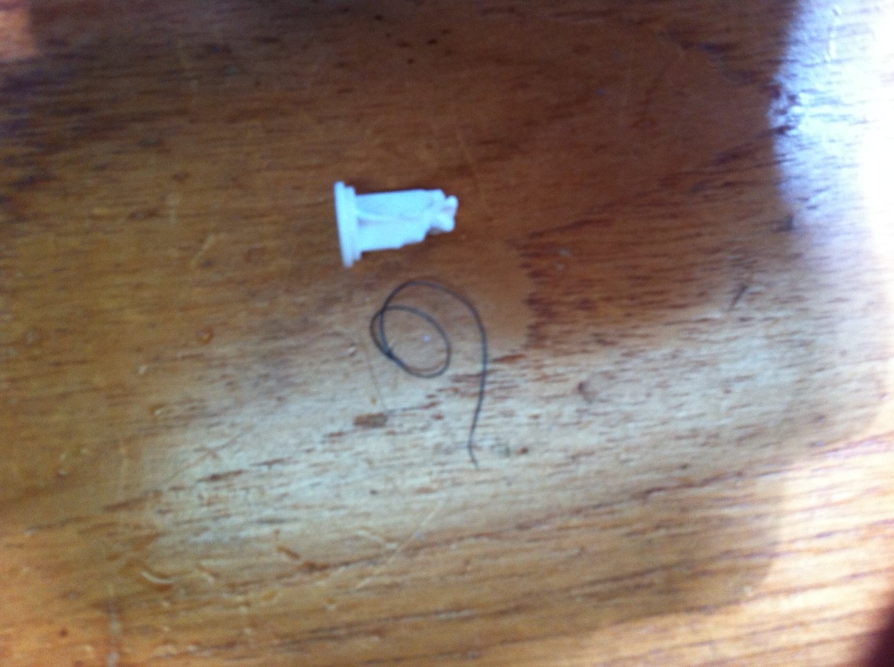

I ordered some new valves and fittings along with some new collet C clips from a vendor this morning. They will fit the 15 mm tubing and are identical to what is there now. I also will be adding an accumulator to the system to minimize pump cycling. When I got the old fitting apart I found a metal spring and a check valve from the pressure pump stuck in the fitting which had destroyed the O ring. I suspect that this was the reason the pressure pump was recently changed out by the former owner. I will be assessing the rest of the system as I move along. I might add booster pumps in the outlet lines of the tanks themselves. It seems that when the water level drops to less than 1/3 the pressure pump is unable to lift the water up and get it into the manifold and onto the rest of the system. I'd love to add some kind of transfer pump system to move the water from one tank to another but on the other hand I want to keep things as simple as possible. Less to go wrong that way. Of course the problem just might be not enough oomph in the pump.:stir:

Stu that makes perfect sense. I'm going to try and download a photo of what I found in the inlet to the water heater where it ruined the ORing.
