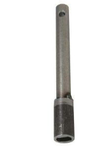

I had a similar problem when replacing my galley faucet (between the sink and bulkhead) until I found the faucet socket wrench that slides up each faucet water line assembly (after disconnecting the water supply lines below the faucet) to the nut that secures the faucet to the counter. Other alternatives were remove the sink/faucet assembly (after disconnecting the water supply lines below the faucet) OR cut an access hole in the bulkhead but was able to avoid these options. Hopefully the forum can offer you more specific advice on how they replaced their head faucet. Good luck.
