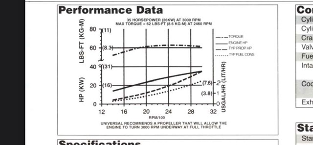

1.2 GPH sounds awful high for a 35' boat. What engine are you running. usually, your total range will increase significantly if you lower the rpm's. The extra speed at max comes at a steep drop in total range.

I don't own one yet Hayden, I'm just going off of what the Universal M35B operators manual says. 1.2 gph for 2500 rpm which should give 6-7 kts.

Wow, that's terrible fuel consumption. I have a hard to read copy of their sales material, and at 2500 rpm, it looks like the motor would be developing 30 hp. A general rule of thumb for diesels is burning 1 liter per hour per 10 hp being developed. So at that RPM/HP combo, 3L/hour (0.79 gal/hour) would be a good expectation.

Afraid Hayden is accurate. While your mileage may vary the Universal 35 is more stingy on fuel. The manual reports liters per hour at various rpm settings.
It looks like 2 liters per hour at 2800 rpm is stated. That would translate to a little over .52 gallons per hour.
if you wanted to identify a safety margin, till you had hard data on your engine, consider using .6 to .7 gph in your planning.
Based on the tank capacity stated of 39 gallons that would provide, conservatively, a range of 340-390 nm.

JSSailem, no disrespect intended but if I enter that performance chart at 2500 rpm then follow to the right to the GPH it falls just above 1 gph...any owners with actual numbers that differ from the performance chart I'd love to see what the consensus is of fuel burn to achieve hull speed.

You are correct. My eyes were confused. At 2800 the chart indicates 2 gal/hr.

Sorry, I don't keep track of fuel consumption so I've got nothing for you there. I can tell you I had the same concerns regarding fuel consumption when I checked out the performance chart referenced above when we bought our 350 a couple of years ago. We have a 1gm10 on our other boat, and it definitely uses more fuel than that one :) , but I've found the M35b engine on the Catalina to be a great motor. Extremely smooth running and quiet and dependable as heck.
Don't know what the concern would be insisting on motoring at hull speed. We back it off a bit, and it seems to me to be a pretty efficient engine (though I don't keep track). When we have to motor, we do as much motor sailing as possible, so that stretches the fuel out more, and makes it impossible to really track fuel usage when we're cruising up on the Great Lakes. So many variables anyway...prop on boat, wind, waves, current, etc., so I wouldn't really get hung up on the fuel consumption graphs. A 3 cyl yanmar isn't that much more efficient than the M35b, doesn't have as much HP as the M35b, and is a 3 cyl where the M35b is a 4 cyl, so all things considered, not sure you would get any better fuel consumption with a yanmar, on that boat. Keep in mind, the 350 is a very big 35' boat.
