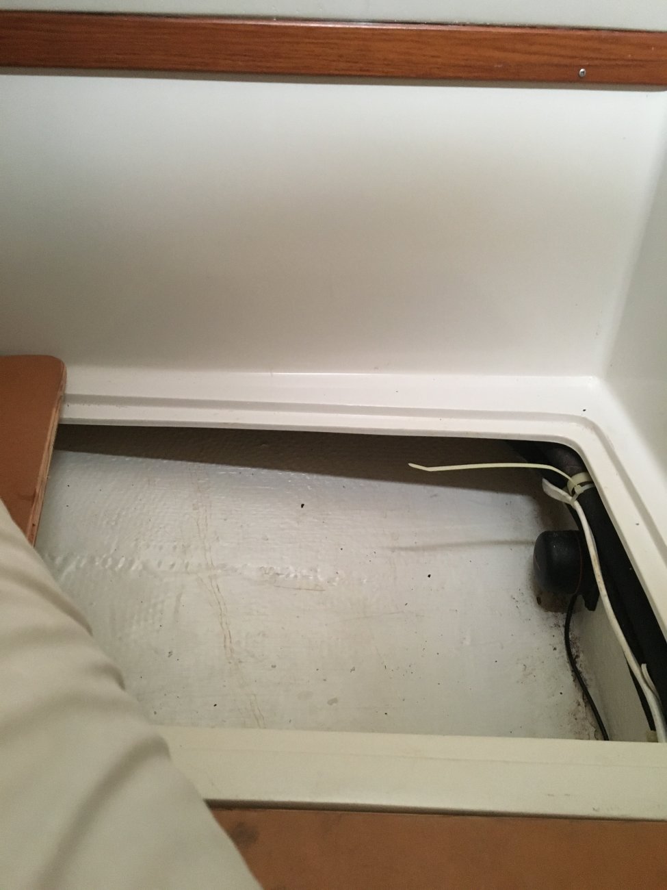

I have a 1996 Catalina 320 and I keep getting water in the port side area under the bed. I have recaulked all the stanchions, the backup tiller access on deck and helm pedestal still no luck. Has anyone had this problem?

The area is under the rear berth on port side and unfortunately the water doesn't drain to bilge for some reason. Perhaps a drain hole is plugged that leads to the bilge. I should have mentioned this it seems the water accumulates after a hard rain but I don't see any water lines running down the inside of the walls of the boat. I checked all stanchions to make sure they were tight. Perhaps I might just have to open all the boards in the rear berth during a hard rain and see if I can see where it is coming from. I thought someone might have had the same issue.

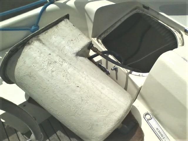

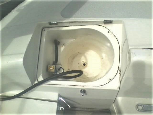

I had the same problem with water accumulating in the compartments under the aft bed on my 1994 Catalina 320 and eventually found 2 substantial leaks. One was the emergency tiller hatch behind the steering wheel (I completely replaced the circular hatch). The other was the seal on the propane tank "pan". This pan holds the tank and sits down into a recess in the hull. I removed the pan and rebedded it. Completely dry after doing these fixes ...… neither expensive, just took time.

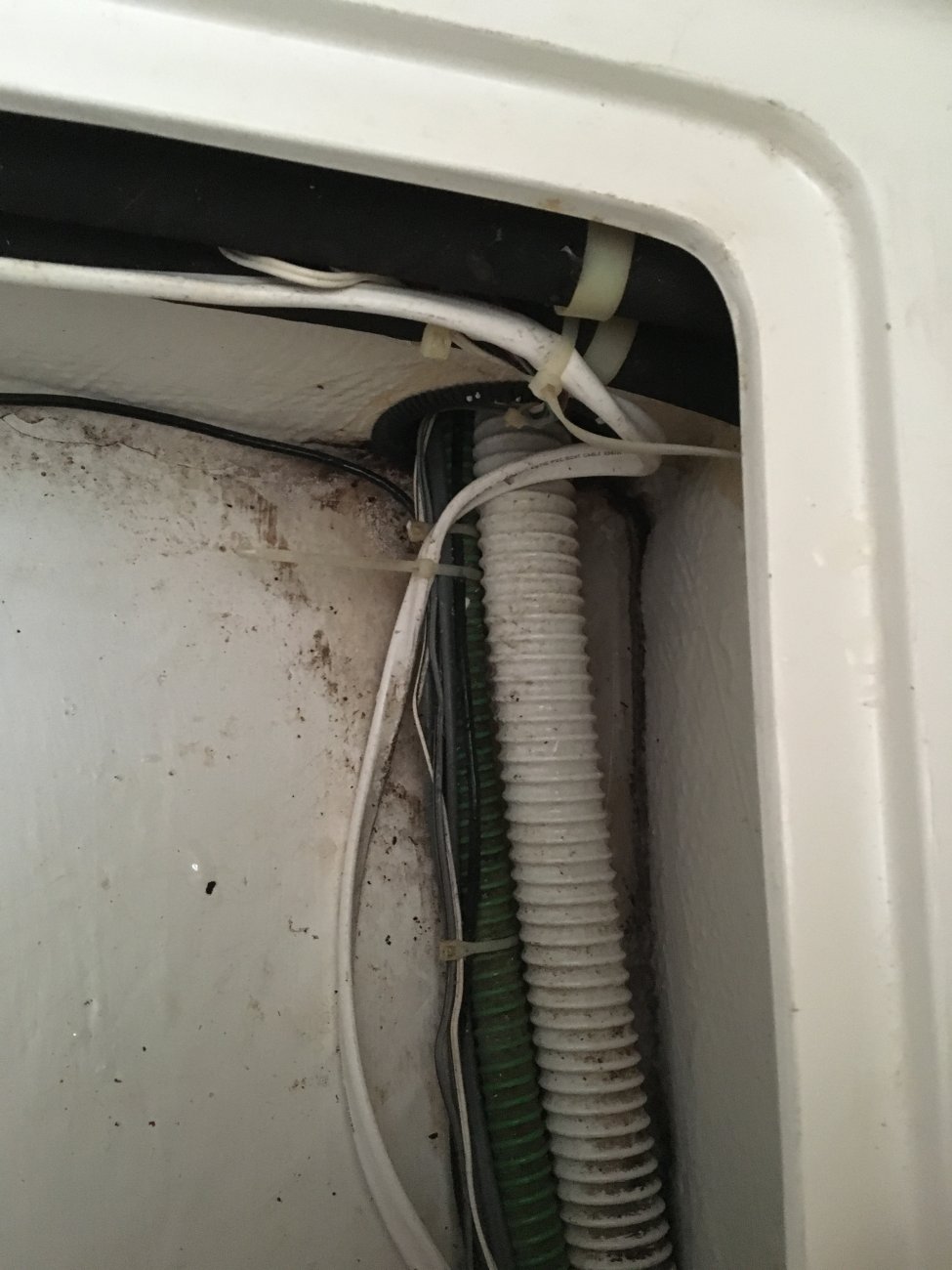

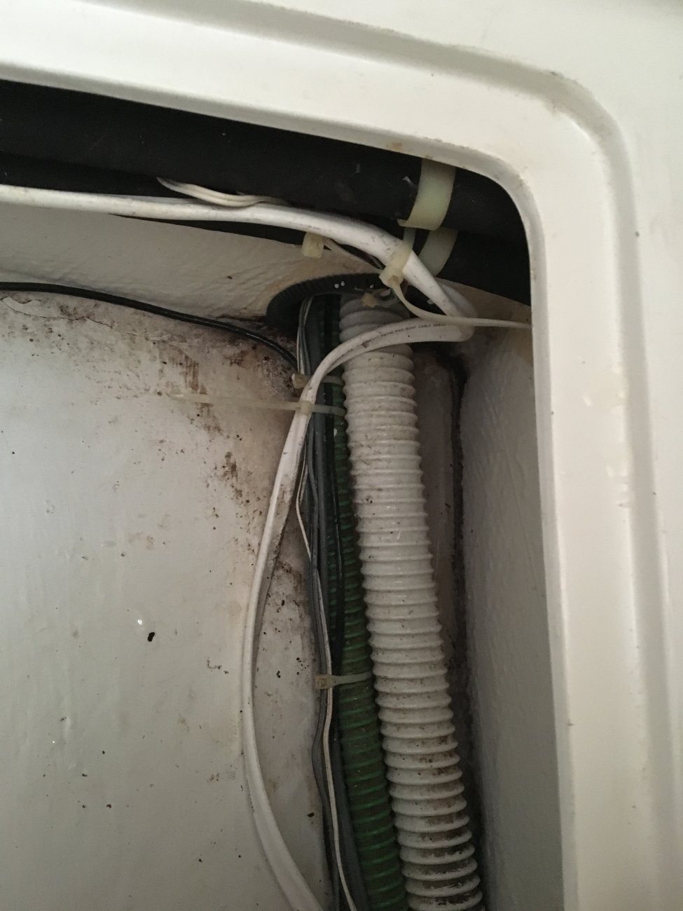

Thanks MIGuy for pointing us in the right direction. We found the hose for the drainage propane locker was leaking at the hose connection to the stern vent for the water to drain out. Once we put plumbers tape on it and tighten it --no water in hatch. YEAH! Thanks again everyone for your help!
