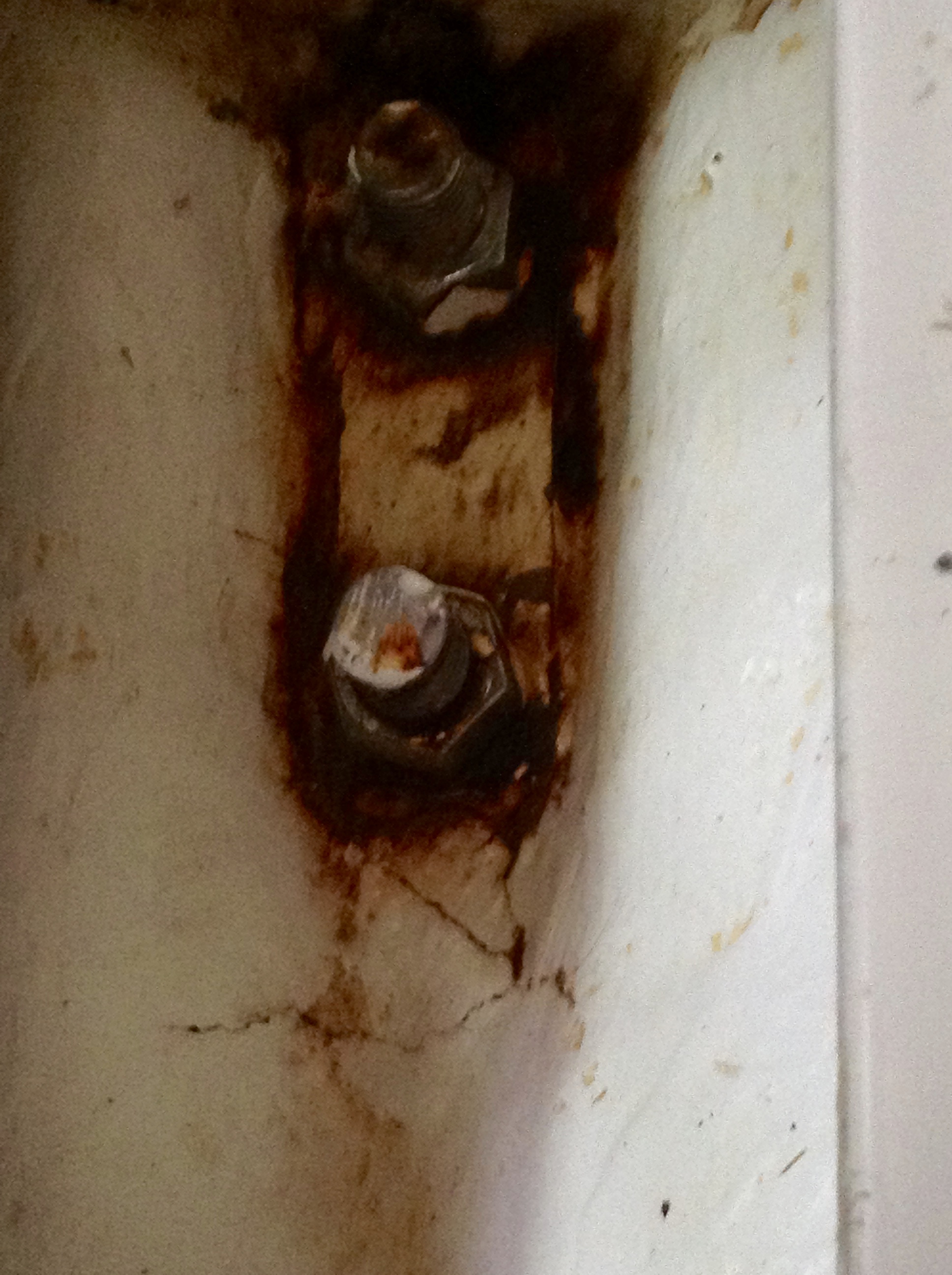

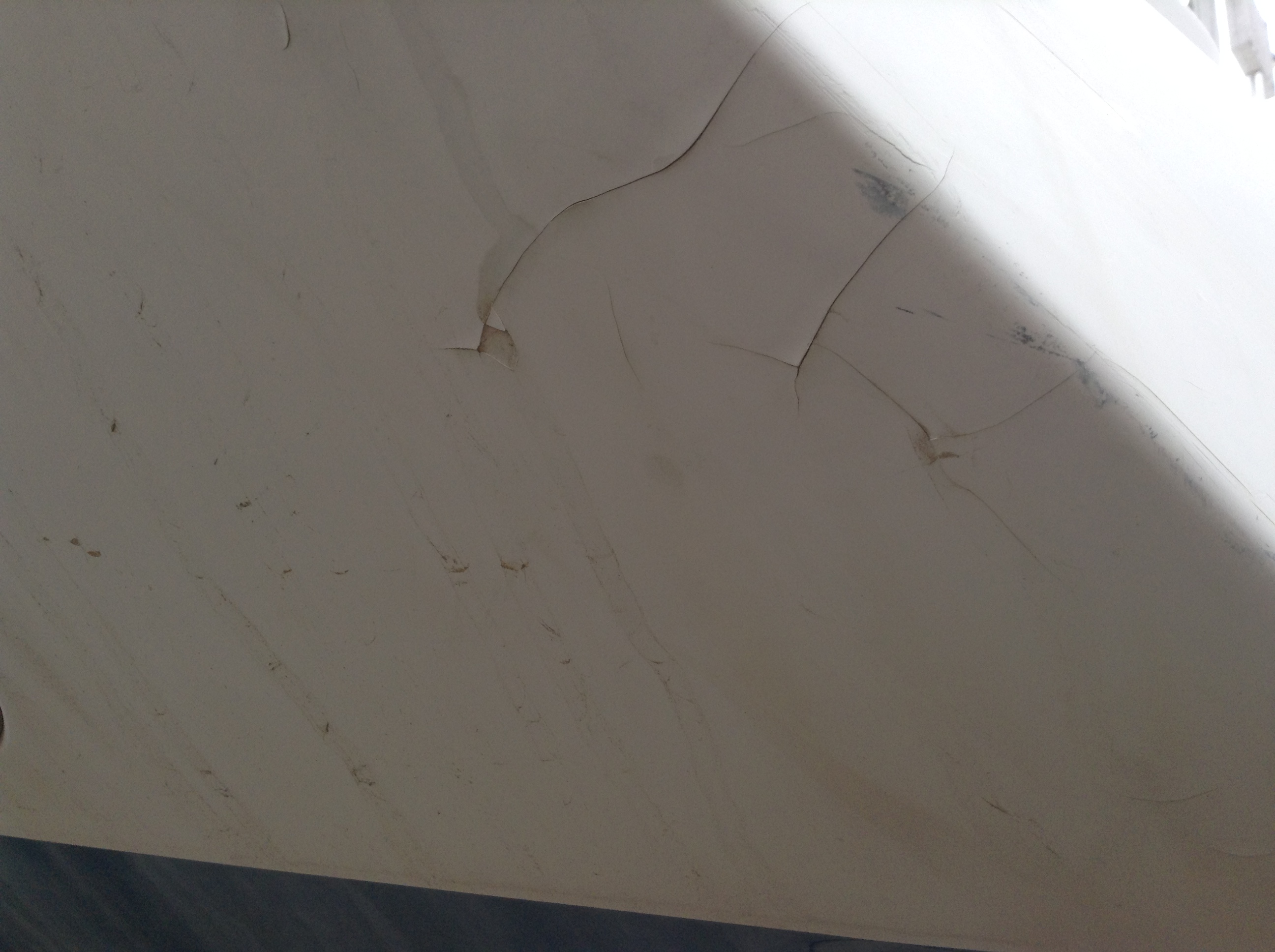

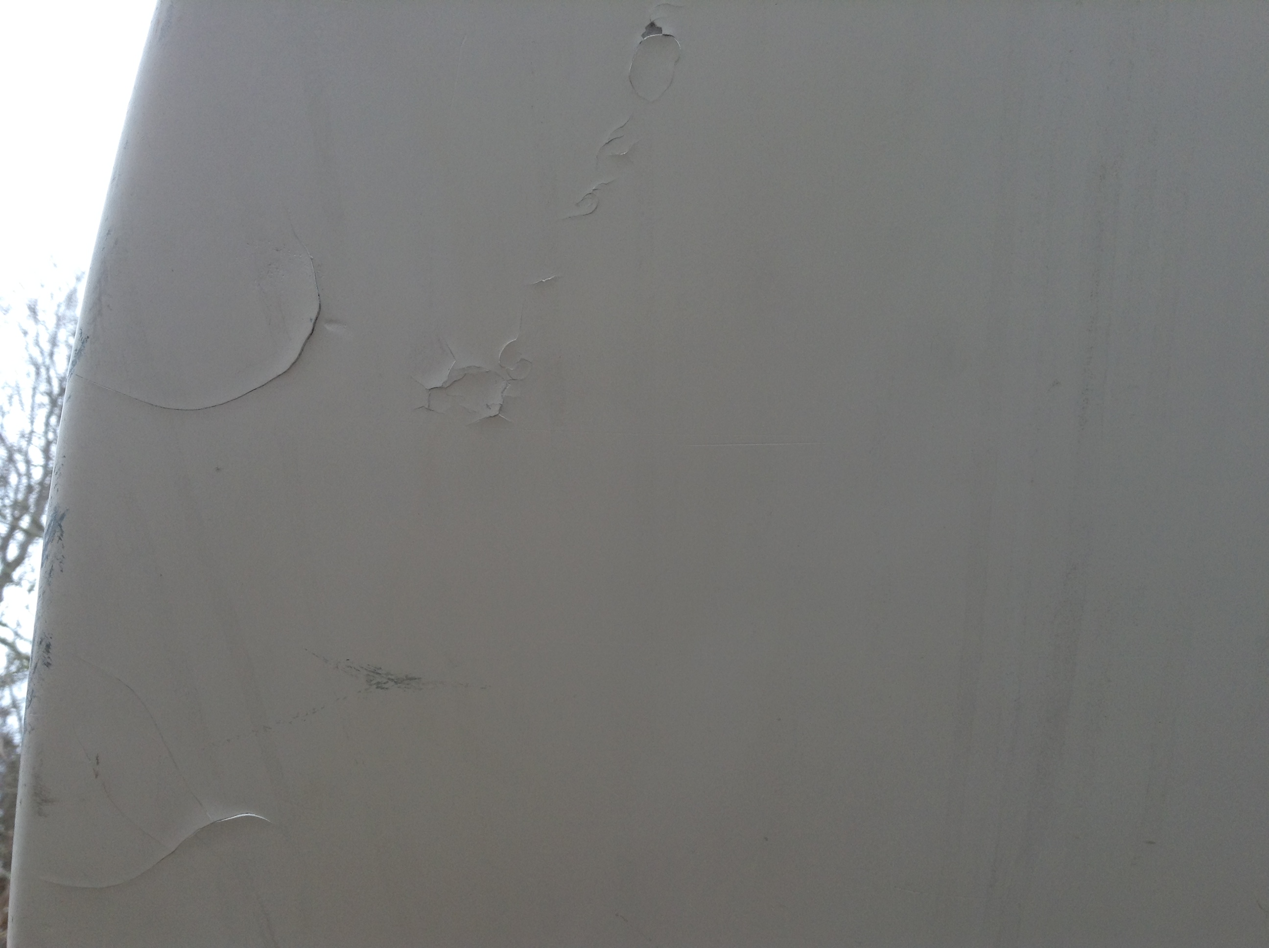

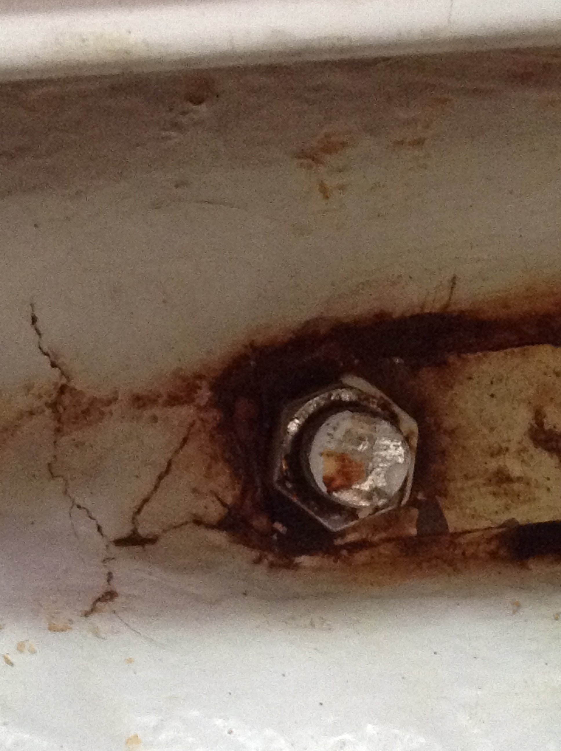

The Catalina 320's are plenty out there and they held their value well. Unfortunately, you have many abused 320's piggy backing off this high resale. Many are 20+ years old and PO's are asking 45,000- 75,000 USD for this. The frustration of driving hours only to see cracks in the bilge around keel bolts, severe rust on keel bolts from electrolysis, Damaged transoms where it meets the hull and shoddy repair work to hide this, Yanmars that look like they have leprocy, poorly tuned rigging to the point you can see obvious discrepancies on the turnbuckle threads( OK now I'm nit picking) but the list goes on and on and these PO's and brokers are really delusional with the prices! I feel bad for the suckers that romanticize sailing and don't look for basic warning signs...they pay a surveyor 600+ to tell them these issues and probably decide to go ahead with the purchase underestimating the future cost of repairs. That faint crack around the keel bolt in the bilge may not cost you your life but could cost you over 20,000USD when it progresses into a larger crack.
Apr 8, 2010
2,078
I know of a Cat 320 that had to have the joining seam at the transom ground out and glassed back with cloth. Now it's as strong (actually stronger) as it should have been from the factory. Makes me wonder if there was a management issue for a while in the plant and workers were under too much pressure for time and that resulted in excessive filler with very little fiber for strength.
Generally good boats, but this was a construction issue that never should have occurred, strictly IMHO.
Given the rig loads on the whole transom, that's an area on any boat where a shortcut has real consequences.
ps: are you the person that drove for hours and was confronted with the discrepancies? :(

BTW I've never seen the kind of damage in your photos of the transom, that is the result of a notable impact not someone just kissing a dock.
