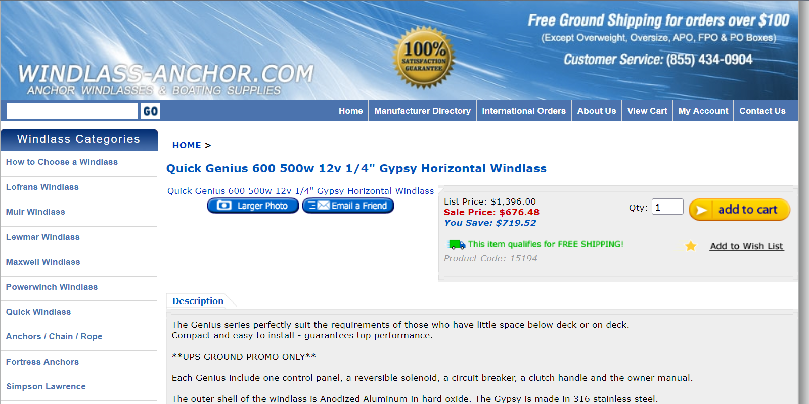

Quick recommends their 1/4 chain, 3 strand polyester rope for their windlass. The splice is a Quick system rope/chain joint (slim splice that is more tapered to prevent jamming). I know nylon rope is supposedly better for anchor rope because of it’s elasticity. My question is what are you Captains using and is that rode working without jamming? My boat is a month away from delivery and I’m in the process of provisioning.

This does not seem to be the windlass you want for a brand new Cat 315. Their write up of construction materials leaves something to be desired. Just going by the old adage that "you get what you pay for" at $676.48, you're looking at a windlass that will be a source of problems from very early on. You should be looking at a quality windlass such as a Maxwell, Lewmar or other known brands.
It really starts to get weird when they mention that a special Quick system rope chain joint is required ? ? ? ?
