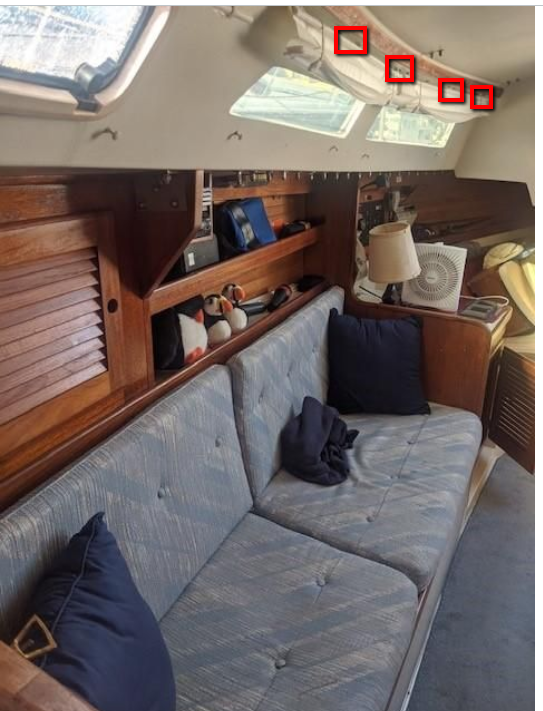

Thanks they are the deck hand rails and it’s 1991 and I don’t see any screws inside the cabin

Here is a photo of a 1991 C30 I grabbed from Yatchworld that shows the handrail screws.
