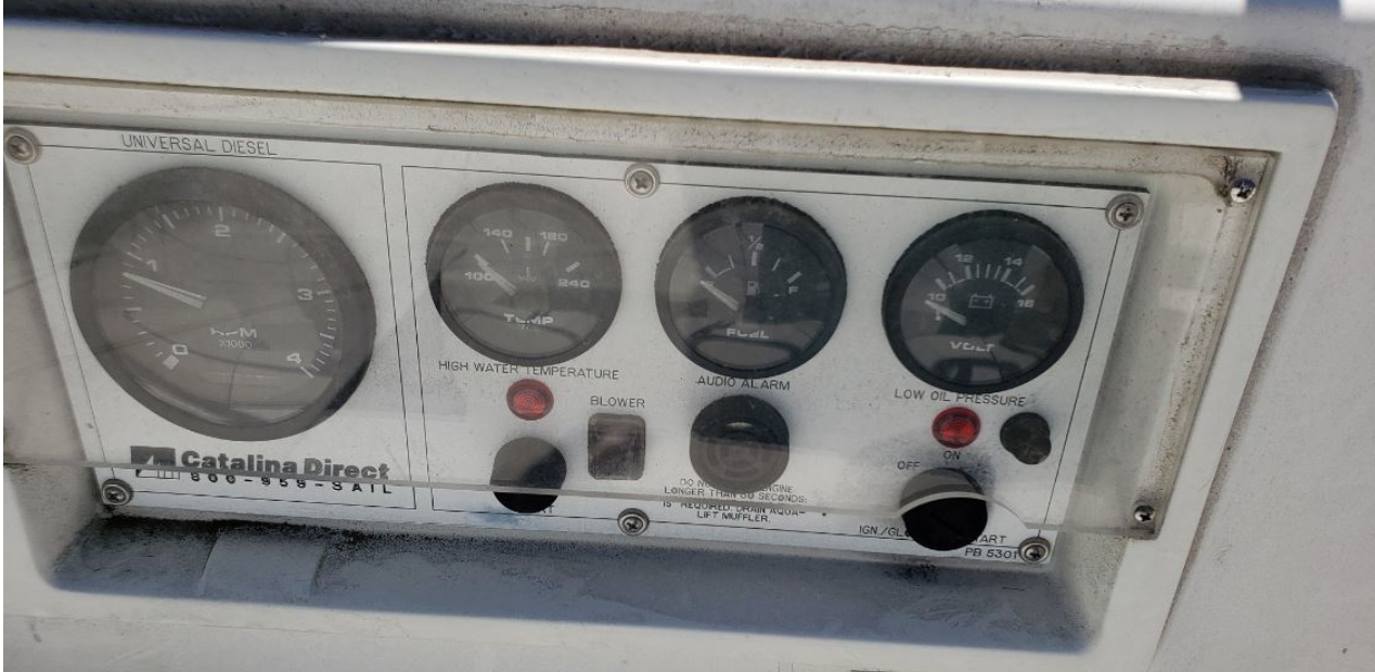

post a pic of the panel - different ones were used. Do she crank with a button or the key switch?
is there a preheat switch (it could be a button or momentary toggle.)

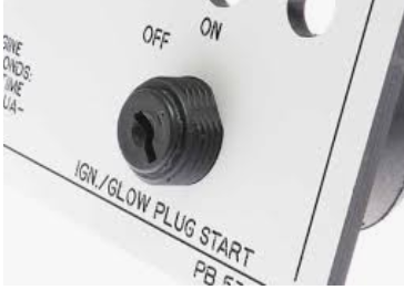

As far as activating the glow plugs, I believe it's part of the keyed switch mechanism - one turn to the right for on, and one more turn for glow plugs. As far as I can tell, it's a Model 25 (no reference to MXP).
It's an '86, same year as mine. I am guessing that you have a glow plug button and a start button. When my key switch failed a few years ago, I discovered that Catalina had installed a three position switch, but only connected two poles so it was really only a two position switch, I or O!!!
It should look like this unless a PO changed it:
I replaced the useless three position switch with an I/O, looks the same from outside.
Turn switch on, engage glow plugs for 30 seconds (15 if there's a solenoid installed, NOT OEM!), wait a tad, hit start. Don't hold the GP when you hit start. One at a time.

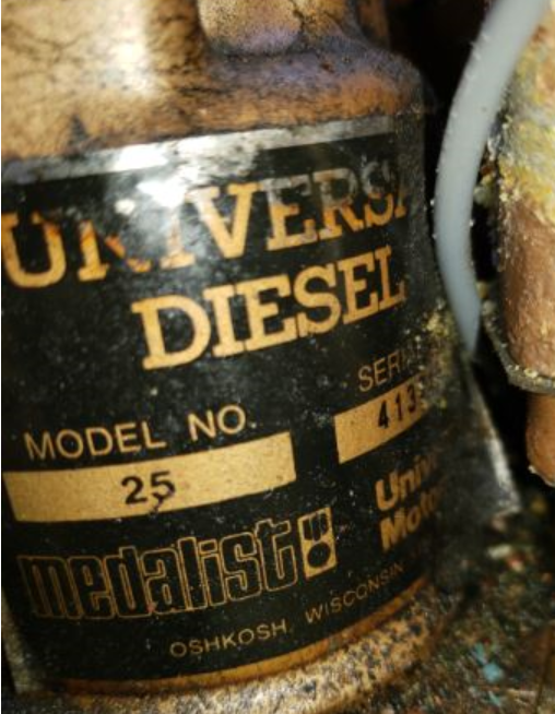

Let's get the engine nomenclature right, please. Tom, you wouldn't want folks calling you Mot, would you? There is no "Model 25." There is an M25 or an M25XP. There is also an M25XPB, a very diferent engine than the first two (and rare OEM in C30s or C34s). These two are almost identical except for a few extra HP, a 3" HX and the corrected alternator bracket in the M25XP. That's why you need to read the Critical Upgrades about the bracket if it's an M25, which I am almost sure it is.

Yes, thanks - I'll check out the Critical Updates. Pics below. Looks like the panel was replaced based upon the Catalina Direct logo. Broker said current owner replaced engine wiring, so maybe this was done at the same time. Button below temp gauge is pushed to Start. The keyed ignition switch is below low oil pressure lamp. I was guessing glow plugs initiated by turning all the way to the right (see stock pic below)? Just heard that the current owner says he activates glow plugs for 30-45 seconds and then it might take 10 seconds of turning over before it starts. Going out tomorrow afternoon to see it start again.

Oh golly, I was wrong. Darn, yet again.
I'll succumb to Model 25, labeled on the darned engine itself by those literate engineers at Universal, and in those pesky "manuals." [RTFM - Brian, F stands for Funny.]
Now, can we go back to calling it the M25 like skippers have been doing for only the last 35 years?
