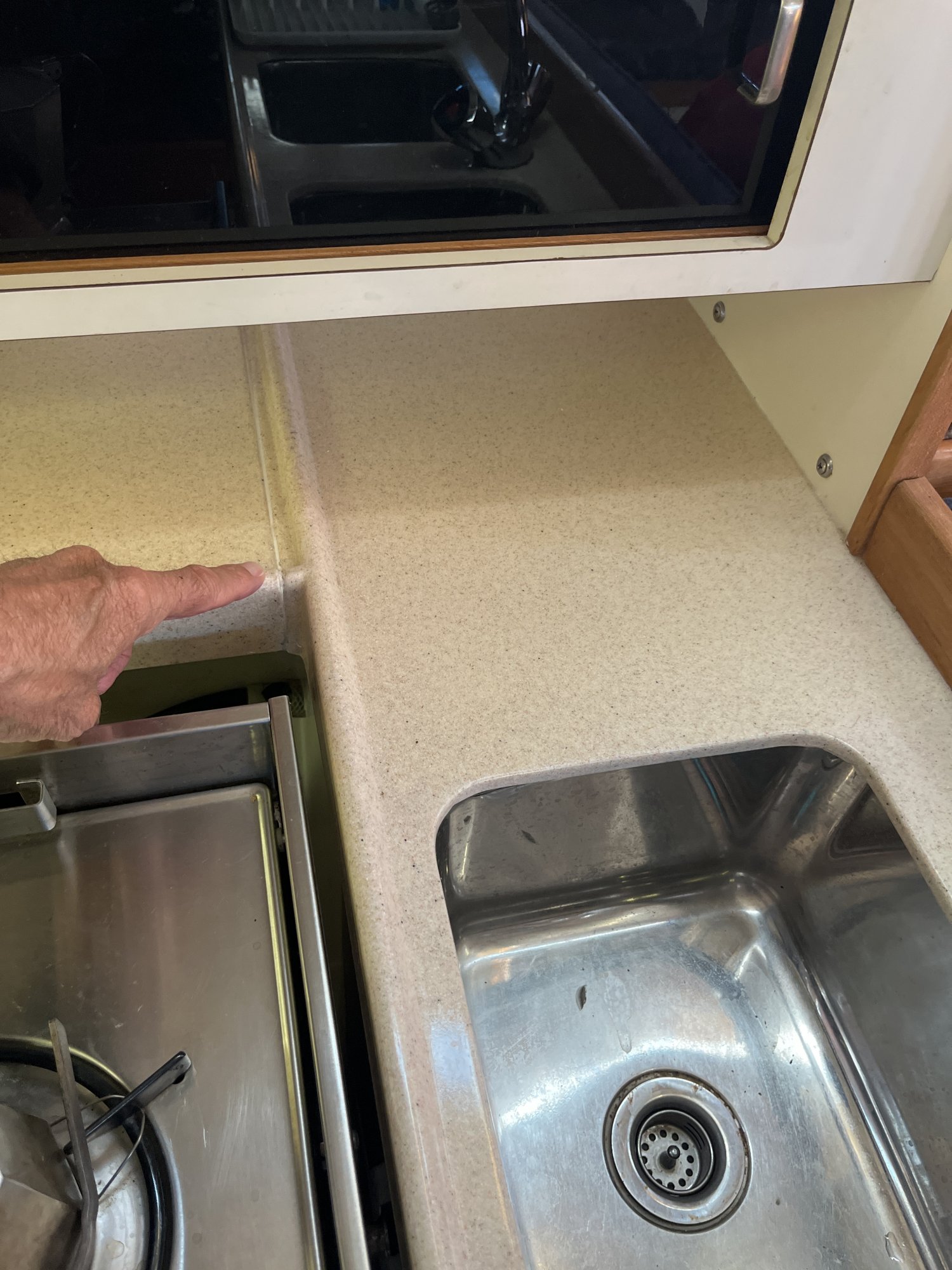

Hello.
Hopefully you are already done with your project. If not, I have hull #6444, a 2001 C30 MK III.
I didn't notice it at first, but my counter is actually two pieces, with the seam caulked. The section the sink is in continues all the way to the hull. And a seperate L-shaped piece is the port and aft section.
Good luck!

Hello.
Good luck!

Is there any chance you could grab a pic of your countertop? Perhaps Catalina started cutting it in half after a certain date or I missed the cut in mine
