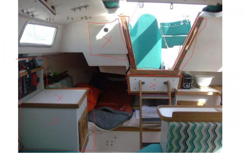

My 1978 is all teak/and teak veneered plywood. The hatch covers under the seats and V birth and so on are MDO.
I have made a new sink cabinet and chart table cabinet using MDO. I just took apart the cabinets and use them as a template, and cut the MDO with a router using a plunge a bit with a bearing on top to ride against the template of the old cabinet piece. Then I reassembled the cabinet and covered it with new vertical grade Formica/for the countertop and tabletop I used post forming Formica (just a thicker grade at the same color) I cleaned the old teak up and reuse it on the new cabinets.
