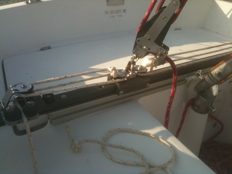

Well, I use the traveller all the time.... it's an integral part of my sailing experience.... and I'm not talking about racing.... so don't go there. Here's my simple set up...it's just a simple 2:1 with the small harken car on harken track (harken cars need harken track) The essence of any adjustable traveller is that you need a ball bearing car... You may be able to find a car that fits your existing track.. it's probably 1" T track... and that is why the Garhauer equipment was suggested.....
Anyhow, take a look at my simple system... if you can find a car that will fit your existing track you'll save 30-50 bucks. To maximize the range of movement the attacment points and cleats should be offset so the car can move all the way to the end.
As far as seating.... the area behind the traveller, on the lazarette hatch, is a very popular place for guests to stretch their legs while using the pushpit as a backrest.

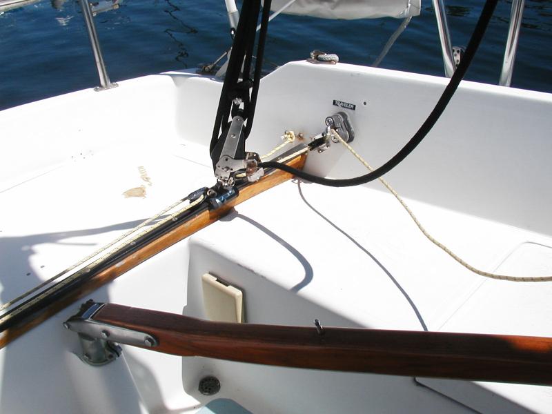

I've done the upgrade with the traveler from CD. Works like a champ. I was going to purchase from Garhauer but didn't see online which one would work properly (MT-1 maybe) so I just went with CD. As you can see it's a 3:1 purchase. I mounted mine on Aluminum 8020 to raise it up for clearance instead of the wood.

I do like the way you raised the track to clear the tiller. It would also help to raise it at least flush with the cushions and prevent chafing, another concern that was posted earlier. Mine still sits down in the recess.
Do you have a spring under your main sheet block to keep it upright, mine doesn't and I've considered adding one to keep it from banging on the tiller.
Never had a cushion problem.... but if you want to raise the system an inch, that would work. Notice that I do not employ track mounted end blocks and cleats... The goal is to get the car to move as close to the track end as possible to give you the widest range of movement. I have seen systems where the control line block was BEHIND the cockpit wall, with the line emerging near the trimmer's station...
I don't have a spring on the mainsheet block....but I think it sounds like a good idea. The fiddle block system you see in the picture wasn't too much of a problem in that regard, however, a few years back I converted to a 5:1 block system and it has a tendency to flop around a bit when the sheet is slack......... The spring could eliminate that annoyance. Thanks for the suggestion.
