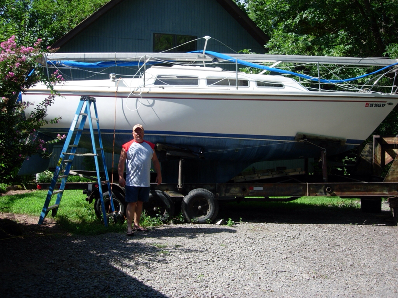

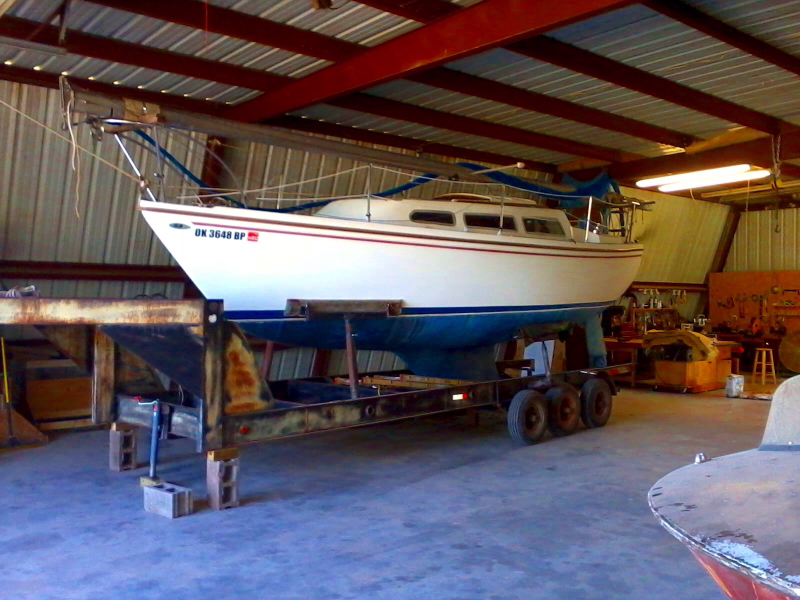

Here are two pics showing the boat on my trailer in the shop and a profile shot outside.
It's worth mentioning that on the trailer shown the axles are modified... They are cut and channeled...
Simply put, the bottom of the keel is below the hub centers on this trailer

I think I'll be okay. The boat is coming in on a custom hydraulic trailer than can drop down quite a bit. I was on a job yesterday with the same company and trailer. I wish I'd thought to take some measurements. I'll be at the boat Tuesday morning. I think I'll measure it and then stop by the hauler to measure the trailer height at it's lowest. Better safe than screwed.
