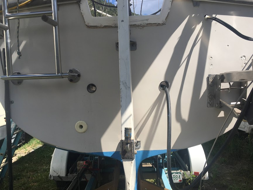

Water will only leak back out if the leak point is at a low spot. It’s more often that a leak would be higher up, and the water just runs down into the bilge and sits there.

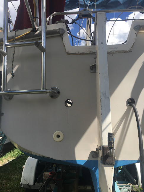

The wood access panels are screwed to the floor. It has the retractable keel. I sponged out about 20 gallons of water yesterday. The only spot I found on the hull that would/could have let water in is a small hole in the aft of the boat below the cockpit drain holes (see pic). Is this hole supposed to be there, or did a previous owner put it there? It seems a little low for a bilge exhaust.

Check for a loose rudder gudgeon. My 25 leaked there when underway and the water rose at the stern. Took on quite a bit of water during the course of an afternoon race.
