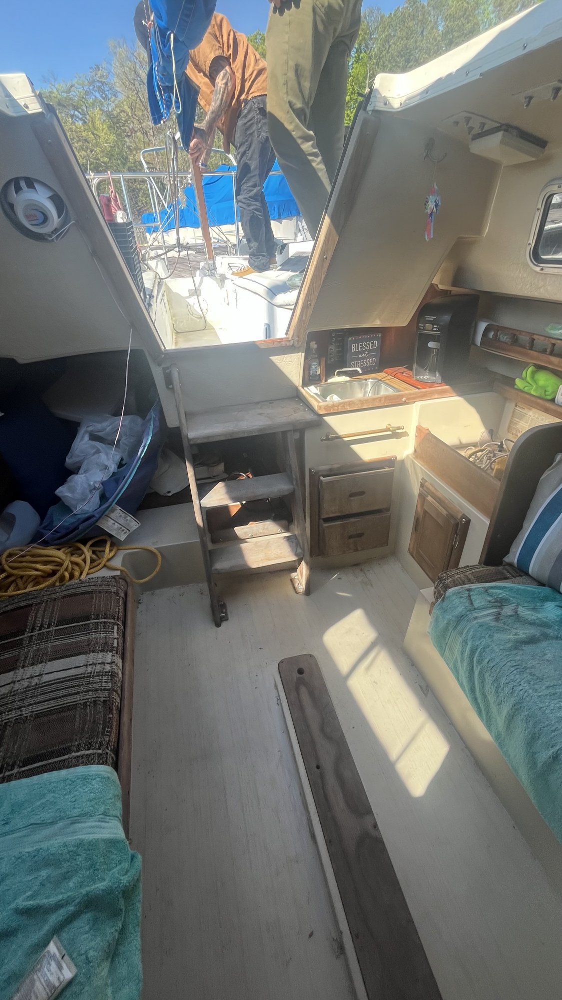

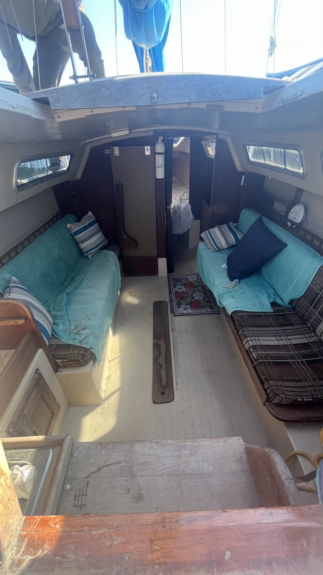

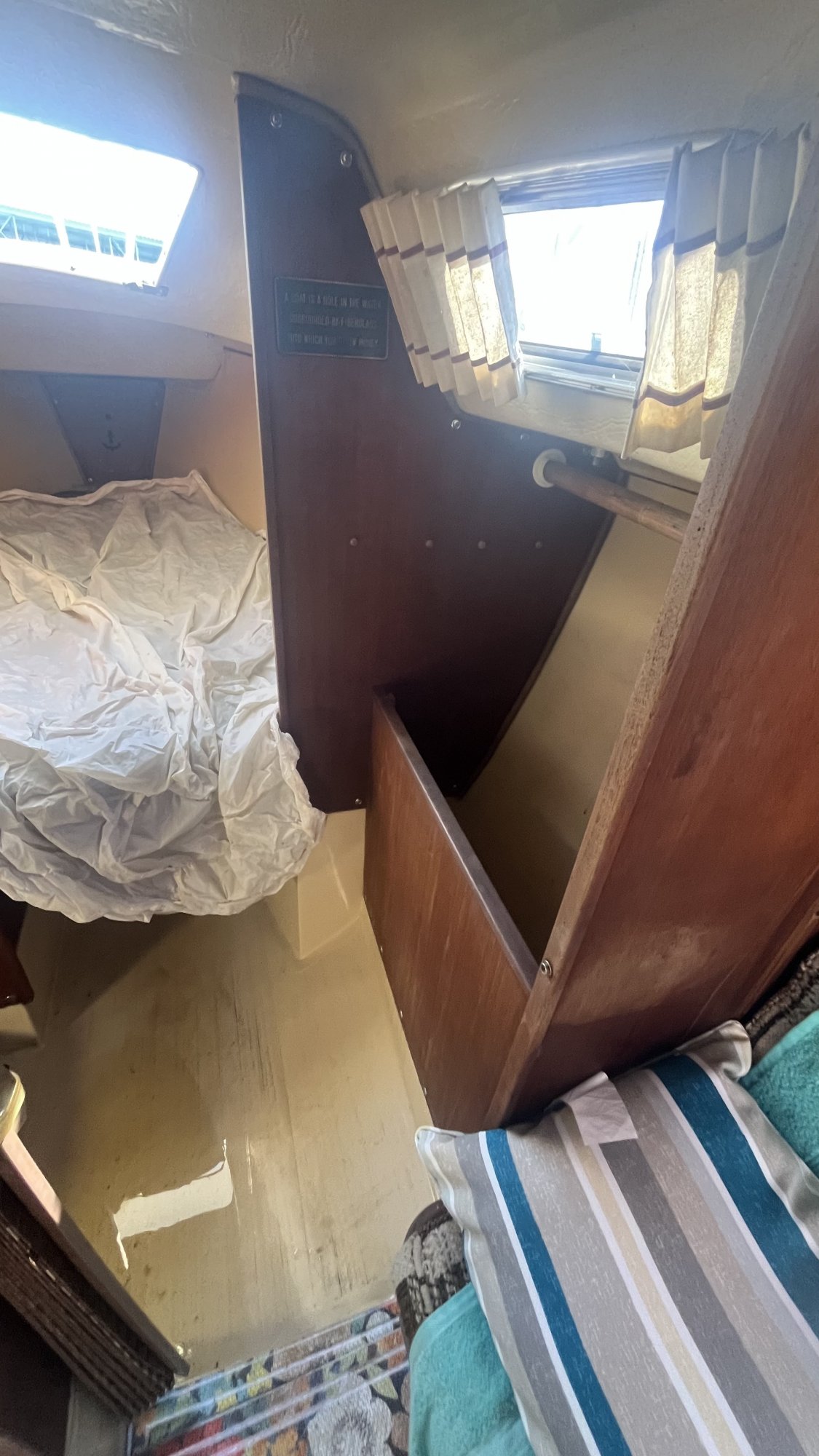

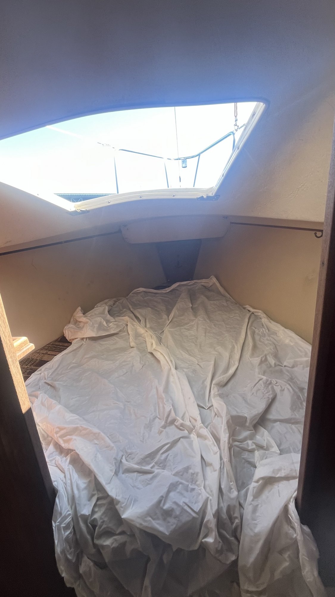

Good evening all sailors and boat owners,

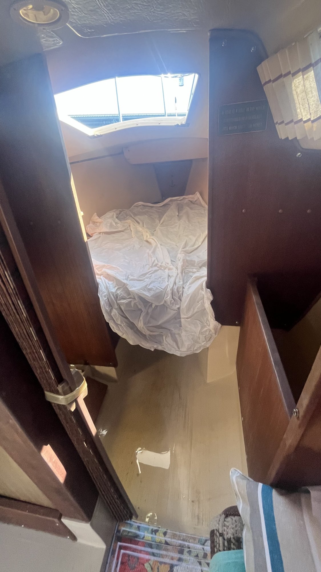

Me and my boyfriend recently bought a Catalina 25 1981. It’s been sitting for the past 5 years at one dock location and we took it out yesterday. I have no sailboat experience but, my boyfriend does.It did great and is a wonderful boat. We are looking to live on it.
I was curious if there were any tips anyone could give for new sail boat owners. If there were any ways we could clean the inside that would be helpful. If there’s any websites or places we can go to, to get new stuff for the boat for cheap. We are looking to replace the cushions, put curtains in there, get a toilet in there some how, get some new flooring maybe, clean up the whole thing. It’s pretty dusty on the inside because the boat hasn’t been touched. There is a leak in the front hatch. We were also wondering how we could replace that. If anyone could help us out with some tips that would be great. We are a young couple just starting our adventures. I was hoping that someone could help us on some tips for us to clean this thing up and make it look beautiful and nice. I have attached some pictures in hopes that it would helpful.
Thank you for your time,
Have a great day. From, us to you.

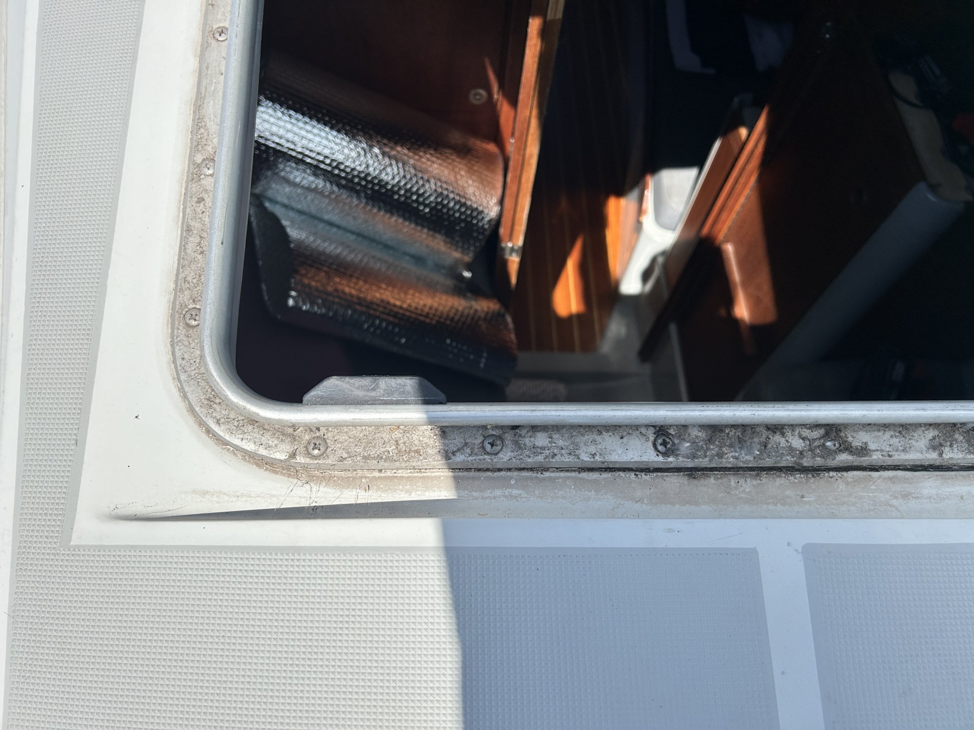

You will want to also make sure the water and waste tanks are emptied and the water tanks cleaned / disinfected if you plan to use them. This usually involved a bleach and water solution mixed in the ester tank, and then open all of the faucets to get the solution in the water lines. Then let it sit for a day. Then drain the bleach solution and refill tank with water, open faucets to rinse out lines…repeat as necessary to get the bleach smell/taste out of the water tank. If the tank has an inspection port (I added mine), you can also wipe the tank out and get any residue out of the tank.

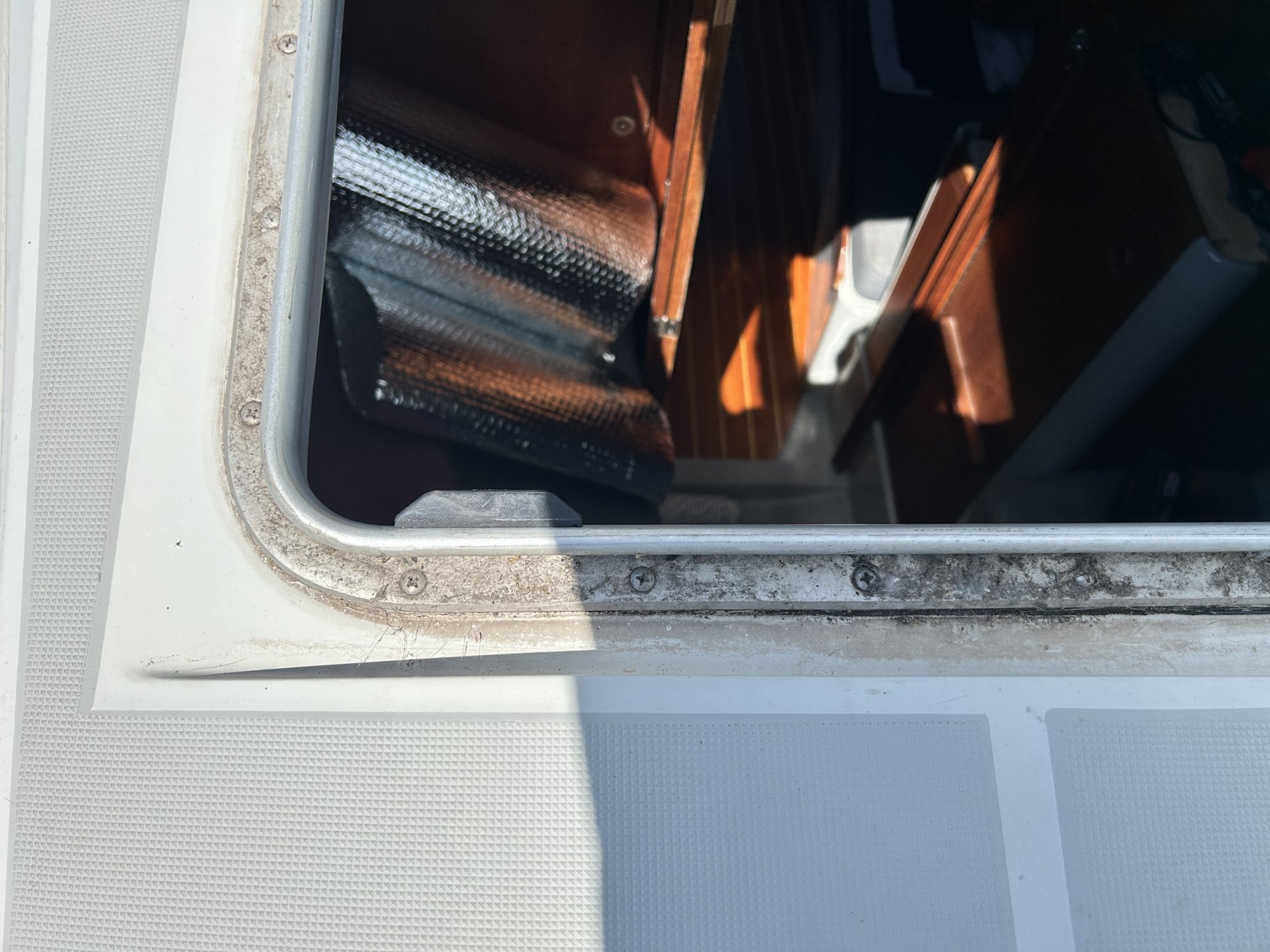

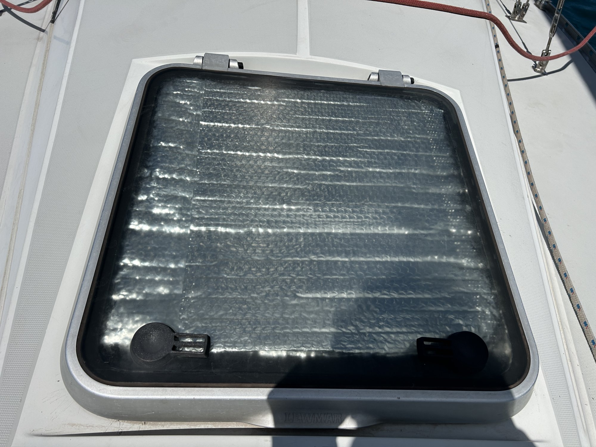

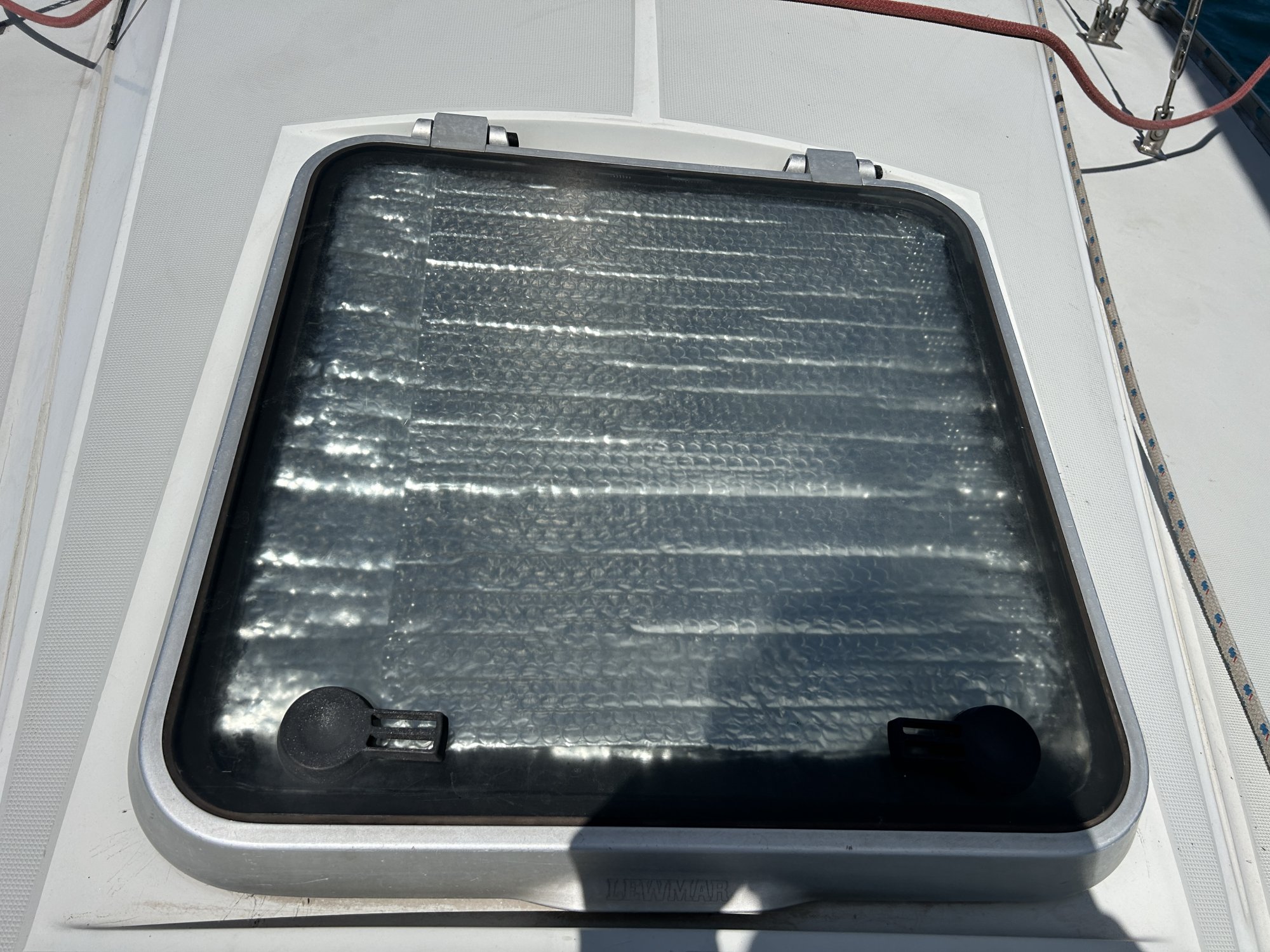

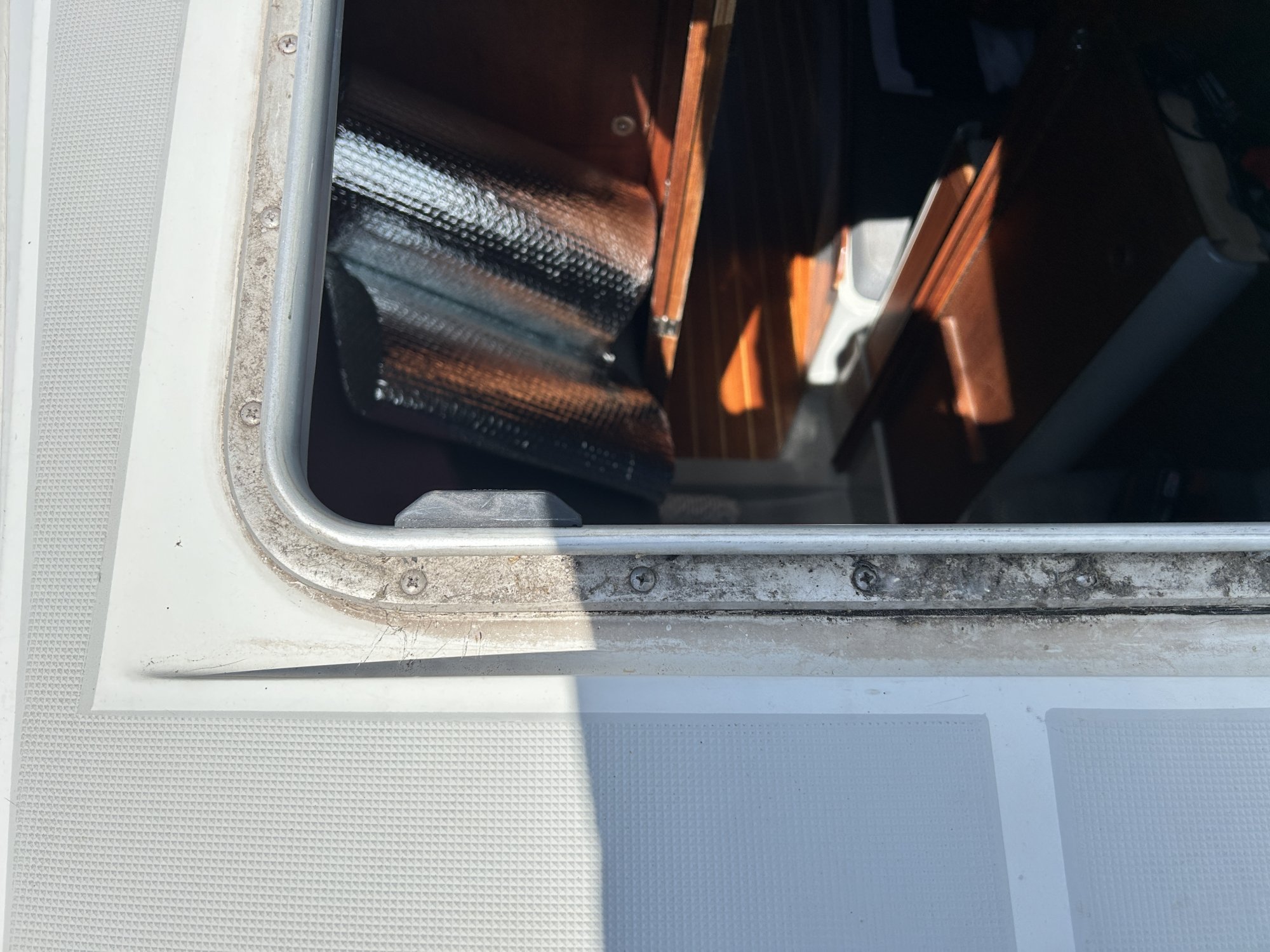

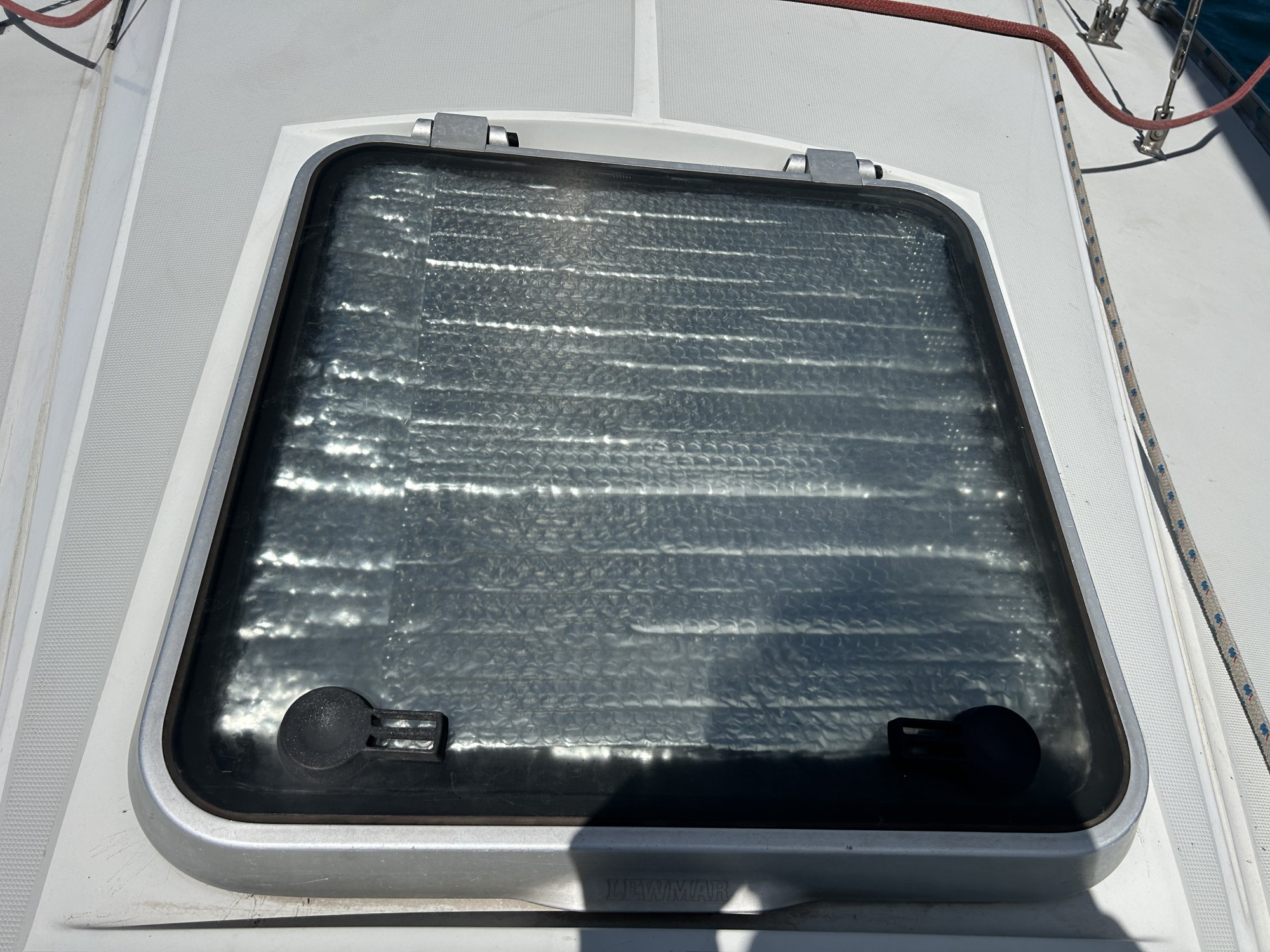

For the leaky hatch, you need to figure out if it leaking around the flange (the part screwed down to the deck) or around the lens (the part that opens). If the flange is leaking, it will need to be rebed (removed and new sealant put down, then rescue it). If the lens it leaking, that is harder to fix. The lens can be removed and resealed into whatever frame it sits in…but more difficult). If no rain in the forecast, use a garden hose and spray the hatch while someone watches inside to see where the water gets in).
This shows the frame on my forward hatch…
And this shows the lens…

Looks like what you have is called the traditional layout of the Catalina 25. I think there should be a small room on the port side just behind the Vee berth that had the original head. Probably had a porta potti. I installed a Thetford 365 in one of my boats years ago. That unit came with an optional method to hook up to a deck pump-out. But the boat I had at that time had a deck pump-out already installed so I could just hook it up to the unit. If you don't have a deck pump out connector, you'd want to install one and that can be a bit of work. Without that, while very inexpensive, they can be a real pain as you have to carry your waste out through the boat and to a dump location - not so easy to do or to find a dump station for that kind of waste disposal near a marina. Plus porta potties tend to stink... There all all sorts of products used to minimize the odor, but they still stink... Depends upon your tolerance.
On my current boat, I run composting heads. I find them much nicer to use, care for and do not have odors. Amazingly... The model I very much like is the OGO, but it's a lot more costly than a porta potti. The OGO has a small footprint and should fix your space. I have the Origin model. They also now make a smaller head than I have called the Nomad, it's very inexpensive but I have never tried it so don't know how well it would suite your needs. Might be too small fo two people living on the boat. You'll have to decide what you prefer. That's a small boat to try and install a traditional marine head. I would not recommend that.
If you have a decent sewing machine and know how to sew, you could make your own cushions. A heavy duty sewing machine is needed, and preferably one with what's called a "walking foot. But it you have a decent sewing machine it will work. When you take your cushion covers off, check for mold and/or if the current foam is breaking down. If you rub it and small particles are coming off - you'll probably want to replace them. If it has mold, probably want to replace it. Use the existing cushions as models to cut to shape the new foam. They will have kind of funky shape likely, especially the Vee birth cushions. A cheap electric knife often found at yard sales works well to cut foam. If you don't own one or can't find one, you can take a straight edge, push the foam down onto a hard cutting surface and cut with a razor. It takes a bit of practice. Foam is expensive. You'll have to look around for cheapest deals. I used to get it from Joann fabrics, but a lot of their stores are closing. Not sure where to find good deals on foam. Curtains are not had to make... if you know how to sew...
I would need much better photos of you leaking front hatch to give any useful advice.
Floors - marine grade plywood is very expensive. But you can use exterior grade plywood. It just has more voids than marine grade. But what you need is water resistant glue, and exterior grade plywood has that. You need to pull the current floors up and look at the underlying structure. Check for rot. Can't say a lot more until you know more. It depends upon the degree of rot - some can be fixed, sometimes you just need to rebuild. But before you build new floors, you should check out that structure. How you finish the plywood depends upon how much you can spend and what you want for looks. There are some pretty nice looking vinyl options that can be pretty inexpensive. Of course the traditional is teak and holy - that can be mimicked pretty well by much less expensive ways than buying teak and holy flooring. You'll have to let us know how much carpentry skills you have or wish to learn... You can also use outdoor carpet... The plywood base material should be sealed with epoxy.
I'm a fan of West system epoxies even though they are on the expensive side. They have a really nice system to use their products. It doesn't take very long to get the hang of using them and knowing how much to mix up. There will be a learning curve.
The rest of the interior wood work actually looks pretty good. Definitely needs some sanding and refinishing. A small orbital sander is a good tool to have. Don't get too aggressive, just get it cleaning up enough to refinish. Also, a small block hand sander - you can make one with a piece of wood - is useful to get into nooks and crannies.
Let us know more your thoughts and budget and I'm sure we can give you more... Might be easier to start asking about one project at a time.
