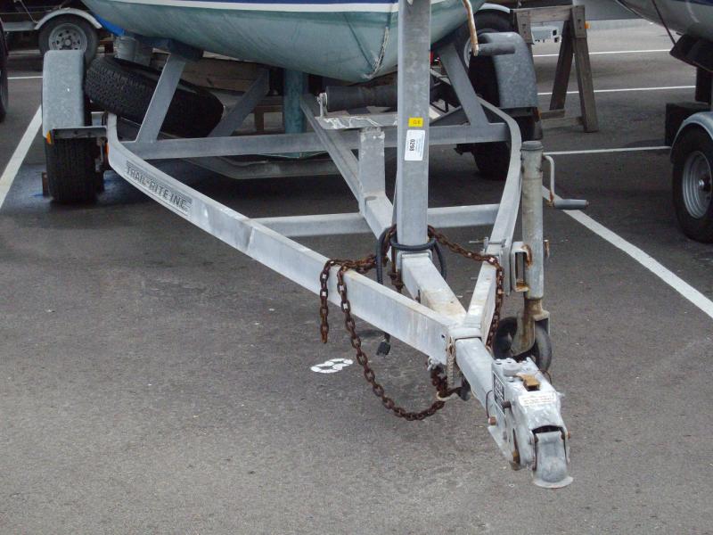

In the photos attached, you can see on the trailer for our wing keel version, the boat sits pretty low with the drop in the cross members on the frame and the drop axle. There is probably not much difference in the height of the boats waterline from a swing keel boat. We normally launch with a crane at the club, so we enjoy the best of both worlds.

Just for the record Don, this trailer may put this wing keel hull lower to the water than many swing keel trailers. I think that mine rides higher because it has a straight axle.
