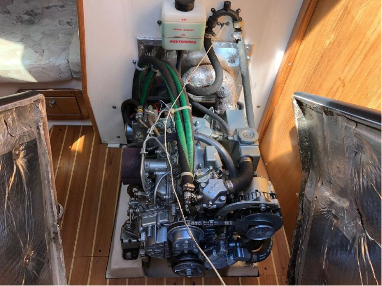

Check the engine type and transmission type. The C-310 has a variety of engines and transmissions installed. The Universal M-25 is a solid performer. The Hurth transmission, not so much. There is lots of information on the Hurth transmission on this site. Failure can be expected anytime after 500 hours.
I've been sailing Amazing Grace for six years and love the boat. Lots of room in the cockpit and plenty of room below for a couple. Go for it and have fun while you can!
Thank you KZW! I'll take a look at the transmission. I know the engine is a Universal, M25XPB, 26 HP, direct drive with 350 hours. Here's a pic from the listing. From the pic, can anyone tell if I'll have to do the exhaust mod I started to read something about in John's (JRT) thread last night?
KZW, I'm still running the M-25XPB with Hurth transmission at 2,500 hours. I think the key is Alignment. I fixed mine early
:plus:Mine is working fine at 1,800 hours. I think the early Hurths were OK. I have heard a lot of horror stories about the newer Hurths.

My 2003 has been great, we have 670 hrs on the motor and the records from the previous 2 owners indicate nothing but routine oil changes for it.
You engine pic looks identical to mine, considerinng both are 2003 this isn't surprising. There looks like some hoses have been replaced, look on the back side and underside of the radiator (that is the tank on the right side of the engine with a radiator cap) if those 2 hoses are painted then they are original and should be on the list to replace. there is crackcase breather hose to the airfilter, that is still painted but doesn't really matter.
The exhast hose is the hump on the bulkhead wraped in foil tape in front of a foil heat shield. This is the same on mine, I want to do the same mode Jese did but the reality is our motoring is very limited to less then an hour or so each time we go on the lake. If I was planning long trips and moving the boat to say the gulf I would do the bulkhead change Jese did before leaving.
