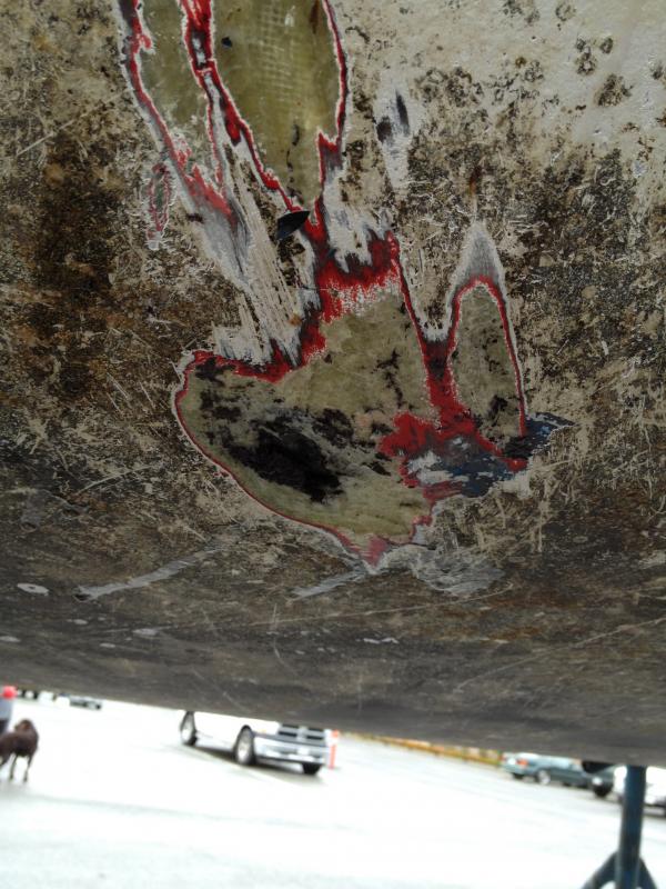

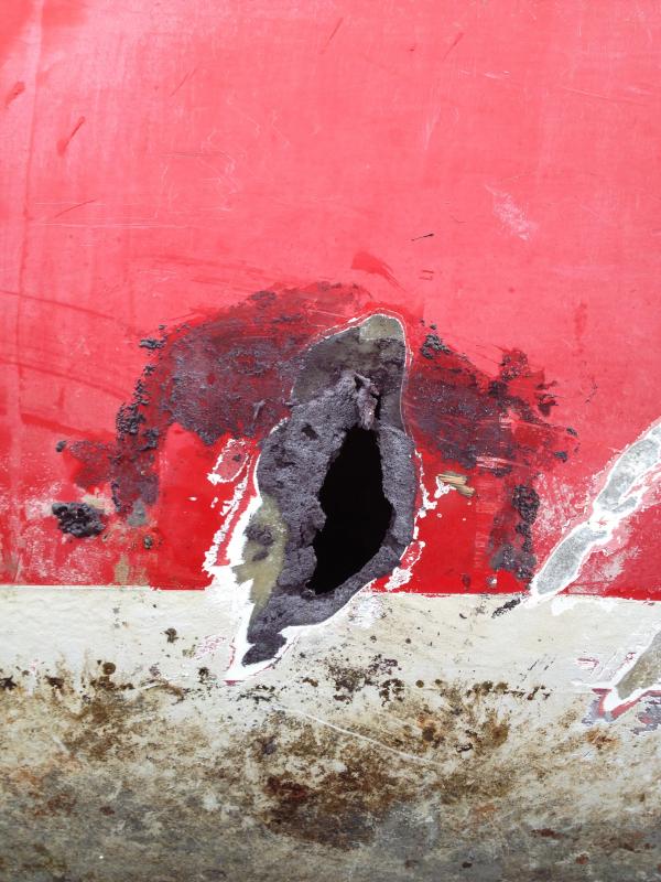

Step 2: We spend a few days (while we were cleaning it) searching for holes. We found 2 out of the 3 that were present. We patched the largest one, but weren't able to patch the other. It was only about the size of quarter, so the damage was minimal. Unbeknownst to us, the largest hole was under the boat and we weren't able to even able to find it until we got the boat out of the water. We then rented a 2 inch pump and began making plans to get it off the rocks.

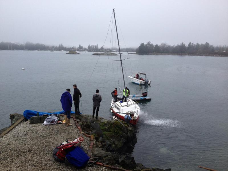

Step 3: At high tide we tried unsuccessfully to get it afloat..twice.. The problem was that the swing keel was acting like a barb preventing us from towing it out until it was completely clear of the rocks. That being said, on the third attempt we were successful in getting it high enough above the water that we were able to tow it out.

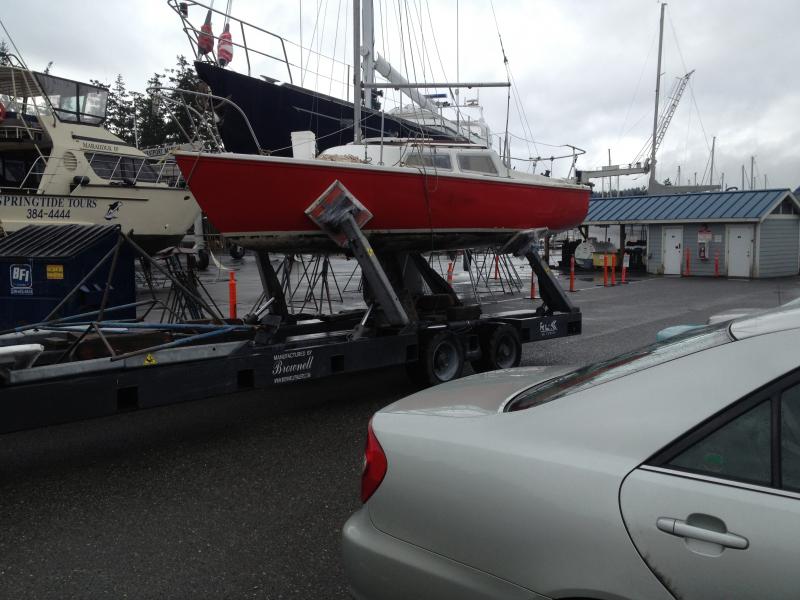

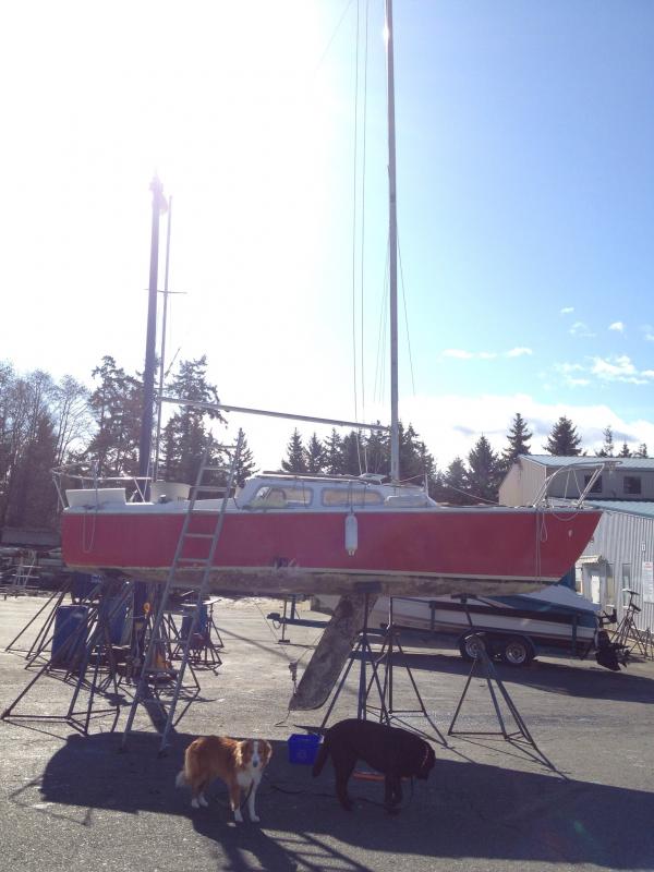

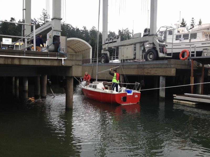

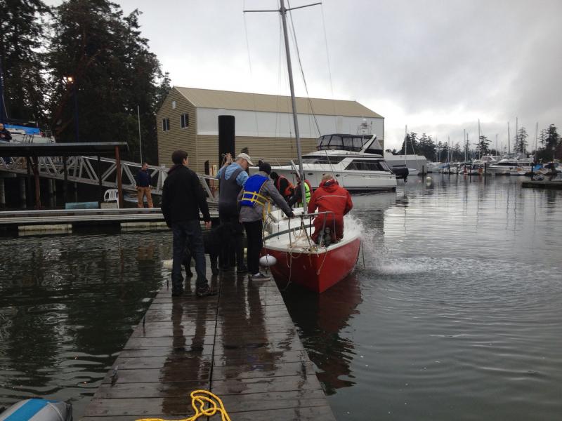

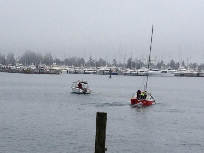

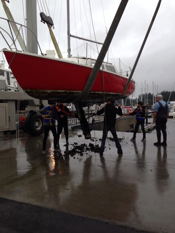

With the pump running the entire time, we towed the the Catalina into a nearby marina where it was taken out of the water and placed on 'stilts', this is where it sits today.

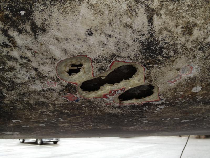

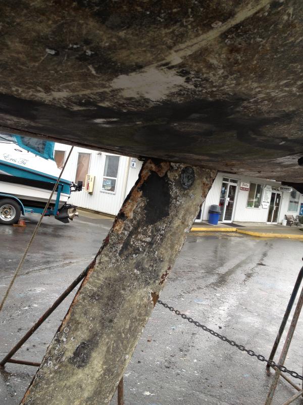

This was our first chance to really see the holes that were in the boat. I must say, if I had known that there was a third 'hole', I would have been very hesitant to tow it in such shallow waterways.
