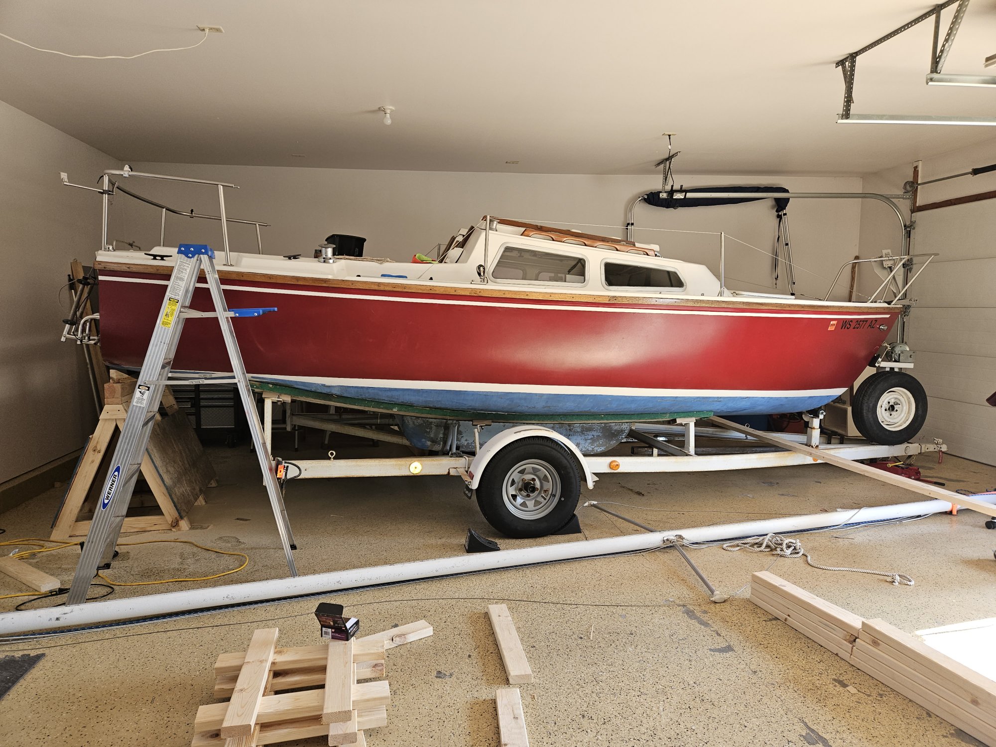

I bought the boat last fall, and decided quickly that it needed at least bottom paint as the existing stuff didn't seem to have gelcoat underneath, and was about 30% worn away.
This next step took some guts! I managed to get it up on blocks and off the trailer (the swing keel was un-bolted and stayed with the trailer)

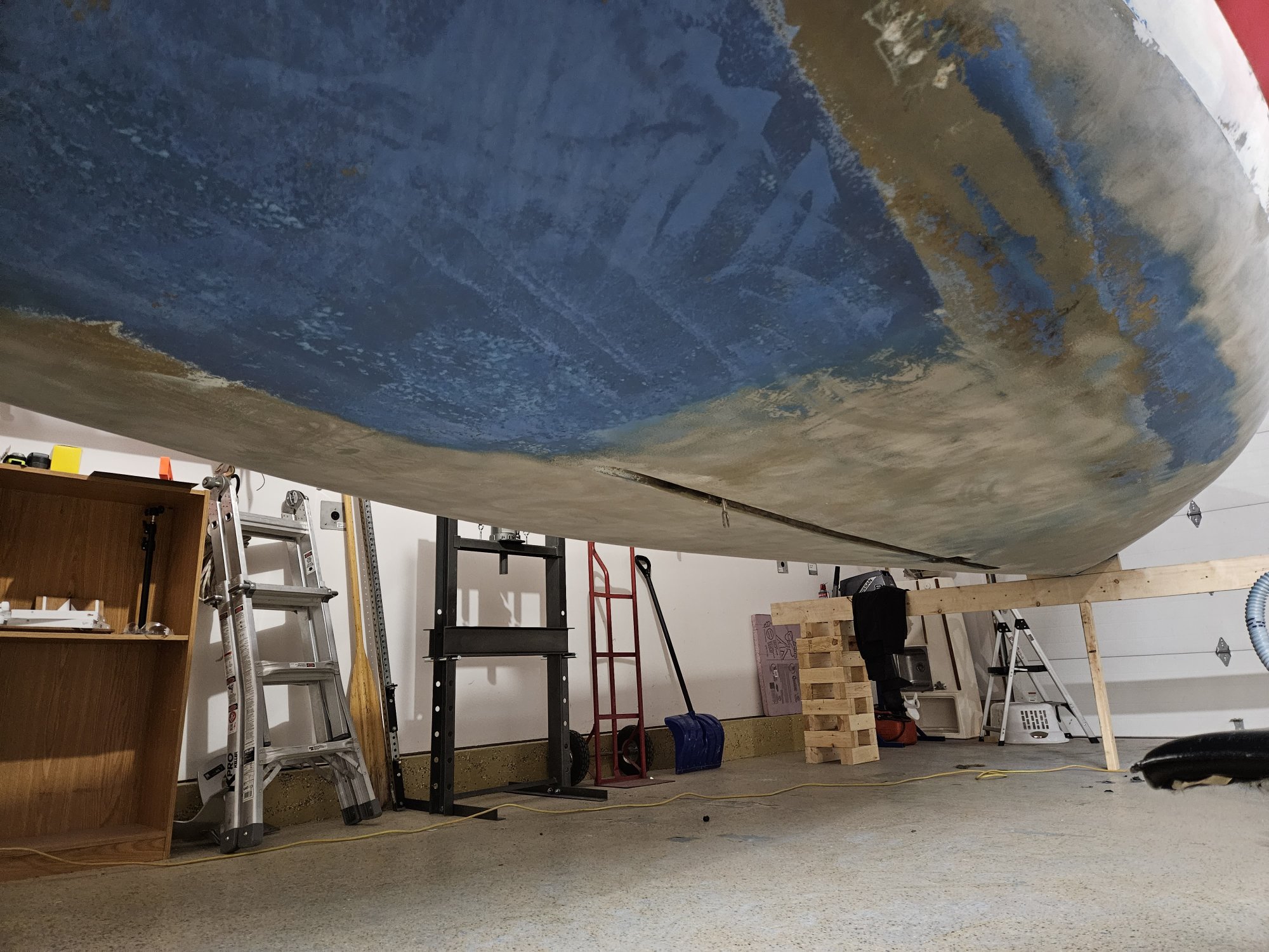

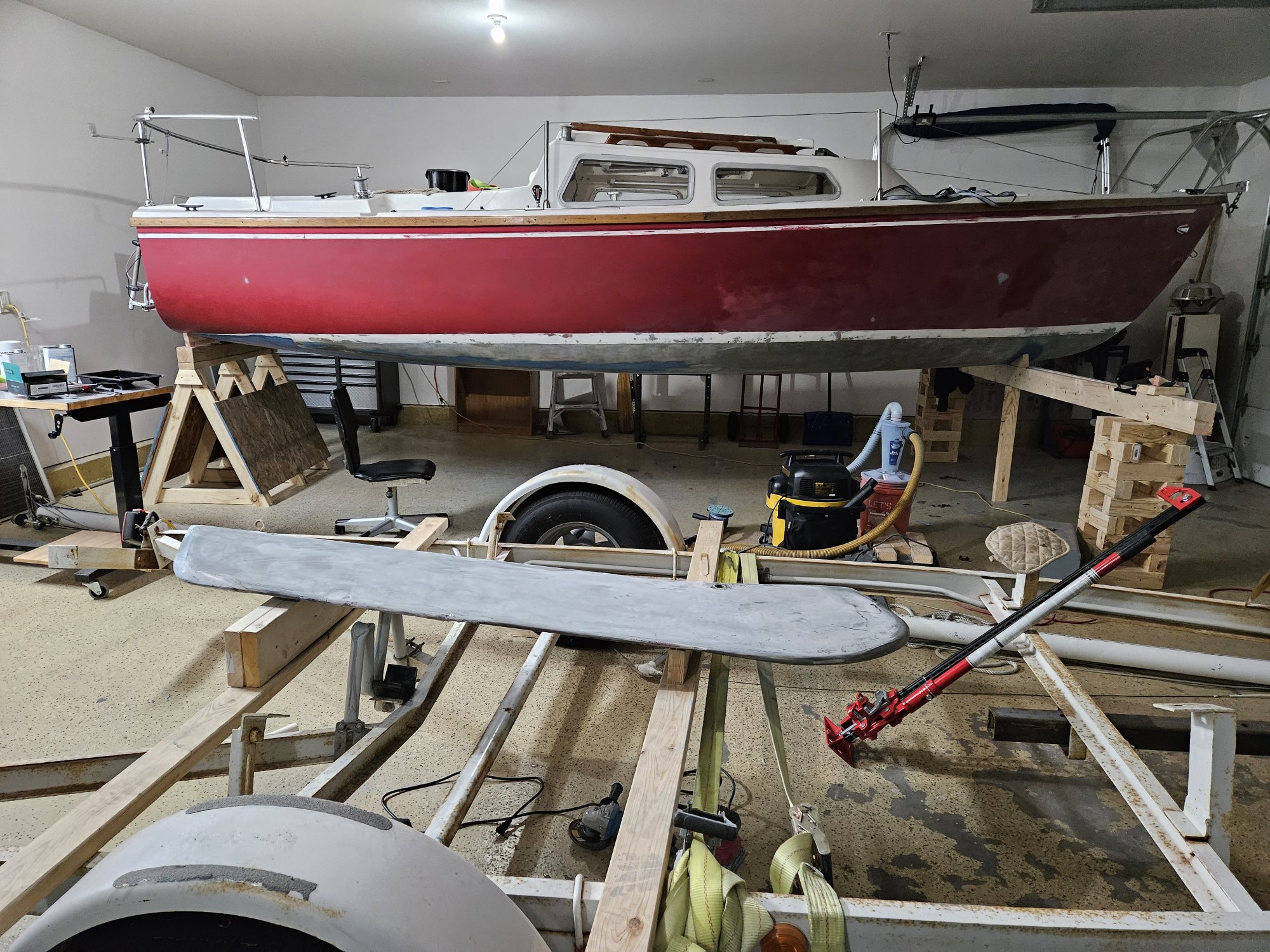

After that came the Sand-pocalypse! (note damage from bad bunk boards along top right, oof!) and also the not-painted sections around the bunk boards where the blue paint had been completely worn away from miles on the road...
as a side note: I used a cyclonic dust separator and followed the advice of BoatWorksToday, Got a sander with good dust collection capabilities, and it was absolutely worth the investment. If you're thinking of doing a big job like this, get the tools to do it right!

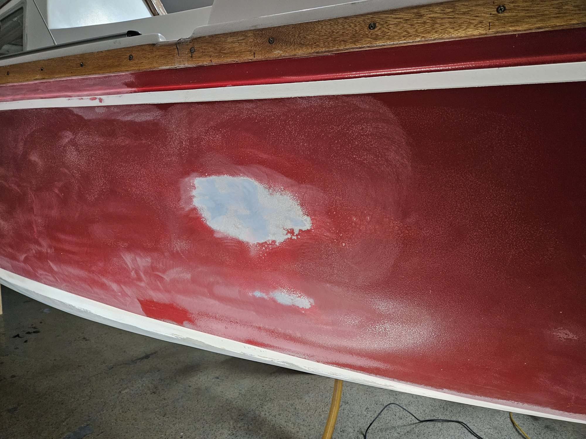

Whoever had decided to paint this boat red initially hadn't done me any favors, there were several patches like this where the paint was bubbling up and even some patches that were still gooey which apparently never correctly hardened. perhaps whoever it was didn't know how to mix epoxy, lol.

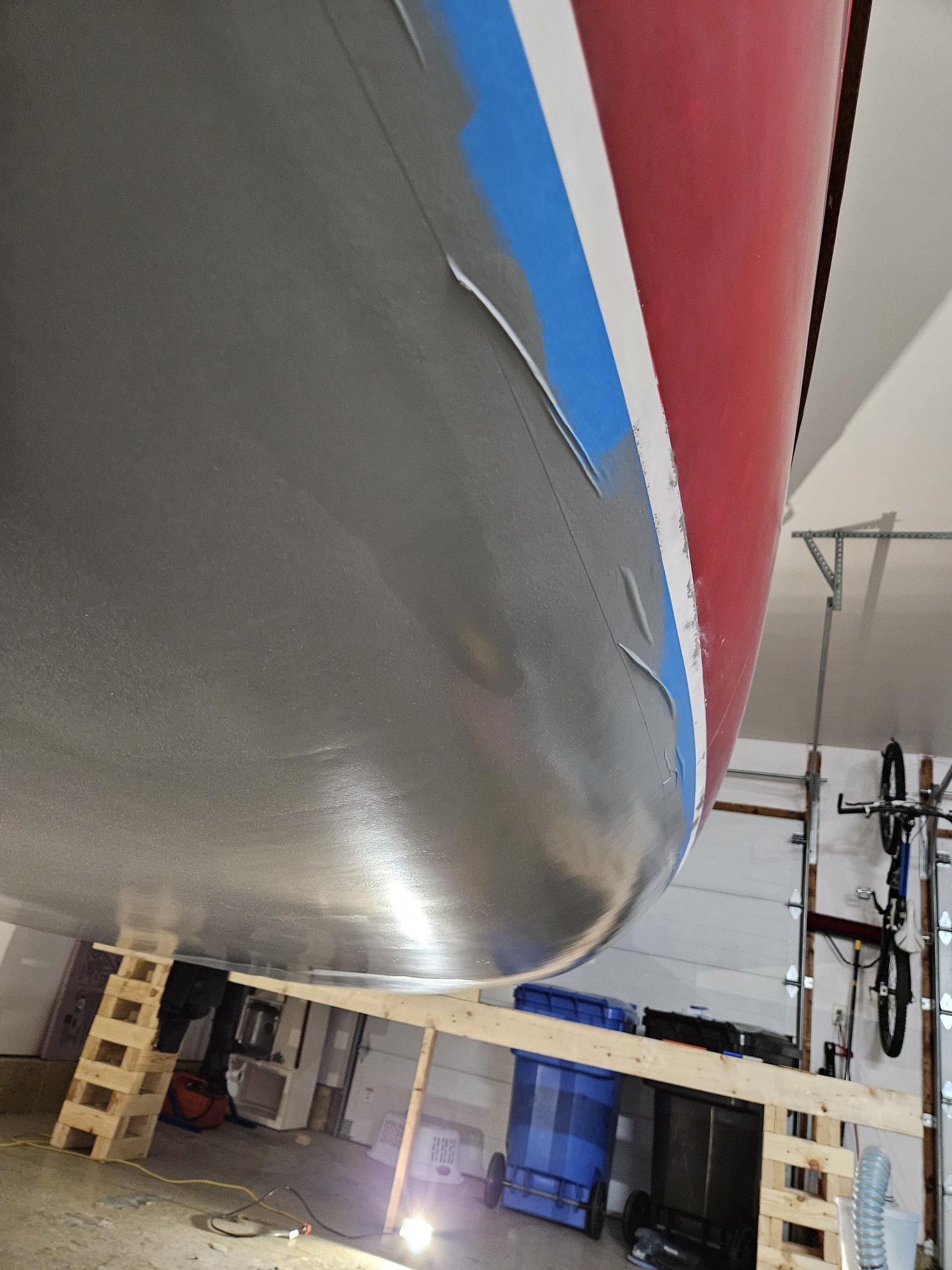

Sanding done, it was time for fresh primer, and it looks so much better already!

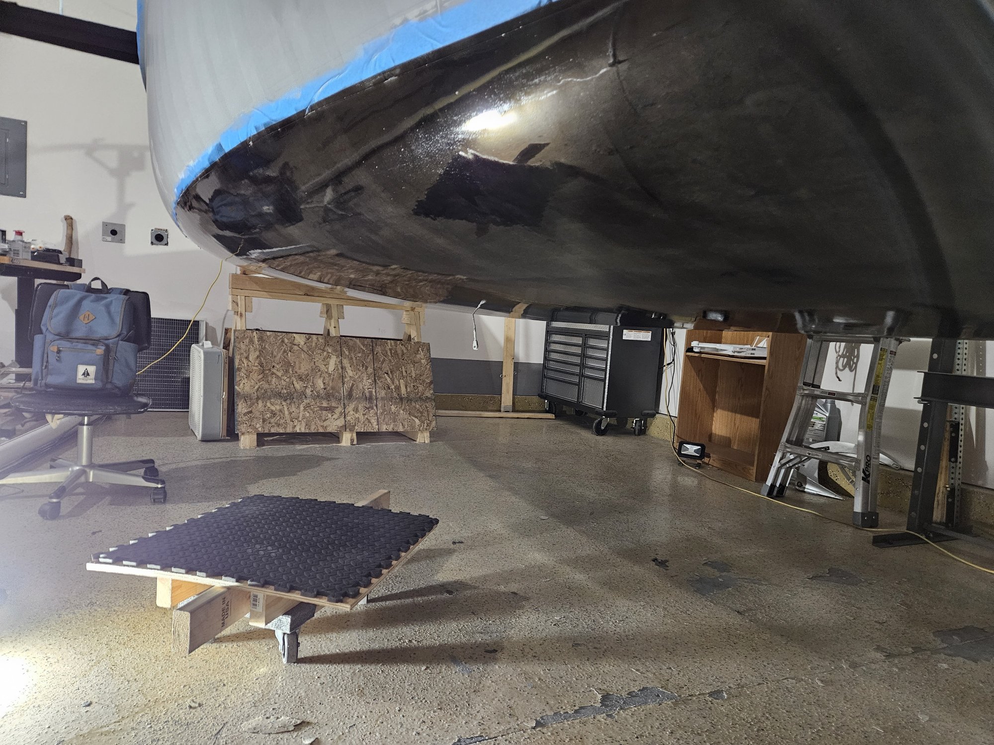

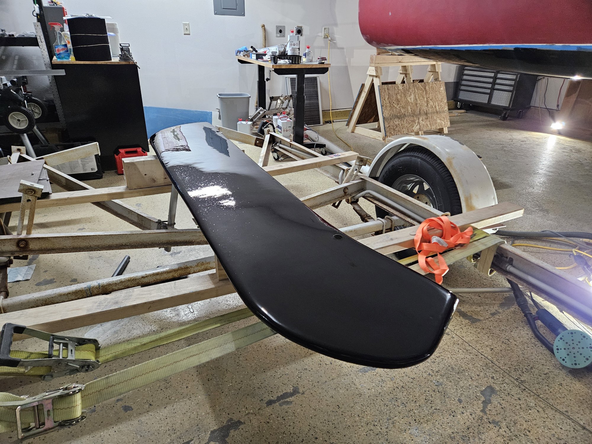

3 coats of primer later.. and the black goes on! I decided to put black paint below the waterline. According to the internet, this is a bold choice.. but the black paint did just fine.. and I think it's got a better finish than the topside paint..

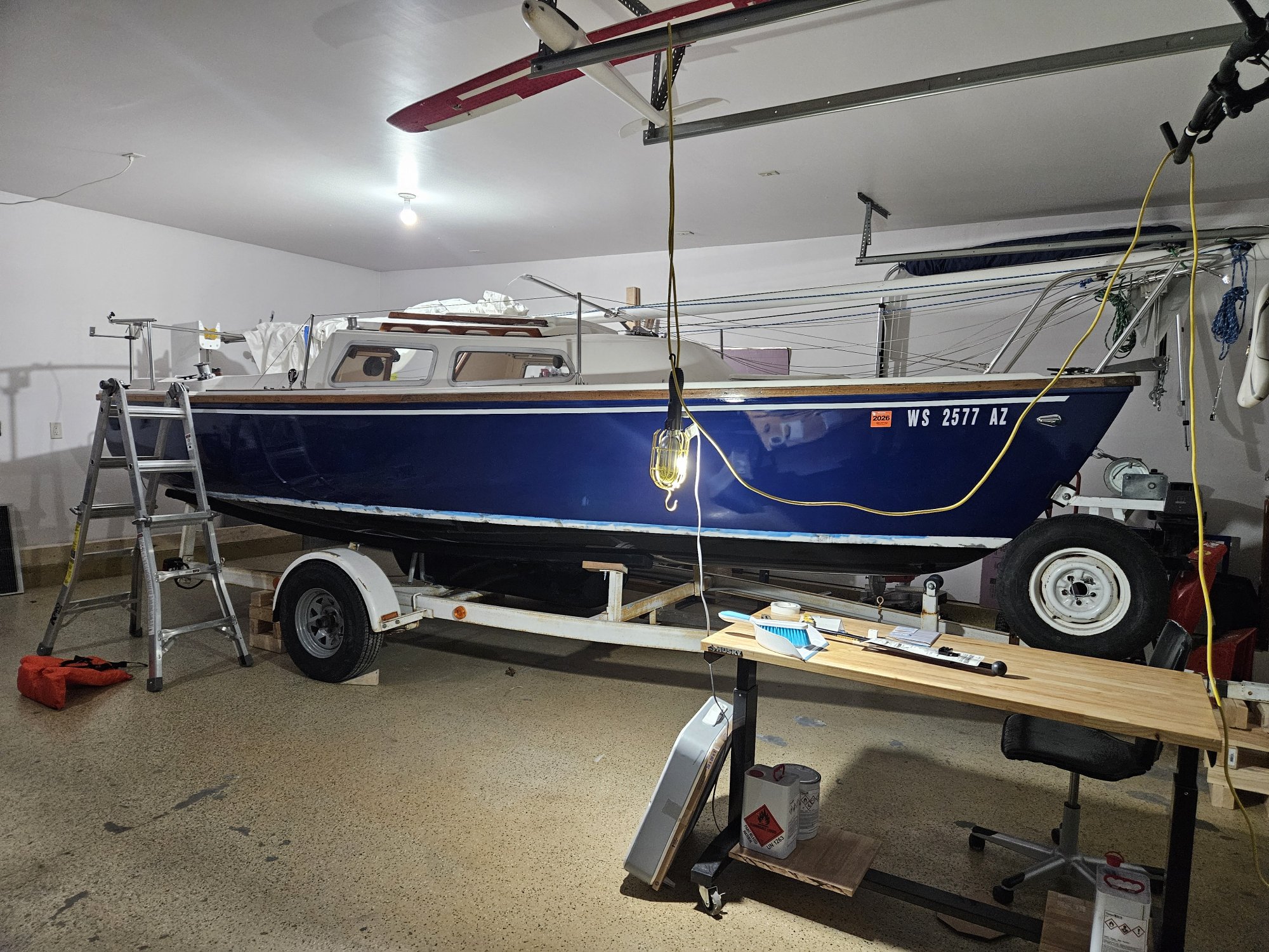

ended up doing about 4 coats of black, and at the same time I started on the top-sides. this was around early Jan. I'm glad I gave myself the whole winter to get this project done... given that i'm working at the speed of "distracted adult" :)

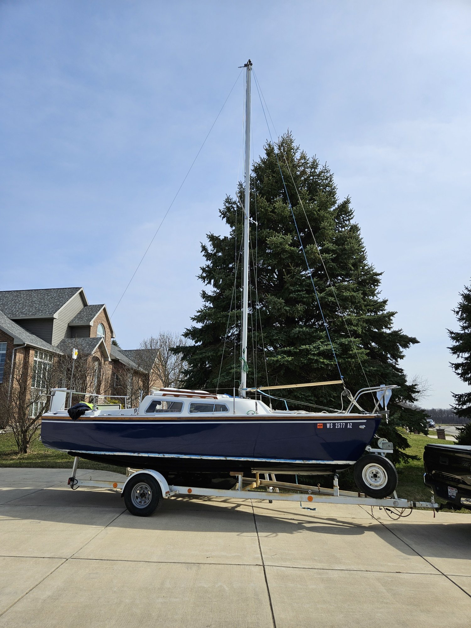

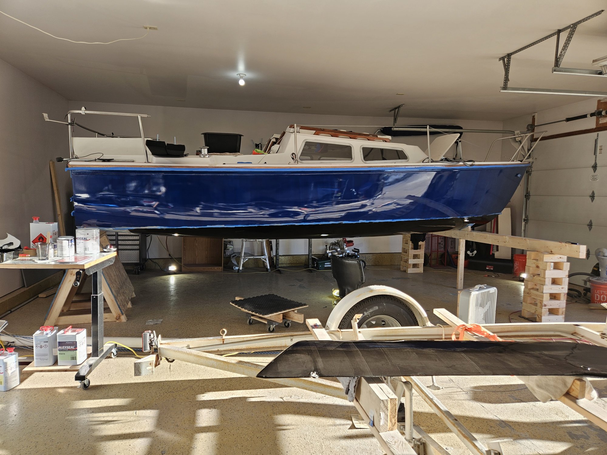

Also, Surprise! it's blue now! Honestly, I only ended up picking this color because it's what Miller Boat Works had in-stock at the time, though I really do like it.
A few more coats of blue and she's done! (4 total) Technically, I still have yet to finalize the bootstripe... will probably put a vinyl one on for now, and see how she sits, then re-work as needed next winter. She was a little stern heavy IMO, and i'm planning to move some weight around to try and correct it.

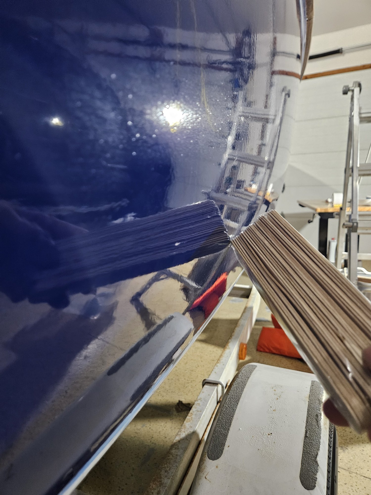

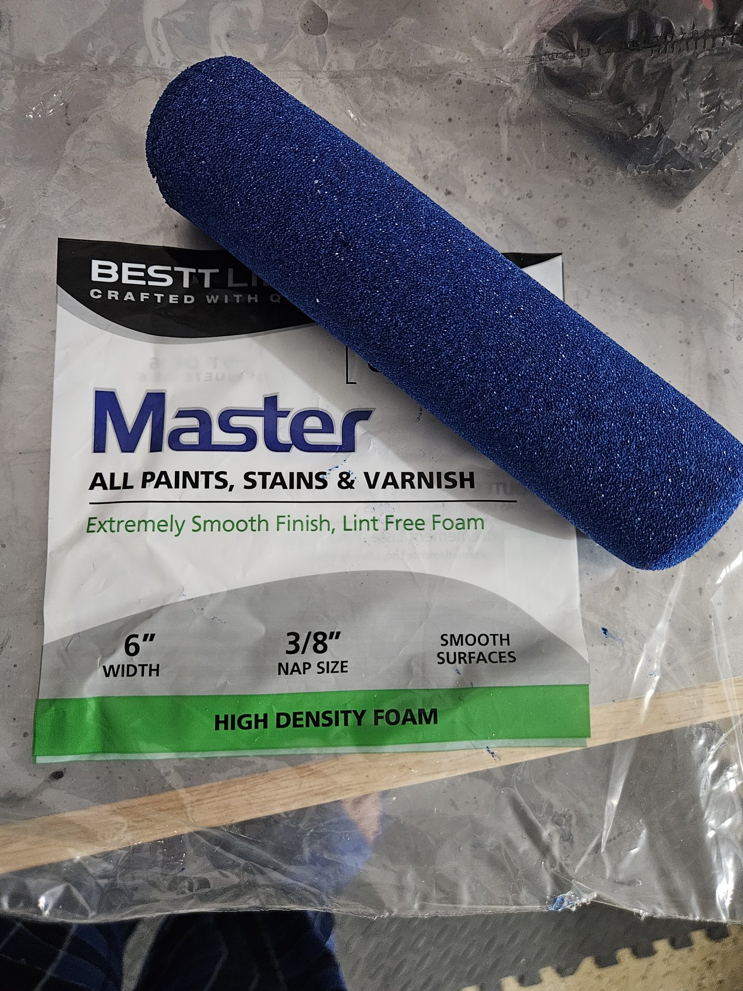

What kind of nap did the roller have? Any chance you could grab a close up pic of the paint texture, if there is any?

Here's a picture of the roller (post use) it's normally white foam.
The texture is tough to get but i did my best... and I think a round of light sanding and one more coat would remove nearly all of it.
I took more time on the bottom, and that came out a little better.

they say in a Boatworks video to never use a wooll / nap type roller. ' the fibers will stick in your paint and you will be unhappy.'

Yeah, I tried the synthetic hair/fuzz type rollers, and they are okay, but I ended up settling on the foam ones because they don't leave any lint. The surface texture the roller leaves doesn't really matter, as the paint flows out pretty well if mixed right.
