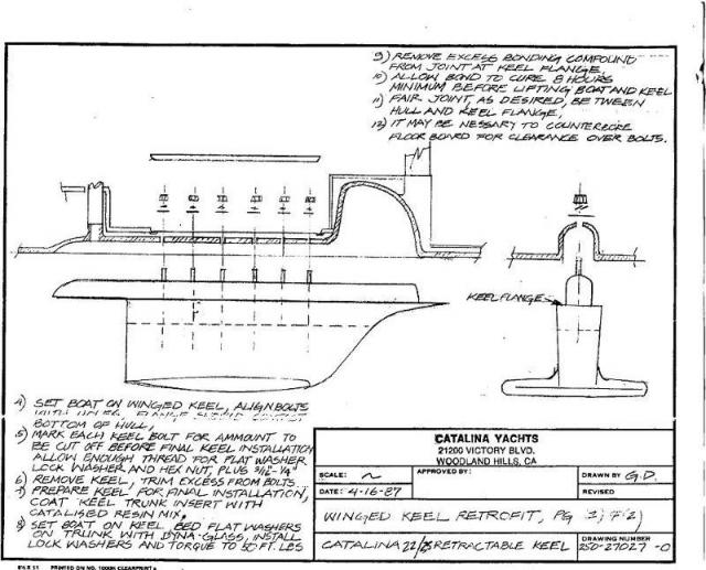

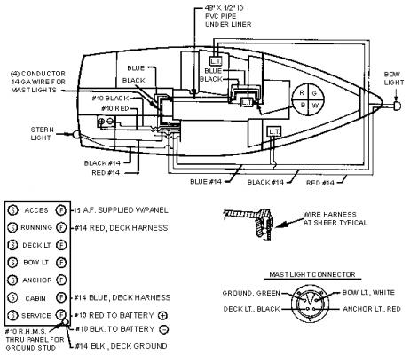

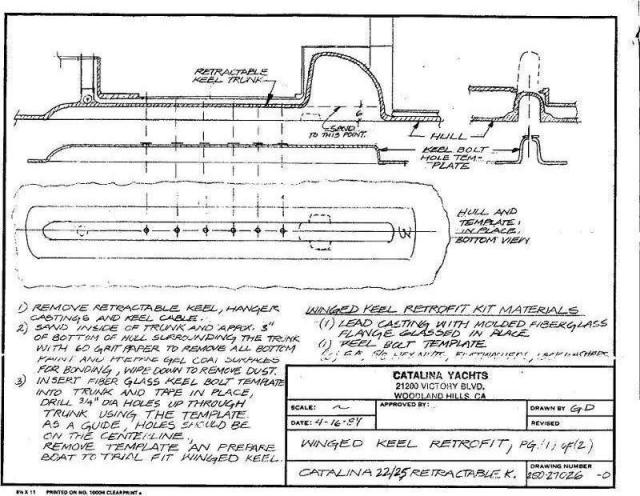

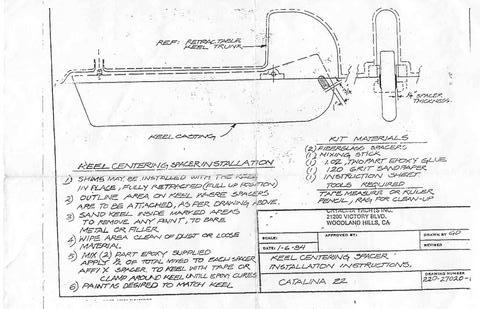

Ok as promised, here are the line drawing I have for the Catalina 22, most aer of course for the old style and one is of a conversion from a swing to a wing that is no longer offered by Catalina. First set.

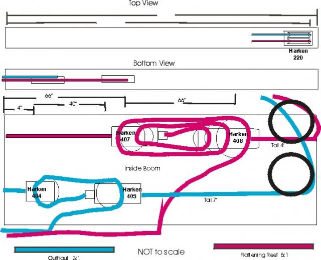

third set,
This set includes a poor drawing of my internal out-haul. It's similar to rumbrunners but I used NO rigging wire, in it's place 1/8" amsteel was used instead. You'll also notice my out-haul has a block at the forward end of the boom. A continuous line routes from port to starboard allowing the out-haul to be adjusted always on the "high" side, I single hand most of the time so everything was made "easy" for me.
