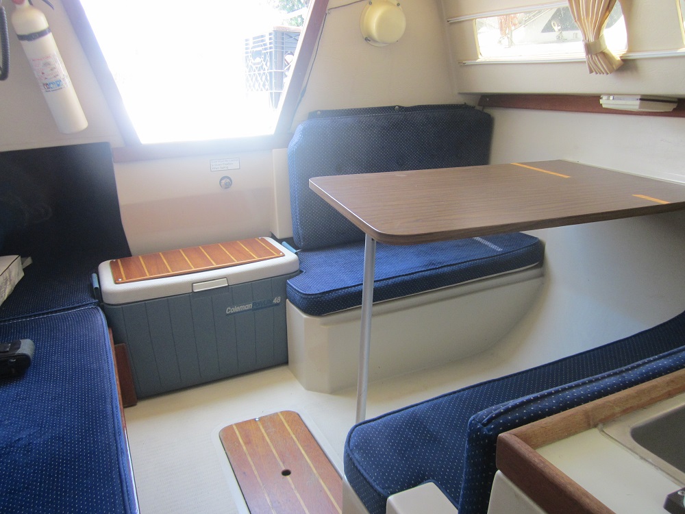

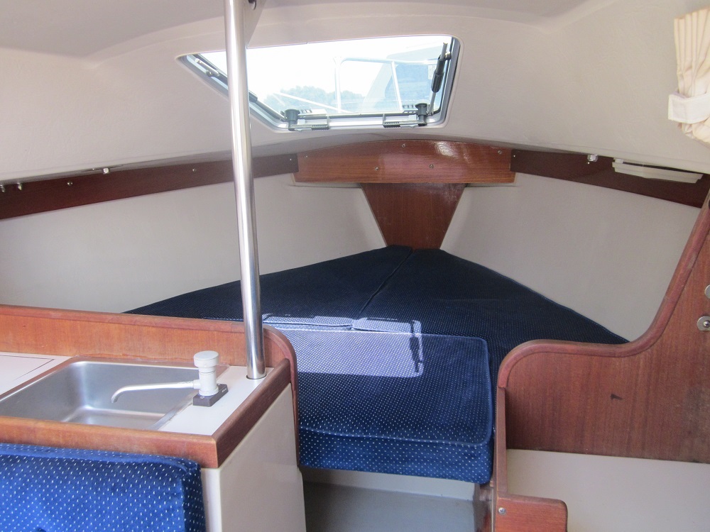

Russ, if you don't intend to race seriously, consider a "new design" C-22. They were manufactured between 1986 to 1994. Many of the issues with the original C-22 were corrected, and if you thought the V-berth was nice on a 1974 boat, you won't believe the V-berth with a HUGE opening hatch above you on the front of the taller cabin. On the newer models, the hatch has smoked glass to look out and lets more light into the cabin. The whole boat was updated in comparison to the original version. We have a MK-II, and my project boat is a 1988 "new design", and although we LOVE our MK-II, in my opinion, the new design versions are the prettiest C-22 of them all.
Don
