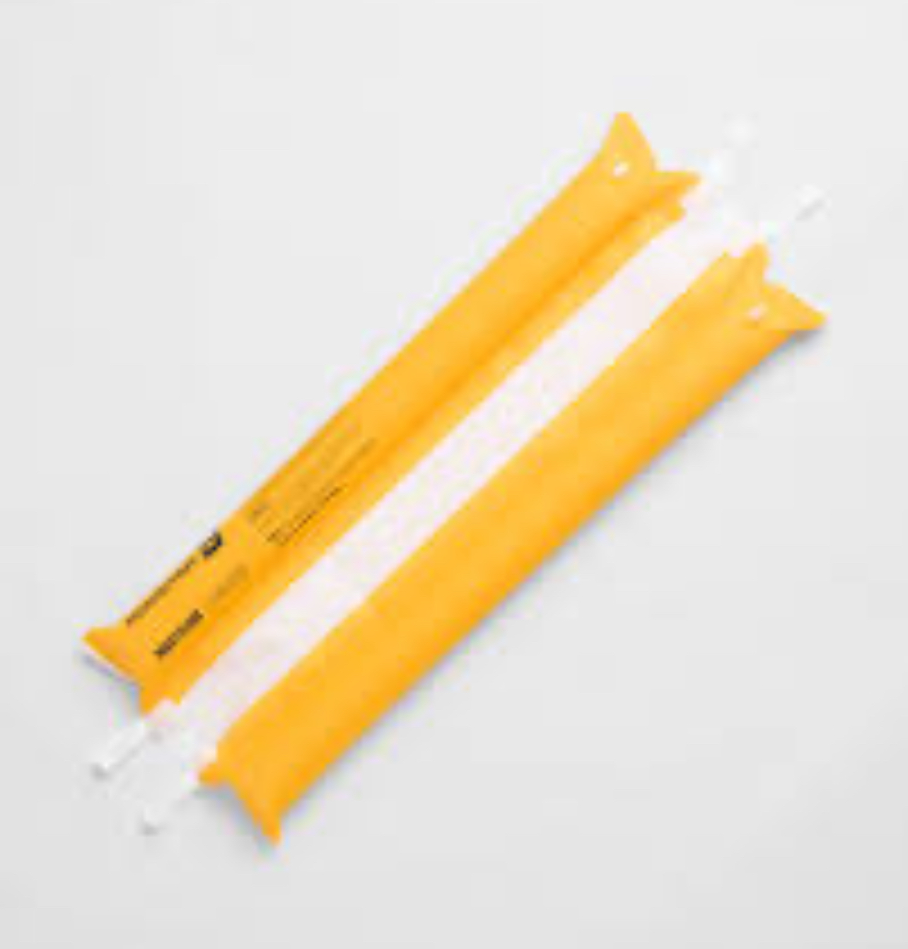

I also have a capri and I’m going to try the “yellow” set up first. I like the idea of the apparatus but don’t like the blow up air thing that a pin hole would ruin. I was going to take a larger pool noodle (@ 30” long) ( there around 4” in diameter or so, and fill the inside with a spray foam and seal ends with a good coating of silicone. Then sew a piece for Dacron up to hold them, and wrap it around the edge of the mail sail and slide it up the track in the mast. If I get a chance before it gets too cold I’ll have to test and take the boat to it at the beach and see if 2 pool noodles will float the mast end.
The second image product I like also. Price is way more reasonable than the Hobie bobs.
We tried all sorts of different schemes but ultimately ended up with the Hobie Bobs. It is the least obtrusive and ultimately most effective. We have had a dozen Bobs on boats for going on fifteen years in the end they are likely more economical than anything that will wear out and require replacement.
