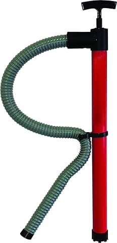

It's a 14 foot dinghy.... it's gonna get wet. As long as the water's coming in from above the waterline and not below... no problem. Why don't you acquire a small, hand held bilge pump to keep in the hold if it gets too wet. Not much you can do about water coming over the top... a single wave has a surprising amount of water. I've owned a number of small boats... they all get wet inside. That's why they have drain plugs. In fact, if you're not getting a little water in the boat you're not sailing hard enough.

Thanks Joe. The pump is a good suggestion.
