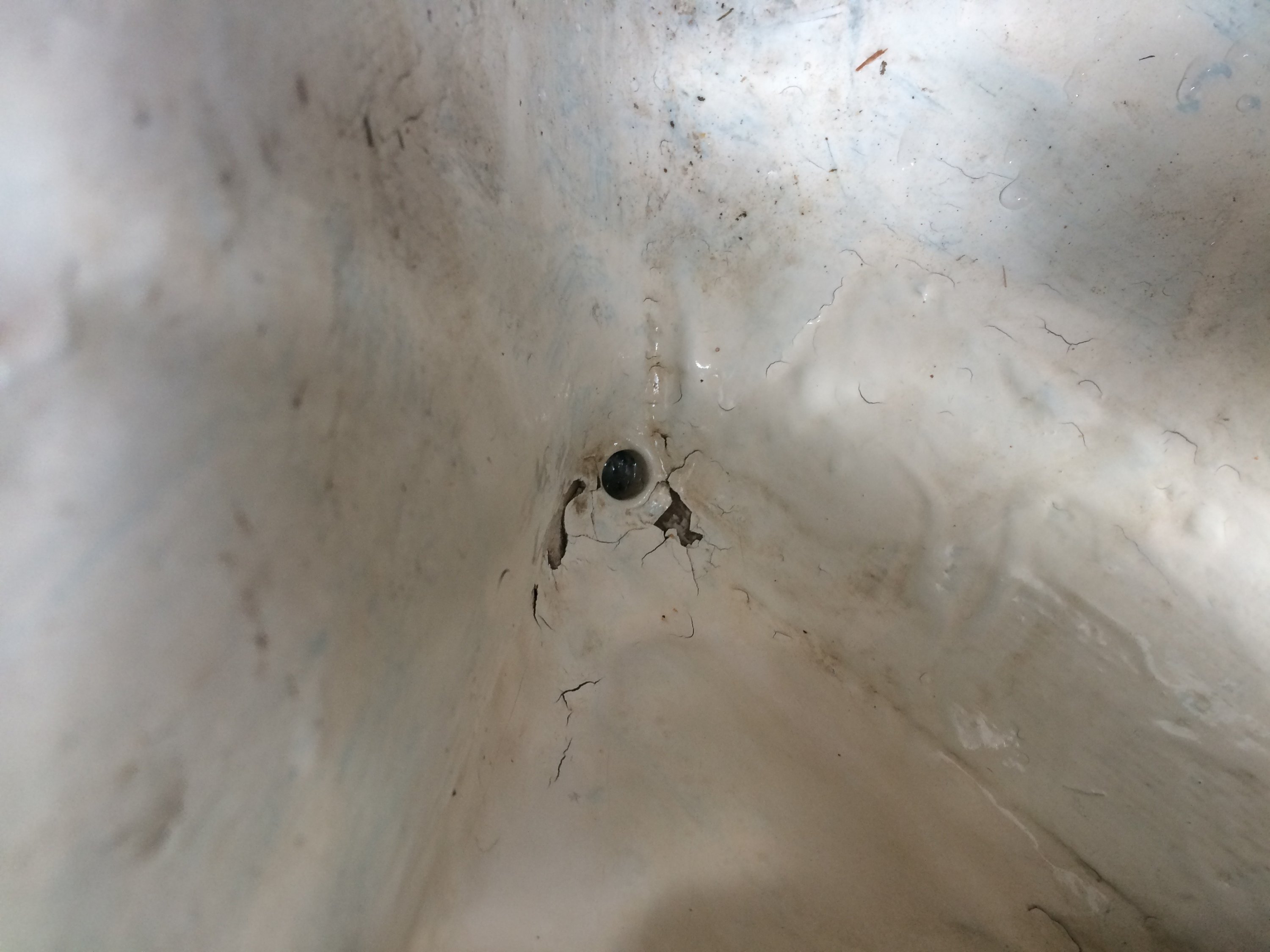

I Have a leak in my anchor locker seems to be coming mainly from where both sides of the boat meet in the bow . Has anyone had any success dealing with this problem ? Was thinking of sealing the joint where the pan meets the deck to start .Have been reading about 3m 5200 and how it reacts with moisture its definitely wet now .

Should ne a drain in bottom leading out starboard side

Looks like my locker if so it's a 1/2 copper pipe to the bow. Mine is leaking I was going to drill it out and put a new piece of pipe in there with thickened epoxy.

Thinking the same thing , just spent the afternoon at the lake not looking to bad . Have been considering a 3/4" stainless pipe flared at the entrance , copper may be a hell of lot easier .

A friend also with a Catalina 25 did just that, a 3/4 " pipe epoxied in the bow!
It works, does not get plugged up!
