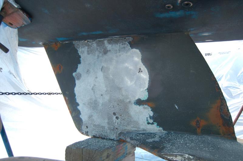

We owned our 1990 boat for about six years. It had never been properly barrier coated until last spring. We just had the bottom paint redone when the diver told us it needed it. Last spring at haul out we were advised that the rust on the keel was becoming a more serious issue, so we had it stripped and barrier coated. We were out at the same time as another Beneteau which had been properly coated when new which had only a few VERY minor spots on the keel which needed touch up.
Stripping and coating the keel did not add that much to the cost of bottom paint project, but it did add a lot of time. It's a DIRTY/NOISY/HOT job and I wouldn't want to do it myself! Painter guy tried using sanding disks (yeah, right), then hard abrasive disks (have fun!), and finally went out and bought himself a needle gun (NOW you're talking!). It still took him a couple of days to do the job, and he's used to working in a tyvec suit, inside a plastic tent… I was glad I was paying somebody else to do it, and thrilled that they didn't charge extra for the effort required!

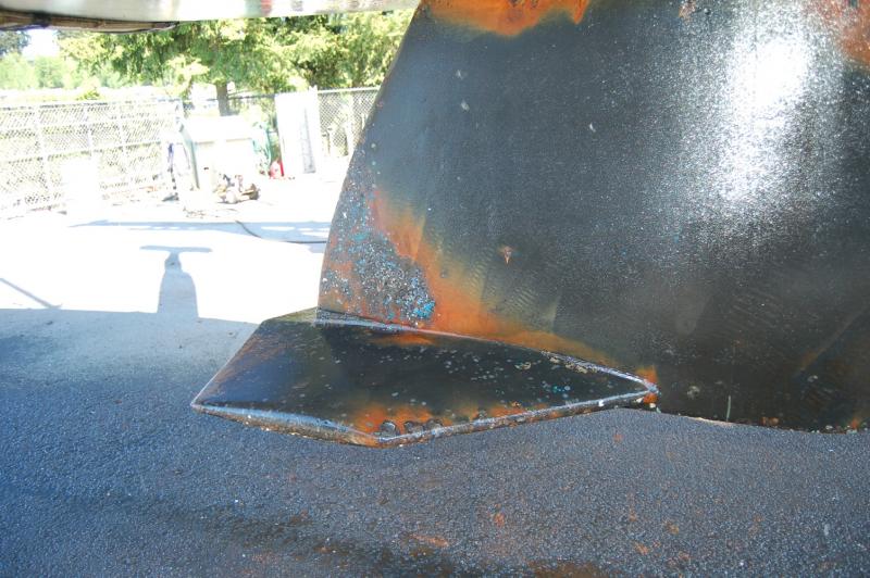

A couple of pics of our project in progress last May.
After about a half day of needle gun:
The before pic:

You are going to need to fair those pits with filler as part of your surface prep.
Gunni
Mar 16, 2010
5,937
Why bother? Is there a reason other than cosmetic?
It's your lifting foil. You need nice smooth laminar flow across your underwater foils if you want to get the speed, and pointing performance your boat is capable of.
