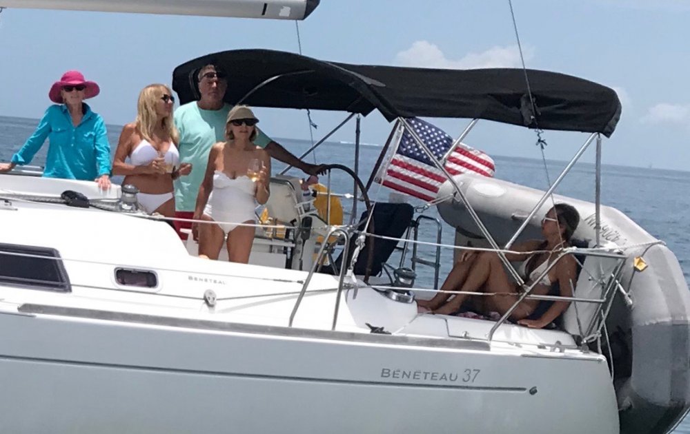

Beneteau 37 JBM, St. Clair Shores, MI
I do, using Davis Snap-Davits. Works well. Picture gives you an idea. I don't use my dinghy except I keep it handy as a lifeboat, just in case.

In what sort of waves or chop does this seem reasonable (and I understand that a range of ideas and boats are under discussion)? Every linked image shows people sailing in near flat conditions.

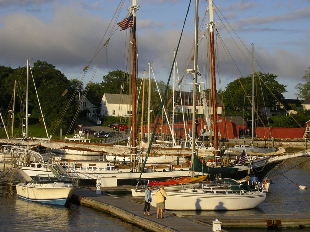

That's our Catalina 30 [09] with dinghy and two kayaks on the bow. We did tow them in single file from Portland to Camden and back.
