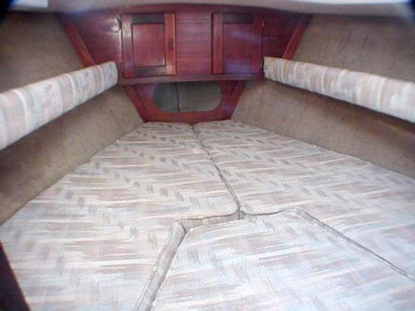

I think that drain on my H37C might be like yours Mike. I'll try to remember to look more closely when I next go see her. My carpet is not too bad, just a little tacky and it might clean up with some effort. In some of the cabinets it is falling away from the "wall". I just think it's time to spruce her up with something brighter that will clean up well. My concern is still that I will install something that will not insulate well and might not adhere to the f/g. The photo is of an '83(at Merritt Island, FL) and that does not look like carpet.
