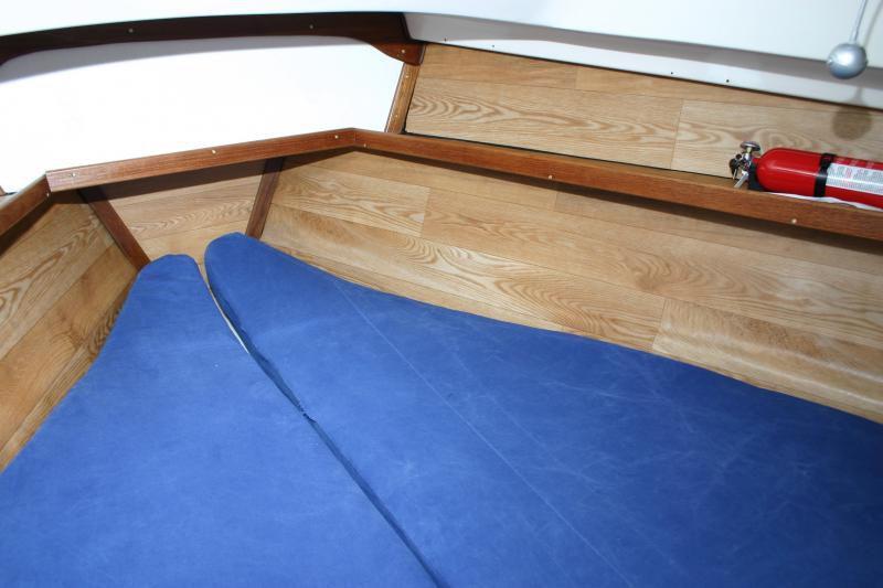

it's a messy job but well worth it
definitely wear a mask when taking off the old carpet. Also try and carefully remove the sections in one piece to use as templates for whatever material you decide to replace with. My carpet had a foam backer that was inundated with mold, that was the hardest thing to remove. I wish i had an oscillating multi-tool then, it would have made life easier. I used putty knifes and scrapers to remover the foam. I then borrowed the idea from another forum member and used vinyl flooring to replace the carpet. I'm really happy with the results and it's really easy to keep clean.
