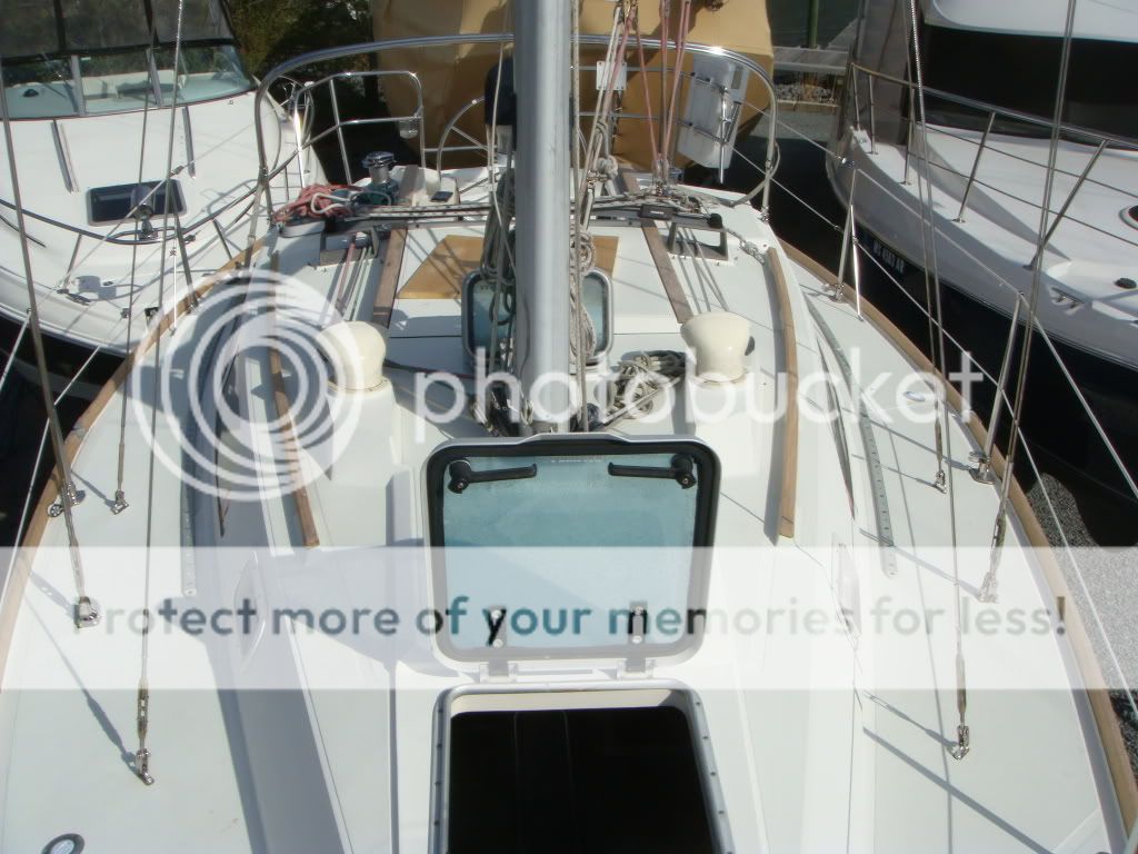

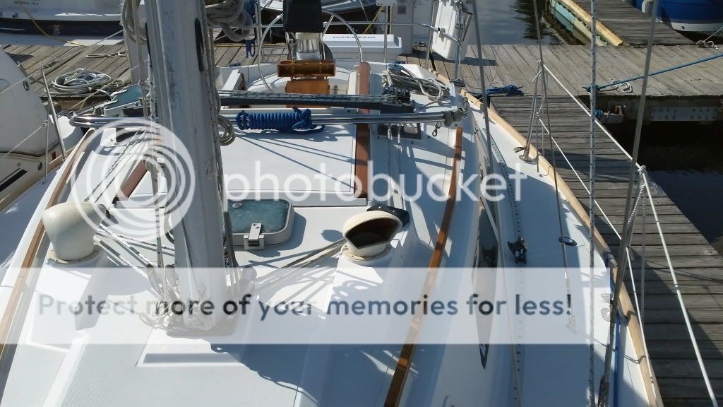

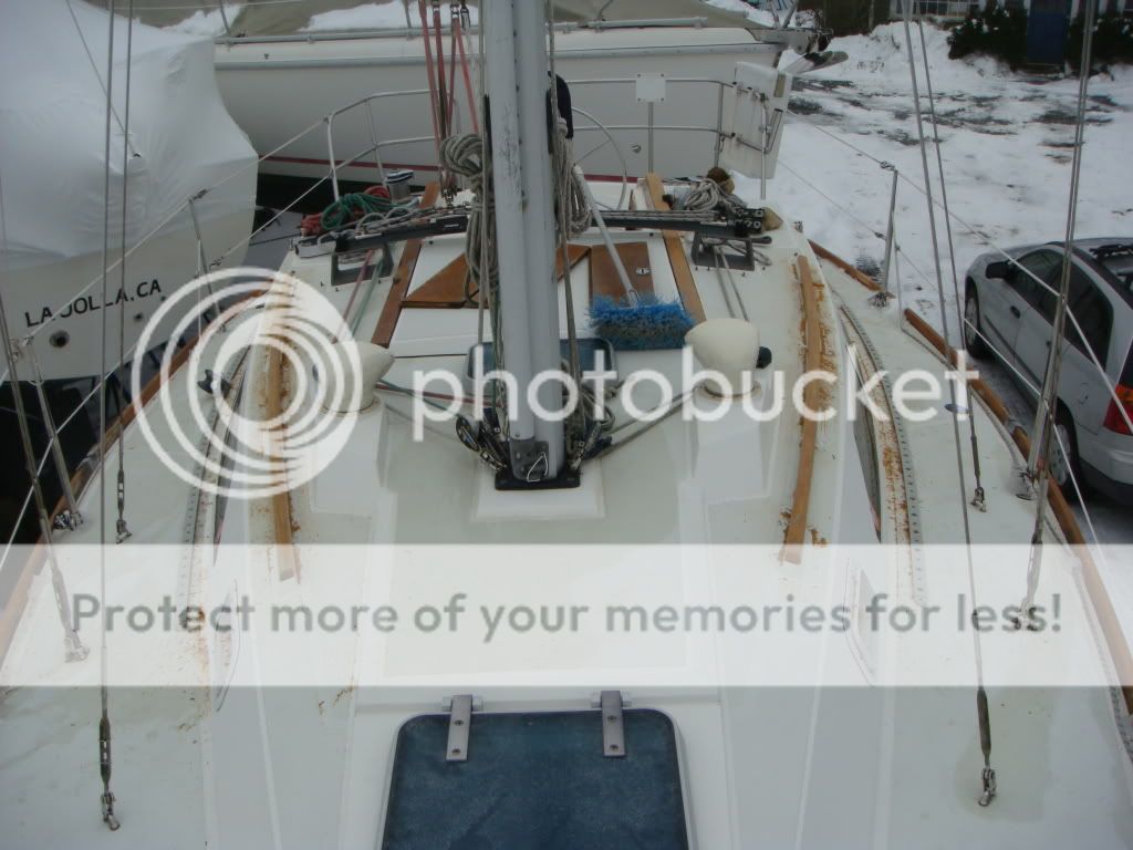

Scraped all our brightwork a couple of seasons ago using a similar method. Used this scraper bought from a local hardware store. Smaller than what's shown in the OP's video, but was great for the size of our hand and toe rails. Several blades are included, used the flat edge ~90% of the time. There's a small file in the handle to hone the edge as you work.
Takes a bit of time, but leaves the stock in good shape and after a light sanding, ready for finish or left alone.

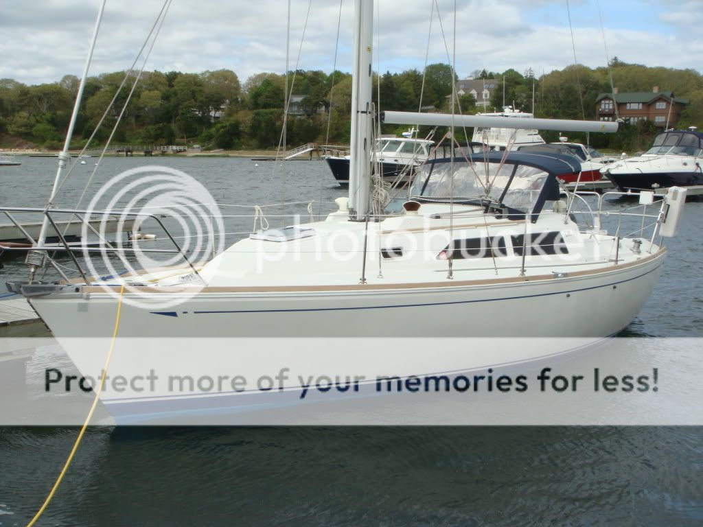

btw...Berner73..Your Cal 28-2 looks so nice.
