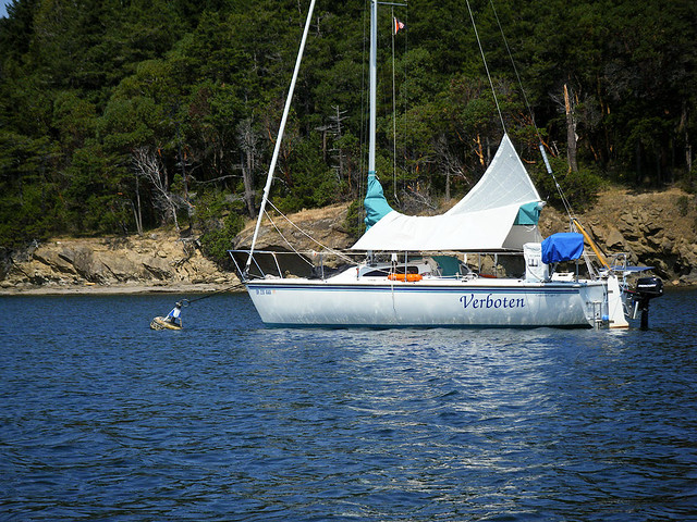

There's no backstay but I bet you could rig an anchor riding sail. I made one for Verboten that ties to the boom, a cleat near the base of the mast, and uses the main halyard for the top.
