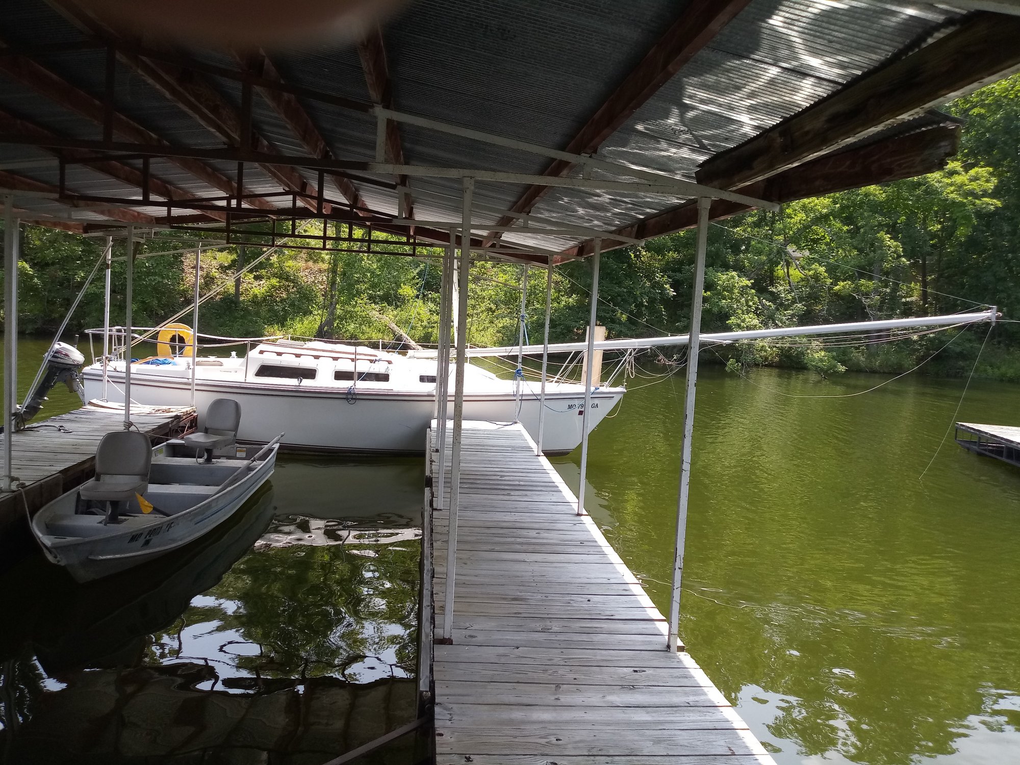

Pulls the rear stay?
Yep... I've found that on that boat, it's easier to start with the mast in the pulpit. One person walks the mast up from the bow to the mast step, the other pulls on the rearstay/backstay to assist. There is more room on the foredeck to handle the mast vs trying to lift it from the cockpit and have someone pull on the forestay. I've also done it this way singlehanded using the mainsheet attached to the backstay , mast on my shoulder and lifting the mast/pulling the sheet at the same time, but you run the risk of the mast going sideways before the shrouds keep it from moving side to side.
Attached is a pic with the mast down to the bow.
I don't know the weight of your capri 19 mast, but I have a starwind 19 and I can simply walk it up from either end of the boat. This is where parking downhill can be to your advantage, especially if rigging it by yourself. Walk it up, let the shrouds and whichever stay is uphill hold it until you can clip the opposite stay in place. On a hill it's past vertical and will hold itself and you have less arc to travel through to get it past vertical and over center. It is using gravity in your favor.
I'm not a big guy. 5'10" 160lbs 40yrs old. Years of working alone have lead to some ingenuity with difficult tasks that normally require 2 or more people.
