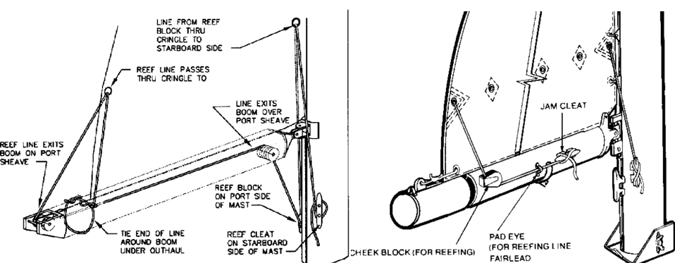

You have described your set up very well but a few photos of the reefing lines and hardware might help. Below are 2 diagrams to assist you in reefing your sails with the hardware you described. While you are waiting for a response from the forum you might contact Capri 18 owners on this link. CatalinaOwners.com Owner Directory (sailboatowners.com)
