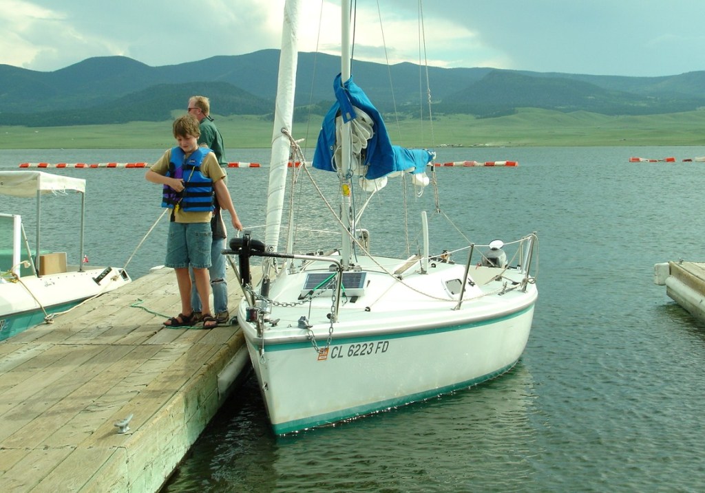

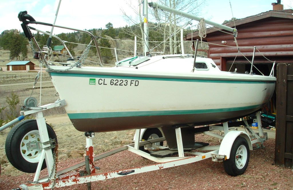

3,550
Same boat? I had a Capri 16 for a while, awesome little boat.. It had one of the CDI furlers (probably FF2??) on it and it was all standard.
