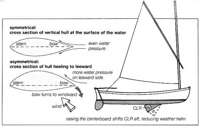

Anyway although never having sailed a Catboat, I understand they have notorious weather helm, and the logic as to why makes sense. I've also read that the way to combat that is to not always sail with the centerboard all the way down. Evidently cranking it up just a bit can reduce helm and doesn't sacrifice much on pointing.Well I'm wondering if the weather helm also applies to the boat I'm looking at, and if so, since there is no centerboard. how do you handle it. Have any of you experienced sailing one of these?
