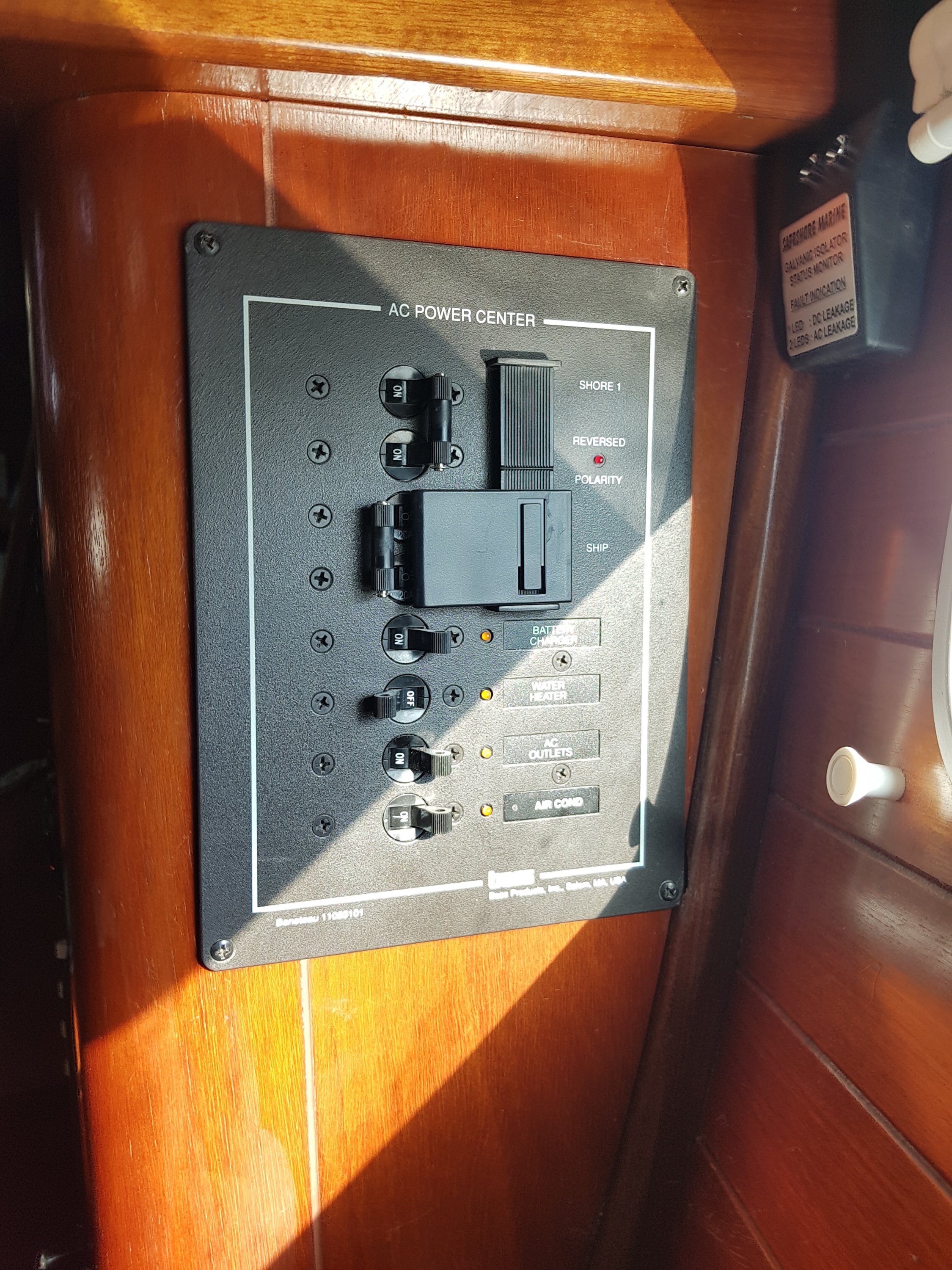

Next step is for you to understand how it works on YOUR particular boat. Your AC Master switch must be ON for it to work, and you must be unplugged/disconnected from shorepower.

I installed one on my boat, as per original beneteau wiring. On the A/C panel there are 2 master switches one is for shore , the other for ship with an interlock bar between them ,so its either one or the other. So I turn on ship, turn on inverter by remote panel at nav table. Now all my a/c outlets are powered up to 20amps pure sine wave, often run Keurig while sailing.Make sure to shut off battery charger breaker & A/C

On mine, the shore power goes through the main breaker at the nav station, then goes to the inverter/charger. It also goes directly to the water heater and refrigerator breakers. AC comes out of the inverter/charger back to the nav station AC Plugs breaker. So the water heater and refrigerator won't run on the inverter. In the inverter, if AC input is available, it is passed through. If the inverter is turned on, and the input voltage is low, the inverter will sinc with the ac and raise the voltage. If there is no input AC and the inverter is on, it checks for a load, and if none goes into standby, if there is a load the inverter produces power. I have a clock/lamp in my stateroom that is able to run on the standby power, but doesn't create enough load to be able kick the invertor out of standby to lite the lamp.
