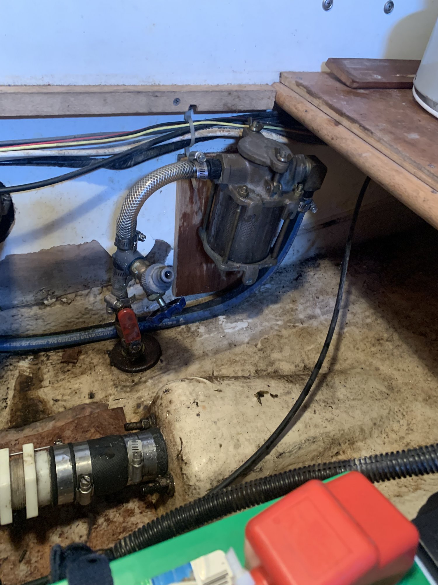

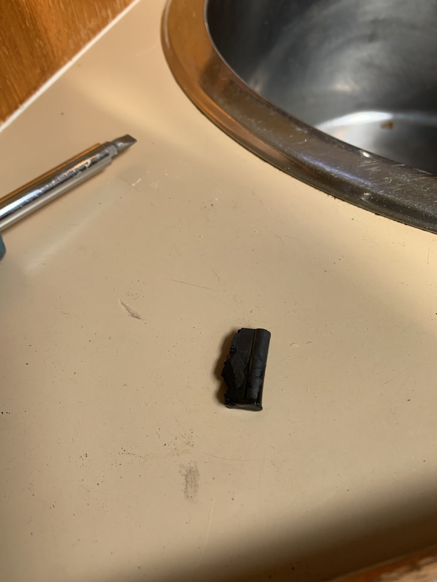

Ok, I found the filter strainer, and the seacock where it comes through the hull. It's under the rear berth floorboards on the port side of the boat. The hose between the seacock and the strainer has an outlet, looks like where a previous owner put a spot to blow the external strainer out without disconnecting anything. I opened that outlet, and water is flowing freely, so that's not it. Then I closed the seacock - visually I can see the water in the strainer (clear sides) and then I started the engine. I expected the engine to suck the remaining water out of the strainer body, but absolutely nothing happened. I then disconnected the intake hose from the engine side, and there was a random piece of rubber stick in the intake side of the pump body. Not *blocking* the intake per se, just kind of partially blocking it. I removed that piece of rubber, and blew out the intake hose from the engine side. Nothing came out of that but water. I reconnected the hose and tried again, but still no suction from the engine. I believe I may have a damaged / non-working pump / busted impeller. Thoughts?

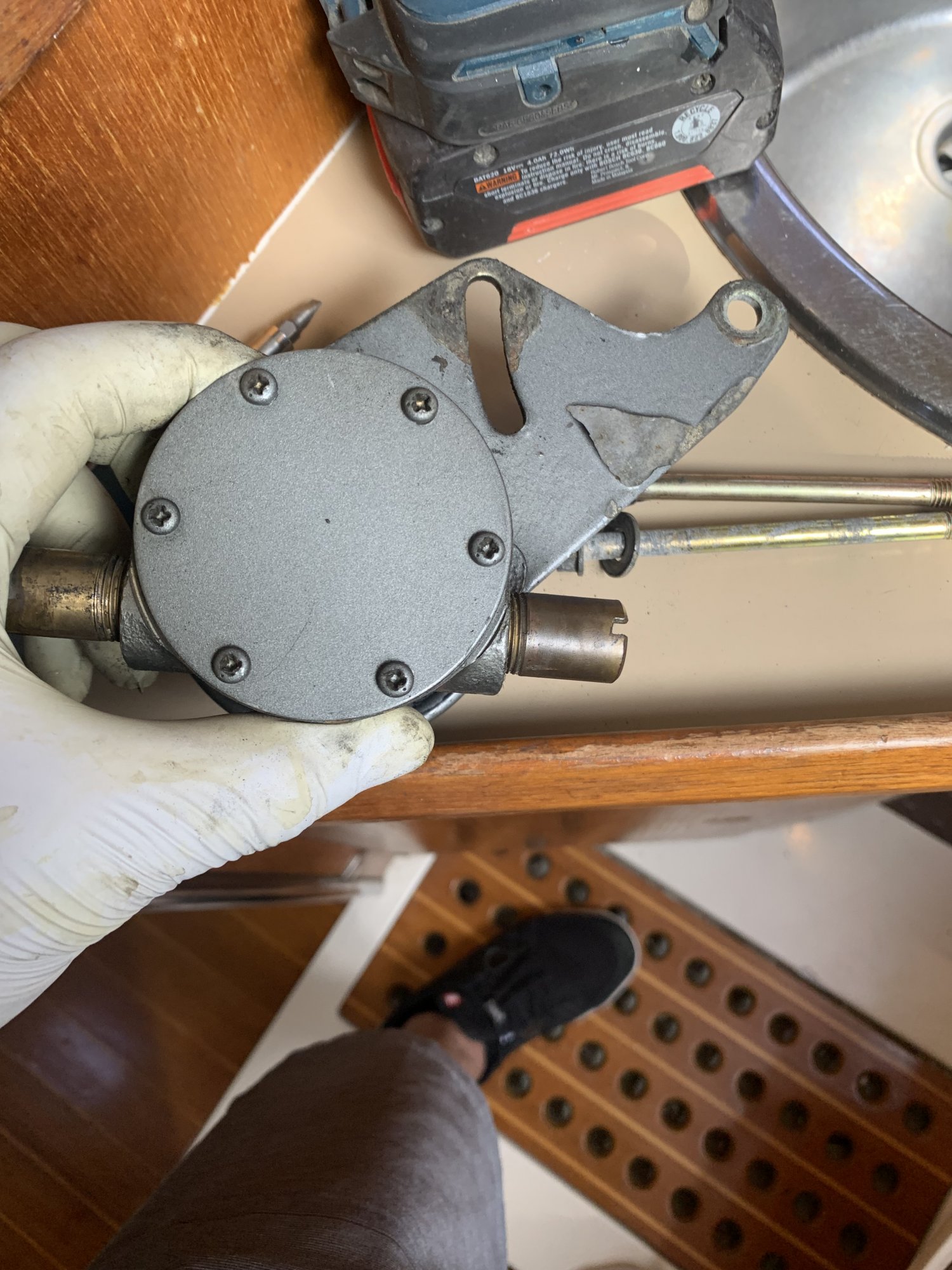

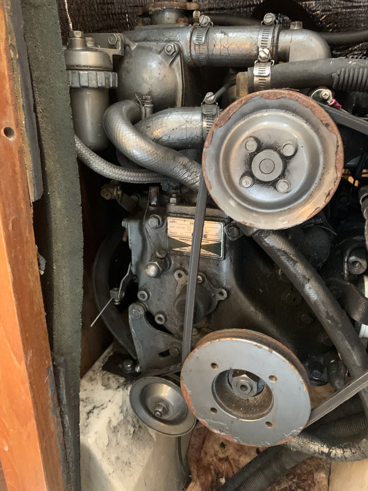

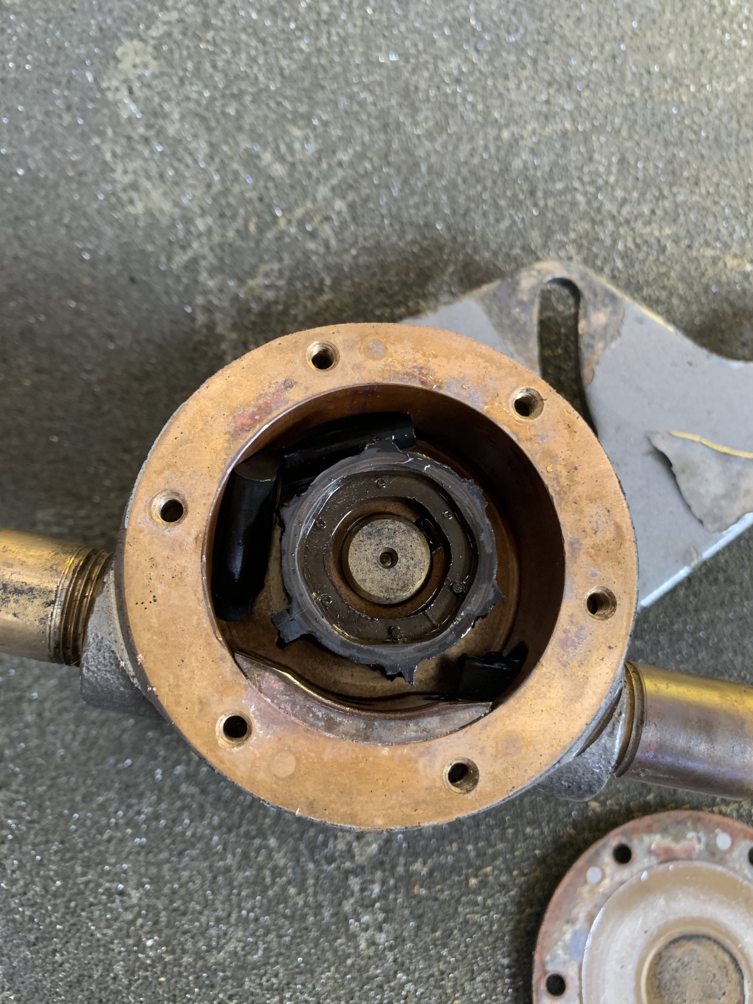

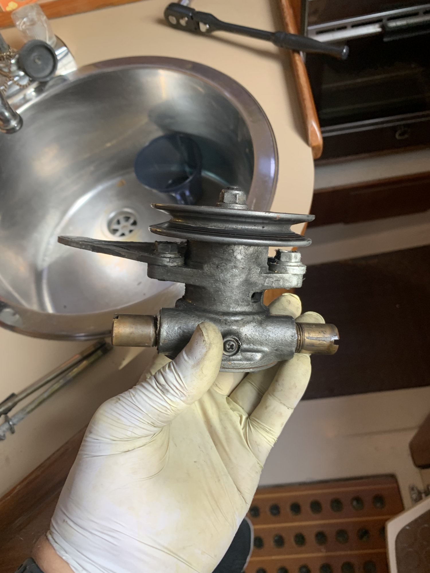

It was the impeller - what I thought was the pump was the exchanger, which explains the rubber on the supply side - that's after the pump :). I've attached some pics of the pump taken off, then apart. The impeller seemed like it hasn't been changed in a long while - it was amazingly hard to pull - I ended up modifying a small gear puller to get it out. Thanks for all your advice on this! Pics are: a piece of impeller I found in the hose, front of the engine, location of the strainer filter and seacock, the pump itself, back of pump, impeller cover, ruined impeller exposed. I'll be picking up a replacement plus gasket tomorrow and re-installing. Should I prime this? or does this type of pump not need it? Edit: Just read the short thread here on priming - I've got less than 6' of hose, so I'll try it unprimed, then prime it if that doesn't work.

I usually put just a little soapy water in the pump housing after installing the impeller, just to give it a little lubrication until the water gets to it. Doesn’t need to be full or anything, just a little coating around the dry rubber. Don’t forget to open the seacock again before you start the engine. If you don’t see water out the exhaust after maybe 15 seconds I would stop and reinvestigate.
Likes: Ward H
Apr 5, 2009
3,202
Wow, that is one sad impeller. I have seen them with 1 or 2 broken vanes but never all of them. As Davidasailor26 said, a bit of dish soap and it should self prime. If it does not you still have a problem somewhere.

There must be a lot of rubber bits in your cooling system looking at that old impeller… make sure you check the hose and HX if you don’t know where all of the pieces are, or if you aren’t getting good flow out the exhaust.
Is that a 2GM20F or similar? The backwards water pump is the same as my 2GM20F. A pain to have to pull the pump to get to the impeller, but necessary.
