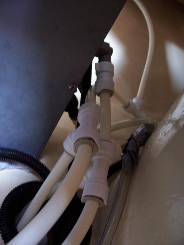

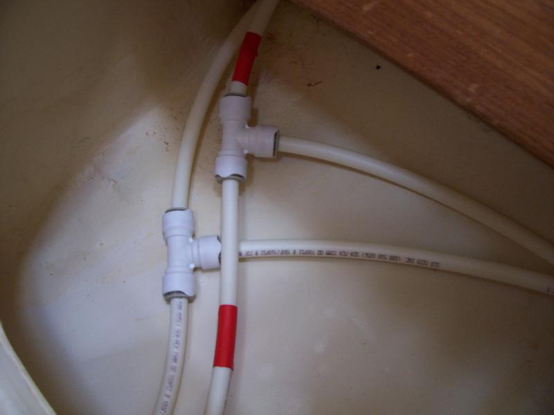

When you can, post some photos of what you can see. Let us know what connector fittings you have as well.
I ask because I have John Guest Fittings on my 340. And each year I have at least one of these connections loosen due to lack of water pressure in the lines. Which leads to a dripping when fill the water tank and send water through the system. It doesn’t happen during the summer as we use the water, but after the winter layover it does in one or two.
It could be I am doing it, when I loosen one when I change over my bypass line to refill the water heater. Its cramped in there so that’s entirely possible, but not every year.
If you blew out your lines well, you should not have that much water left in a line the could freeze. There should be plenty of room for expansion along the entire line.
Just my thoughts, but I actively check each connector by making sure I feel and hear the click when the lines are inserted.
Let us see what you have for connections and start the help you need.
This is what I have:

- Sea Tec/Aqua Lock fittings. No leaks from any that are visible (don't know of any that aren't, but wouldn't be the first surprise ...)
