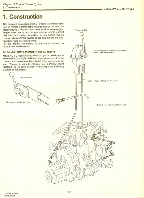

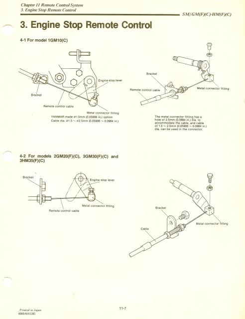

1985 26 oday with yanmar 1gm10. Foward gear is fine idle to full, in reverse idle only. seems to be a marmac shifter mod M 1093 D2. Maybe an adjustment? Did a google search and came up with two posts looking for help also. Any suggestions from the wealth of knowledge here would be great!!
I would replace it with a teleflex CH2100P if need be....and figure out how to remove the old one....
